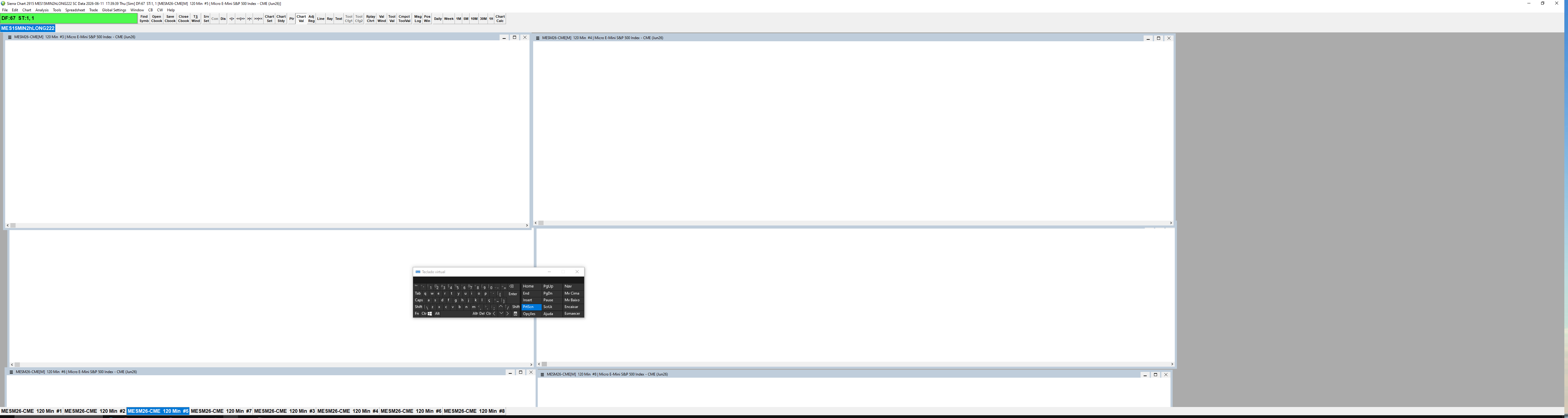

[2026-06-11 20:13:33]
qkzguto - Posts: 31
Hi
My charts are frozen even reconnecting
Private File
[2026-06-11 20:29:04]
The image you provided does not give us enough information for us to be able to determine anything.
To get us an image when you have multiple charts to show within the main Sierra Chart application, select "Edit >> Screen Images >> Save Main Window to File" and then get us that saved file - the Message Log will come up and tell you where the file was saved and the name of the file. Refer to the following:

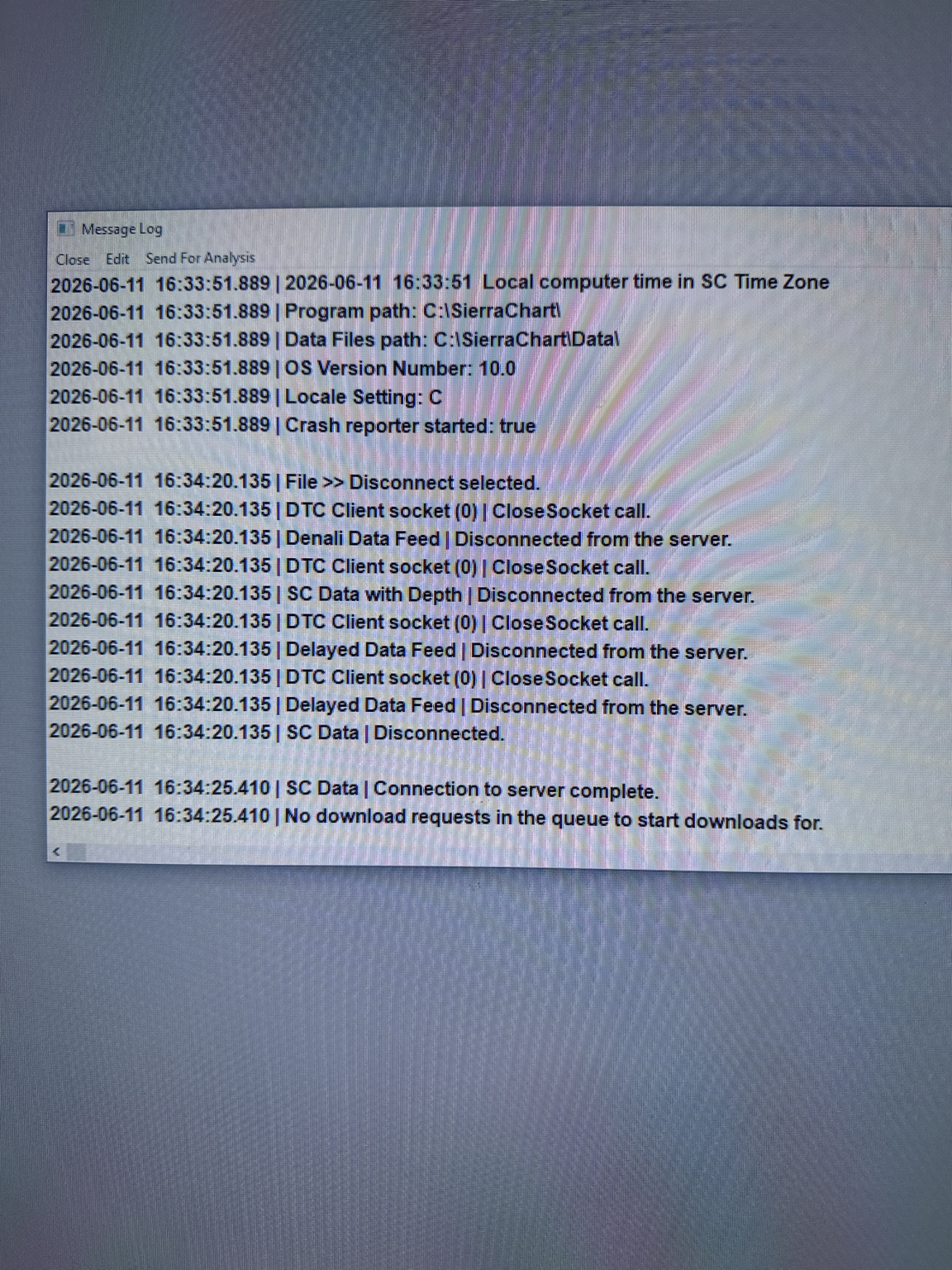

[2026-06-11 20:42:56]
qkzguto - Posts: 31
I followed the instructions, opened a single MESM26-CME chart, cleared the Message Log, disconnected and reconnected the data feed, and sent the Message Log through the Send For Analysis function.
Please let me know if you need any additional information. I SENT THE LOG ALSO IN SEND FOR ANALYSIS
Thank you.
image31CDC361-37F6-4260-B57E-5C1EF2004F7B.png / V - Attached On 2026-06-11 20:42:30 UTC - Size: 3.59 MB - 98 views
[2026-06-11 21:10:16]
There is nothing in the log that shows anything wrong.

[2026-06-11 21:14:08]
qkzguto - Posts: 31
There is
Private File
[2026-06-11 21:24:48]
We need an image by following these instructions:
Do not take a photo. We need the above instructions followed in order to get a proper image.

[2026-06-11 21:56:20]
Please do the following:
- Select "File >> Close All Chartbooks" to close all chartbooks that you have open. Save or not, that is not important to us.
- Select "File >> Find Symbol".
- In the "Selected Symbol" field on the Find Symbol window, enter the following:
MESM26-CME
- Select the button for "Open Intraday Chart".
- Select "CLOSE" to close the "Find Symbol" window.
A new chart will open. If that chart is also blank, then save that chartbook and get it to us by following these instructions:
[2026-06-11 22:17:49]
qkzguto - Posts: 31
Its working thank you 💪🏻🙏
