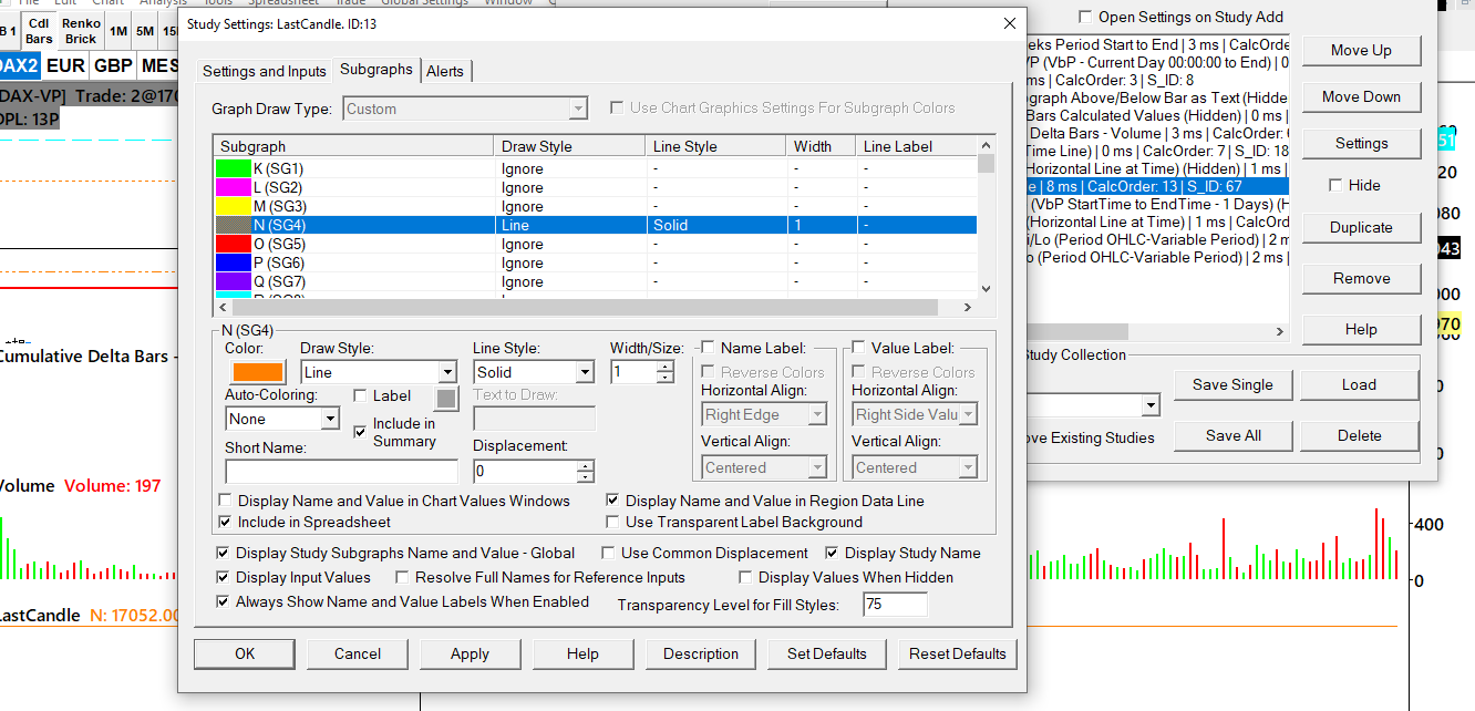

Regarding the Last Candle of the Session/ Day formula - I added the spreadsheet study to the bulk of my studies, the sheet is filled accordingly, the subgraph is there (N) as it is displaying BUT at the bottom of the screen as it was. What am I not understanding? I'd like the line to be on its place and the sheet region at the bottom to disappear.

4. We think you are wanting to move the Spreadsheet display to the main region. To do this, change the region on the Settings page for the Spreadsheet Study. Refer to the following:
Chart Studies: Settings and Inputs Tab >> Chart Region

4. Ok, thank you, It's on the Main Graph at the right level. But it shows only the last day closing and doing it all over the window and on the days back. I'm really struggling here, I'm not a programmer. How should I change the formula to make it show repeatedly the last candle of the previous day, day after day, starting from the level and extending further on, say, until end of period / window/ intersection etc. ?
The formula you gave me was:
- Cell K3: =IF(INT(A3) = TODAY() - 1, A3, 0)
- Cell L3: =IF(K3 <>0, ROW(), 0)
- Cell M3: =MOSTRECENTNONZEROVALUE(L$3:L$3000)
- Cell N3: =INDIRECT(CONCATENATE("E", M3))
- Cell O3: =IF(INT(A3)=TODAY(), N3, 0)

4. You only want to display Column O. Make sure the other columns are not set to display. Refer to the following:
Chart Studies: Ignore (ACSIL: DRAWSTYLE_IGNORE)

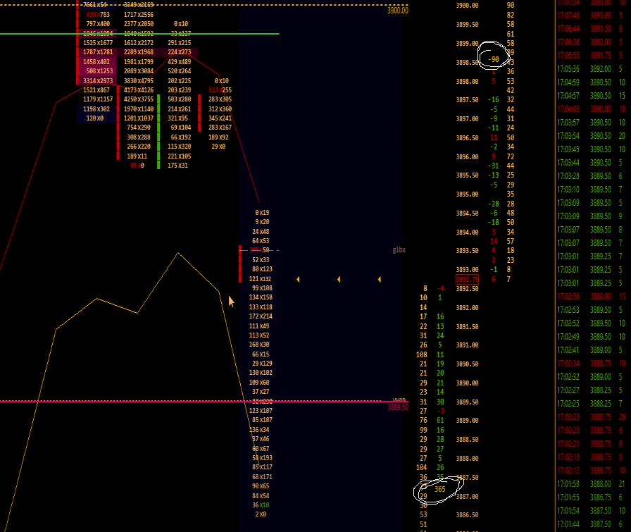

There's so much market depth on DOM that I cannot see the cumulative pulled/stacked orders which I believe it's a number to be found at the top / bottom of the list. I've even set up a vertical 22" monitor for that, it only get's bigger. The decrease in market depth levels doesn't work for that.
I wish there was a way shrink it, isn't there one?
Could i perhaps make it smaller and hop it to the chart itself ?
Date Time Of Last Edit: 2024-04-16 11:16:16
[2024-04-16 15:33:45]
John - SC Support - Posts: 48520
One option for this would be to have a separate chart and set the scale to be very wide so you can see the top/bottom of the Pulling/Stacking and view the Pulling/Stacking Sums.
Another option would be to create a custom study to get to that information. Refer to the following:
ACSIL Interface Members - Functions: sc.GetBidMarketDepthStackPullSum()
And finally, another option is to change to Package 11 and use the "Numbers Bars Calculated Values 2" study, as this has subgraphs specifically for the Bid/Ask Sum of Pulling Stacking. Refer to the following:
Numbers Bars: Numbers Bars Calculated Values 2 Subgraph Descriptions

What do we mean by setting the scale ? I use Chart Settings for DOM , [scale] > [scale] , constant range, scale : 100 and still - I can barely see anything and market depth is still more than 40 orders (how many more?) so no sums anyway.
Since the sum of the Pulling/Stacking is at the top/bottom of the lists, we are suggesting setting the scale such that you can view these values. This is why we suggest a different chart, one that you can just have the scale set in a way that you can view the values.
Any other parameters I can fiddle with ?
No.

1. Again, I still don't get what you mean by a ,,different chart''. My DOM chart is attached below.
2. I meant just scrolling the DOM up and down. This seems to scroll itself with the orders, I understand I can only reset it for the price to be in the middle. Why can't I just go up and down at will?
2.Here's an example of the pull/stack being visible on the Sierra's chart.

1. The premise of this thread is that you can not view the Pulling/Stacking Sums because they are at the very top and bottom of the range of data for the Pulling/Stacking columns.
We are suggesting to open a new chart (or Trading DOM) and have the Pulling/Stacking setup there as on your main Trading DOM and then set the scale so you can see the Pulling/Stacking sums. This way you can have a view of that information without having to scroll up/down on your main Trading DOM.
2. You can move the DOM scale up/down as you like. You are not restricted in this at all. There is not an option to use the Scroll Wheel for this, but you can grab the prices and when you have the scale set to "Interactive Scale Move" it will move up/down with the pointer. Refer to the following:

1.,,We are suggesting to open a new chart (or Trading DOM) and have the Pulling/Stacking setup there as on your main Trading DOM and then set the scale so you can see the Pulling/Stacking sums. This way you can have a view of that information without having to scroll up/down on your main Trading DOM.''
I've been using Sierra for the last few months, feel pretty comfortable with its functionalities and still do not understand what should I do.
I can open DOM via 1.Find Symbol 2. Open DOM for chart 3.Open Trading DOM.
Whichever I use I land with a separate or attached window of a special kind, different from a chart obviously. I do not see where would I scale it like I do so with regular charts.
2. Thank you , the problem was that I mostly use touchpad which does not support scrolling, neither the dom supports page up /page down in this repect. Now that I use mouse I can scroll it to see the pull/stack but the issue remains. The sums are ca. 50 price levels away on FDAX.
Can you refer to the image of the dom on the chart as per the attachment?

UnleashedPiglet - Posts: 67
1. I will be forced to use Tradovate account, as I'm only interested in DAX futures at the moment. Rithmic does not provide it as far as i know. And they told me I will need to purchase the EUREX data from them with the evaluation account (?).
2. Thanks. Works like a charm.
3. I meant a full bracket order by one keyboard shortcut - market buy/sell with adequate stops and limits attached. Alternatively also a buy/sell stop/limit bracket order at pointer.
4. Does Market Depth Graph( Heatmap ) works with delayed data when I subscribe to Package 12 ?
5. Can you please let me know what's called the info bar above the chart and how I can customize it? I've never been able to find it out (ss attached).
Date Time Of Last Edit: 2024-06-03 11:26:27
1. You can not use Tradeovate with Sierra Chart, they do not support it.
Also, you need to get the EUREX data from us, as we do not have support for EUREX from other vendors. Follow these instructions to setup our EUREX data:
Denali Exchange Data Feed: *Setup Instructions: All Other Exchanges*
3. To do this you would use the Keyboard Shortcut for a Market Order and have the option for "Use Attached Orders" enabled. Refer to the following:
Basic Trading and the Trade Window: Main/C >> Use Attached Orders
4. Yes, as long as you are getting the Market Depth data for the instrument. Some have it and some do not.
5. That is the "Chart Header". Refer to the following:
Global Settings Menu: Customize Chart Header - Standard (Global Settings menu)
1. That's by far the worst news I heard this year. SO I am virtually UNABLE to evaluate with APEX on EUREX futures with you ? There's NO workaround other than pay for SC, pay for EUREX and then also use Tradovate platform to execute paying additionally for another EUREX data ? Alternatively would you have a suggestion which funding prop firm would be compatible both with SC and EUREX ? (For instance I'm hearing The Trading Pit has Rhitmic and dxFeeds for EUREX with the account, is it possible to connect their account to Sierra to use the EUREX data feed this way? Or any other provider for that matter...Topstep?)
3.,5. Thanks.
4. I get some messy stuff on delayed EUREX, sometimes there's no connection, sometimes it's stuck, for the most part it works fine but gives only 20 levels while there's more on the book ... Can it be better when on paid data ?
Date Time Of Last Edit: 2024-06-06 08:47:15
