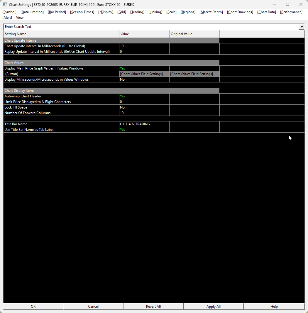

As a next step, I have taken things further and opened a completely separate Sierra Chart instance dedicated only to execution. This instance now contains just two DOMs, one for DAX and one for FESX, and no regular charts at all.
At this point there are no remaining charts that could create cross-chart references. In this DOM-only instance I have:
Removed all invalid and legacy symbols
Cleaned up and eliminated all DLL related issues
Eliminated all cross-chart references (there are only the two DOM charts)
Disabled chart drawings, study collections, and chart linking
Reduced market depth levels and internal depth calculation scope
Minimized historical data loading and trade statistics
Disabled anything not strictly required for DOM execution
I have attached the current message log for reference. From what I can see, it is now clean.
Despite this very minimal setup, I am unfortunately still seeing a small but noticeable lag on the DOM. It mainly occurs when offers are lifted or bids are hit. Occasionally it takes a second or two, sometimes slightly longer, for those hits and lifts to visually update.
I am confident this reflects a data delay rather than just rendering, as I am running a NinjaTrader SuperDOM alongside Sierra Chart on the same machine and can observe the difference in responsiveness during aggressive buying or selling.
I am not complaining and understand there are multiple factors involved, including the data feed and trading service. At this point I am simply trying to confirm whether there is anything else on the Sierra Chart side that could still be checked or adjusted, or whether this behavior is within what would be expected given such a minimal, isolated setup.
Thanks again for the continued help and for taking the time to review this.

[2026-01-16 09:28:03]
User197029 - Posts: 73
Unfortunately, this did not resolve the issue and the behavior is still occurring.
I have attached my current settings for reference. At this point, I am not sure what else can reasonably be adjusted on my side.
Given that the issue affects all EUREX instruments simultaneously and does not generate any log warnings, is it possible this could be related to the EUREX market data feed itself?
Thanks again for taking a look.
imageChart settings DOM (Display).png / V - Attached On 2026-01-16 09:26:26 UTC - Size: 34.79 KB - 205 views
imageGeneral Settings (General).png / V - Attached On 2026-01-16 09:26:43 UTC - Size: 38.74 KB - 188 views
[2026-01-16 15:01:36]
Sierra_Chart Engineering - Posts: 25297
We should have checked this ourselves. We do notice this ourselves. We are not sure of the cause right now, but we are looking into the issue now.
Normally the EUREX data feed works very well. So this is unusual.
Date Time Of Last Edit: 2026-01-16 15:01:49
[2026-01-16 15:34:38]
This issue will be resolved, after the close today. There is nothing we can do now because we are not able to restart the EUREX data feed while it is operational and processing data. Since it is an order by order data feed.
Date Time Of Last Edit: 2026-01-16 15:34:50
[2026-01-16 16:11:22]
We restarted one of our EUREX EOBI data feed processes. We want you to select File >> Reconnect 1 to 3 times, and each time wait about a minute and see if the problem is resolved. Once you connect to the server, where the issue is resolved just do not reconnect again.
You may notice some unusual market depth issues for a period of time but those gradually will clear up and will be fine, Monday.
