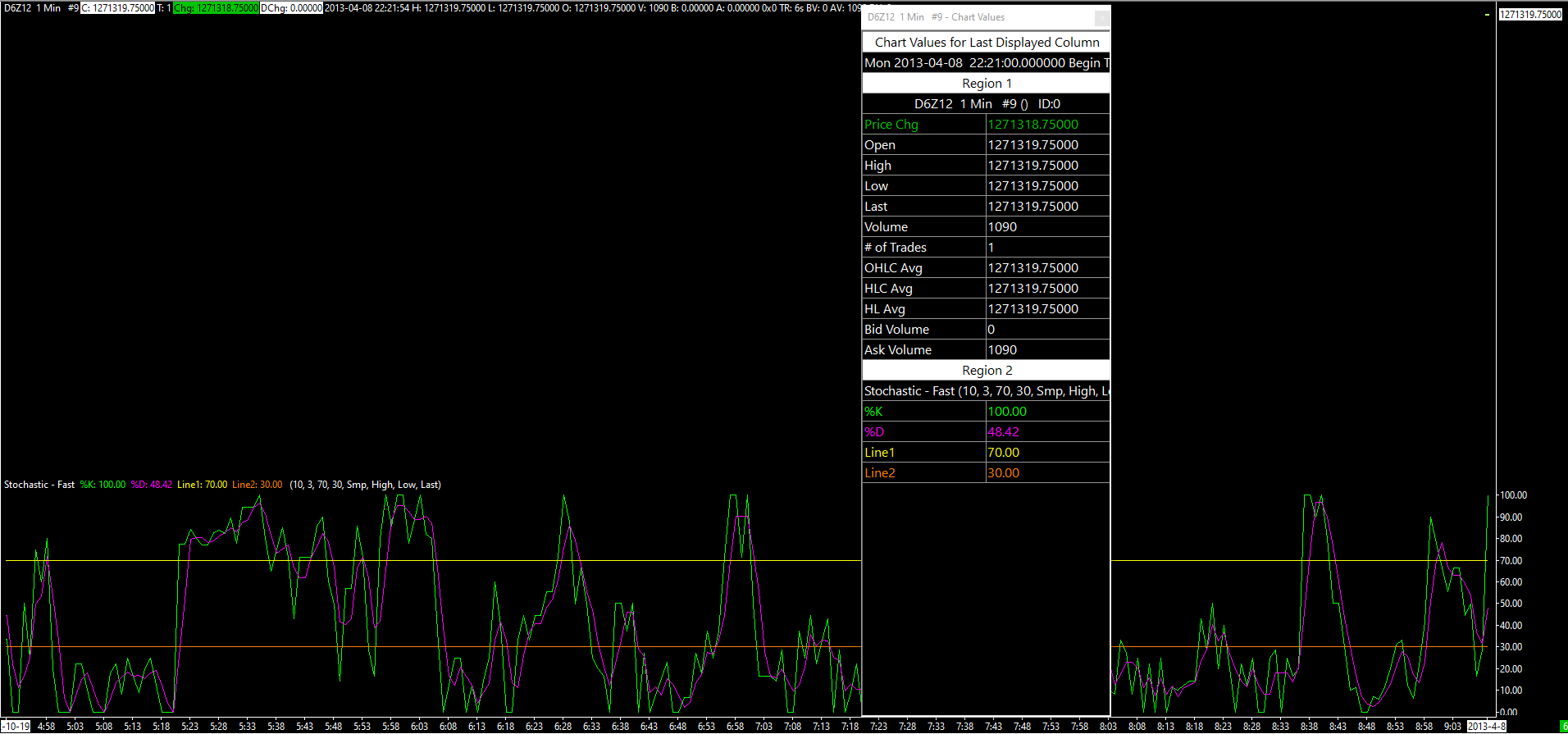

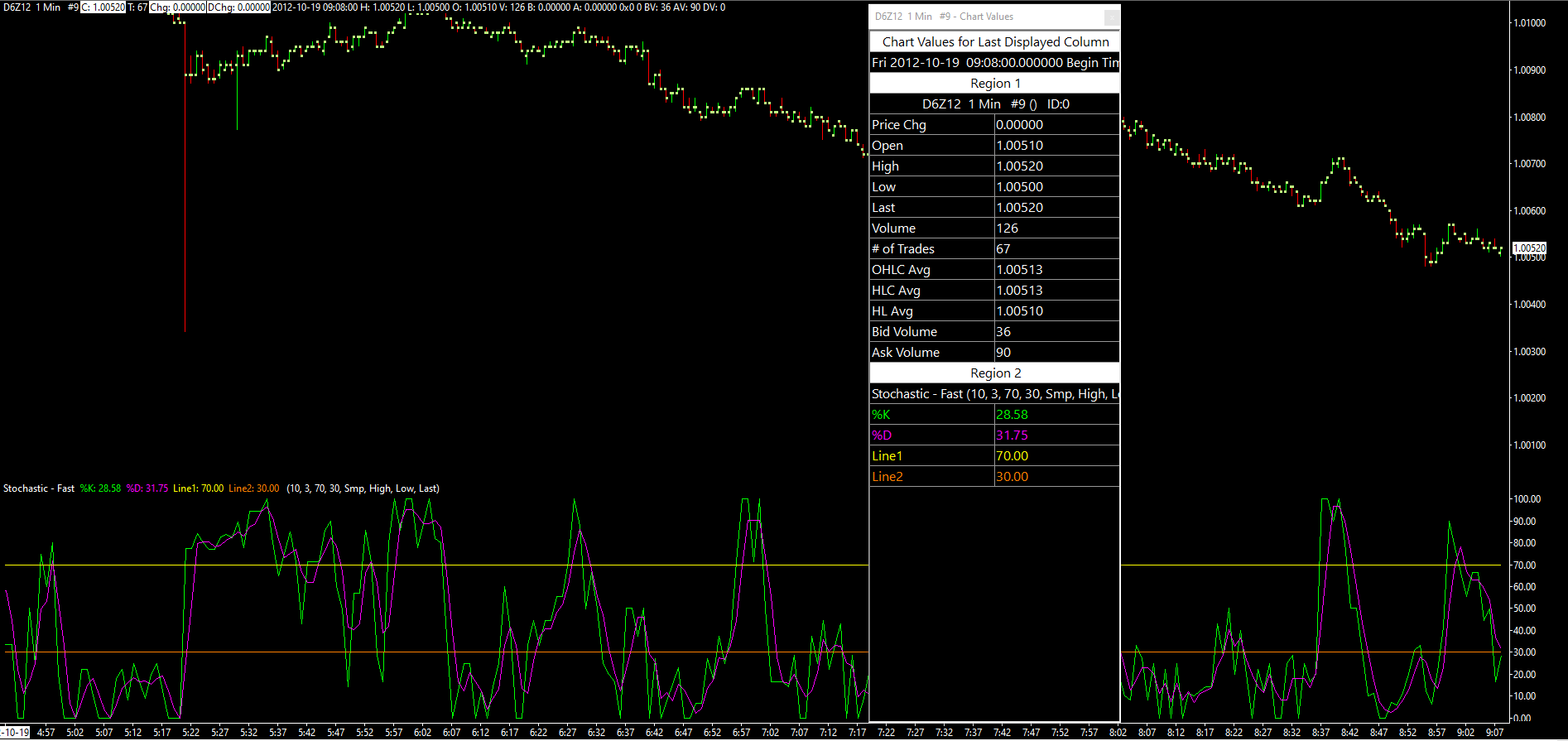

In Intraday charts for D6Z12 the time jumps from 2012-Oct-19 at 9:08am to 2013-Apr-08 at 22:21pm. I tested it and it happens in 7 different time periods in Intraday charts.
Kindly advise. Thank you.

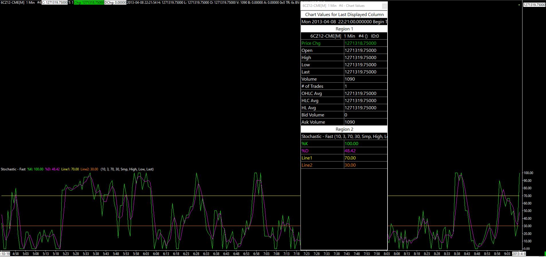

PeaceFrog - Posts: 122
The exact symbol I am using is D6Z12.
The D6Z12 symbol came from Sierra Chart somehow. I think that the symbols converted when I changed from CQG Data feed to Denali last night and that’s what I ended up with. During the day today the symbols I’ve been using have been changing back and forth between “D6XYY” and “CA6XYY-CME[M]”.
Anyway, here are a two photos with D6Z12 that demonstrate the issue.
On your advice I also opened the contract through File >> Find Symbol and posted one photo as well (I reached the attachment limit so couldn't send the first photo but it looks the same as D6Z12-1.png). They look identical to me.
imageD6V12-1.PNG / V - Attached On 2022-02-08 07:16:16 UTC - Size: 90.48 KB - 264 views
imageD6Z12-2.PNG / V - Attached On 2022-02-08 07:16:21 UTC - Size: 83.31 KB - 271 views
image6CZ12-2.PNG / V - Attached On 2022-02-08 07:20:26 UTC - Size: 83.57 KB - 248 views

[2022-02-08 19:02:58]
The correct symbol to use is: 6CZ12-CME
Make sure your symbol settings are up-to-date.
We have corrected the data for that symbol.
Re-download all the data in the chart by going to the chart and selecting "Edit >> Delete All Data and Download". You just need to do this once per symbol and not for each chart.

Thank you again John. We’re making progress!
[2022-02-09 22:43:44]
With regards to the data you are looking for, we just do not have it that far back for that symbol. And it sounds like it might be a bit spotty around 2011 as well. There is nothing else we can do about this, we do have data that can go back to 2008 for some symbols, but not for all.
We also want to make sure you are aware of the Continuous Futures Contract option rather than having to load each individual contract. Refer to the information here:
Continuous Futures Contract Charts
9. The data will not change unless there was some kind of major issue, which you would know about.
Keep in mind, we were talking about deleting the data and reloading it just because you probably have a mix of CQG and Denali data in your charts right now. So, if you are getting your data properly at this point and there is nothing else that we need to deal with, then it would be a good time to go through your charts and select Edit >> Delete All Data and Download, once for each symbol, you do not need to do it for every chart. This will ensure that all your data is then from the Denali Exchange Data Feed.
[2022-02-10 00:34:48]
Hi John,
That’s really disappointing and frustrating. The whole purpose of switching over to Denali, and what we’ve been working on for the last 2 days, was to be able to get that data, per my Support Message “Error Downloading Historical Intraday Data” on [2022-02-06 21:30:23]. The Sierra Chart Engineer who responded said I couldn’t get that data because I was using CQG Data and that I could get it if I used Denali:
“You are not using Sierra Chart provided data. You are using CQG data and we do not provide technical support for that data. And CQG does not have the data that you require.
If you require real-time and historical data in the same installation of Sierra Chart you need to use the Denali Exchange Data Feed:
Denali Exchange Data Feed”
Support Message “Error Downloading Historical Intraday Data”, post #2 at [2022-02-07 14:55:56]
And now you’re telling me Sierra Chart and the Denali data doesn’t have that data, so, I'm left asking myself, what was the point of all this?
Is there any way of getting more historical data?
On another note, now that I have Denali, I’ve done an "Edit >> Delete All Data and Download" on chartbooks where I found discrepancies in the data that I asked Sierra Chart for help reconciling in my previous Support Message “Historical Data Discrepancy” on [2021-11-03 15:01:41], to which the Engineer ultimately replied “We are not going to spend any time on this at all. We do not support CQG data and that policy is firm. You must use the Denali exchange data feed for data:
We will not say anything further regarding CQG data.
You need to use our data feed.”, post #5 at [2021-11-09 22:45:41],
and now I have found that those discrepancies are also in the Denali Data. I guess now that I'm using Denali the Engineer can investigate them.
Thanks John. You've been great through this process. I was expecting to get more historical data and discrepancy-free data though.
[2022-02-10 14:36:47]
First CQG, only provides data for the current contract. This is going to be March 2022! And we are giving you data going back about 10 years through our Sierra Chart Historical Data Service. So you need data even further back. You are looking for data back to 2008. We will get that data and add it.
Please do not post further. We have too much information here. You are writing way too much. This thread is locked. We will add the data today or tomorrow.
And regardless of what was said previously, you should be using SC Data-All Services, and using the proper symbology instead of using CQG and these nonsense CQG symbols.
Date Time Of Last Edit: 2022-02-10 15:02:06
[2022-02-10 15:10:37]
We have added data for CME 6C futures back to March 2008.
You can now download this data.
