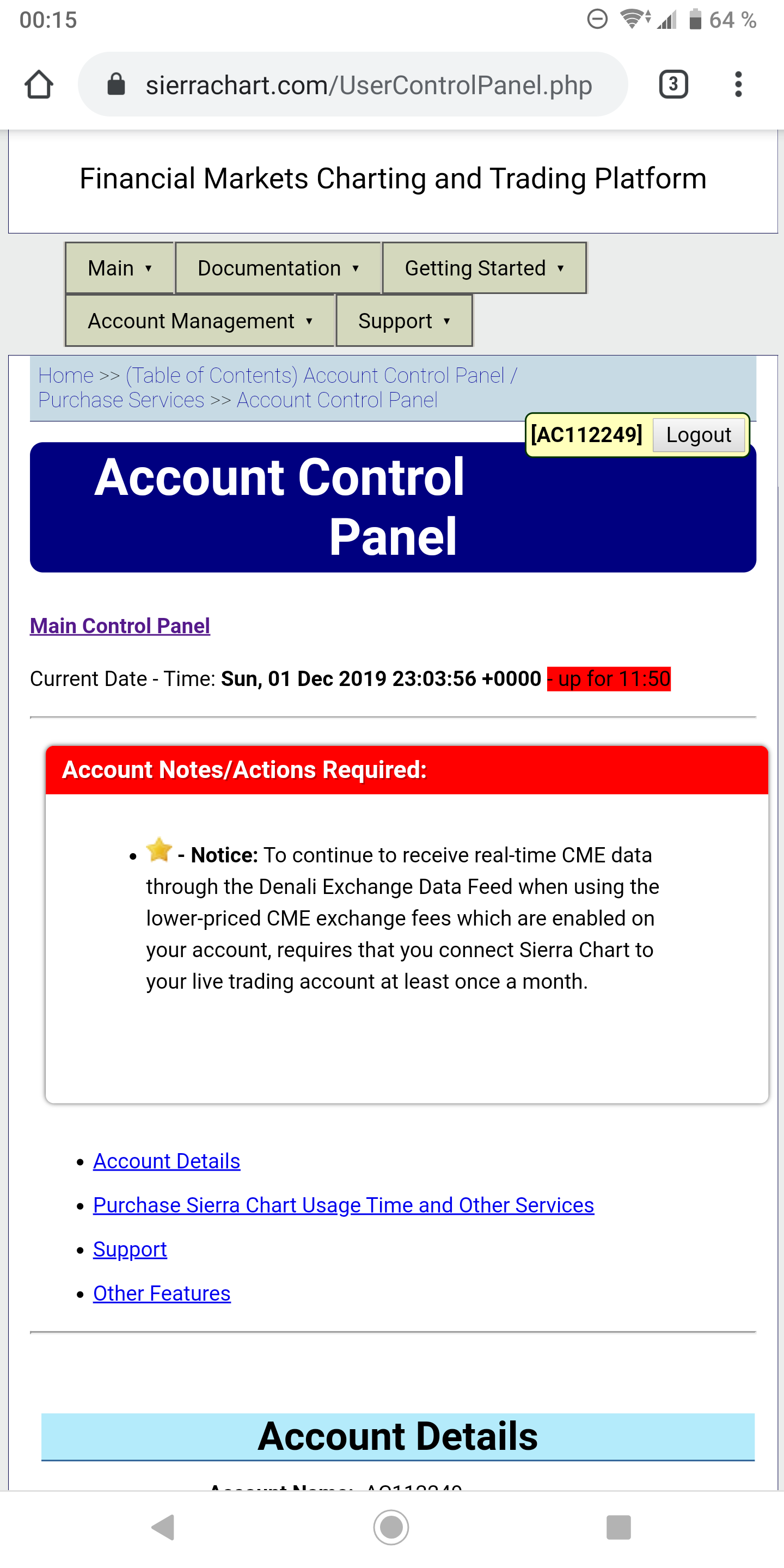

[2019-12-01 23:27:30]
User912279 - Posts: 102
My Denali feed doesn't work now on the 1st December. I have been logged in with Sierra for many hours, and still the Control Panel say I should connect to my Trading Account to get the Data.
Please also see our correspondence above in this thread from the 2nd November.
Please see screenshot attached.
Can you please fix this and explain ASAP?
Date Time Of Last Edit: 2019-12-01 23:32:42
imageScreenshot_20191202-001552.png / V - Attached On 2019-12-01 23:27:07 UTC - Size: 295.04 KB - 418 views
[2019-12-02 04:41:38]
Within Sierra Chart what is Global Settings >> Data/Trade Service Settings >> Service set to?
Do you have a funded trading account with AMP? Is this set up through Rithmic or CQG or what?

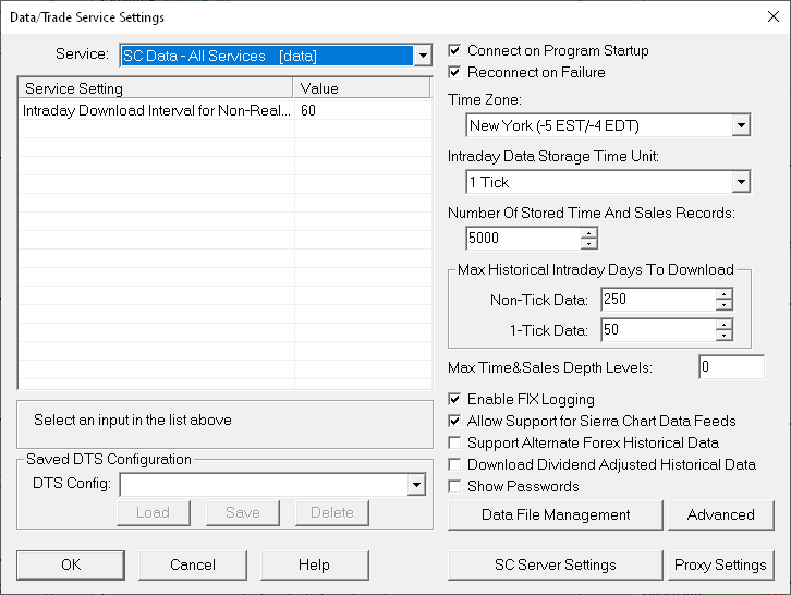

[2019-12-02 10:20:24]
Denali. See picture attached.
My AMP account always served the purpose of having a Data Feed (as described in our correspondence above see November 2nd). It's current balance is $75, which is to be used for paying for Sierra Package 5, as also discussed in the correspondence above. My trading account is as before with Interactive Brokers (see correspondence above).
Are you saying now that thus my Denali feed won't work?
Date Time Of Last Edit: 2019-12-02 10:40:57
imageData-Trade-Settings.png / V - Attached On 2019-12-02 10:19:43 UTC - Size: 21.72 KB - 421 views
[2019-12-02 12:57:10]
Despite all the preparation thru October the 1st November I did not have any data feed all thru that day, which turned out to be a very active day I had to miss.
I would like to avoid the same happening now with the start of December.
Now there is only an hour left till market open.
Can you activate the feed please?
[2019-12-02 13:04:31]
The problem is you are using a Sierra Chart account through AMP but then you say you have a live funded account through Interactive Brokers but the Sierra Chart account you have cannot connect to Interactive Brokers.
So you do not have an account set up through either CQG, Rithmic or the Sierra Chart order routing service? But even in these cases, that account needs to be through AMP.
You have to connect to a live account to authorize CME data as explained here:
Real-Time Exchange Data Feeds Available From Sierra Chart: Understanding and Accessing Data From the CME, CBOT, NYMEX, COMEX Exchanges
The only way we can solve this is to remove your Sierra Chart account association from AMP. And then you have to connect it to Interactive Brokers. But then you need to start paying for it directly after December.
Date Time Of Last Edit: 2019-12-02 13:06:35
[2019-12-02 13:25:30]
So, can I pay for my Sierra account thru Interactive Brokers?
Can you initiate these steps so that I have data connection as soon as possible please.
[2019-12-02 13:29:32]
No you cannot pay for Sierra Chart through Interactive Brokers. You need to contact AMP now and tell them that you do not want to pay for Sierra Chart through them. This is essential otherwise you are going to continue to get billed. And you have to start paying next month for Sierra Chart directly.
We have removed your Sierra Chart account from being associated with AMP. You now need to connect it to Interactive Brokers as explained here:
Real-Time Exchange Data Feeds Available From Sierra Chart: Connecting Only Once a Month to Trading Account to Support CME Group Exchange Fees (Connecting Only Once a Month to Trading Account to Support CME Group Exchange Fees)
Date Time Of Last Edit: 2019-12-02 13:30:01
