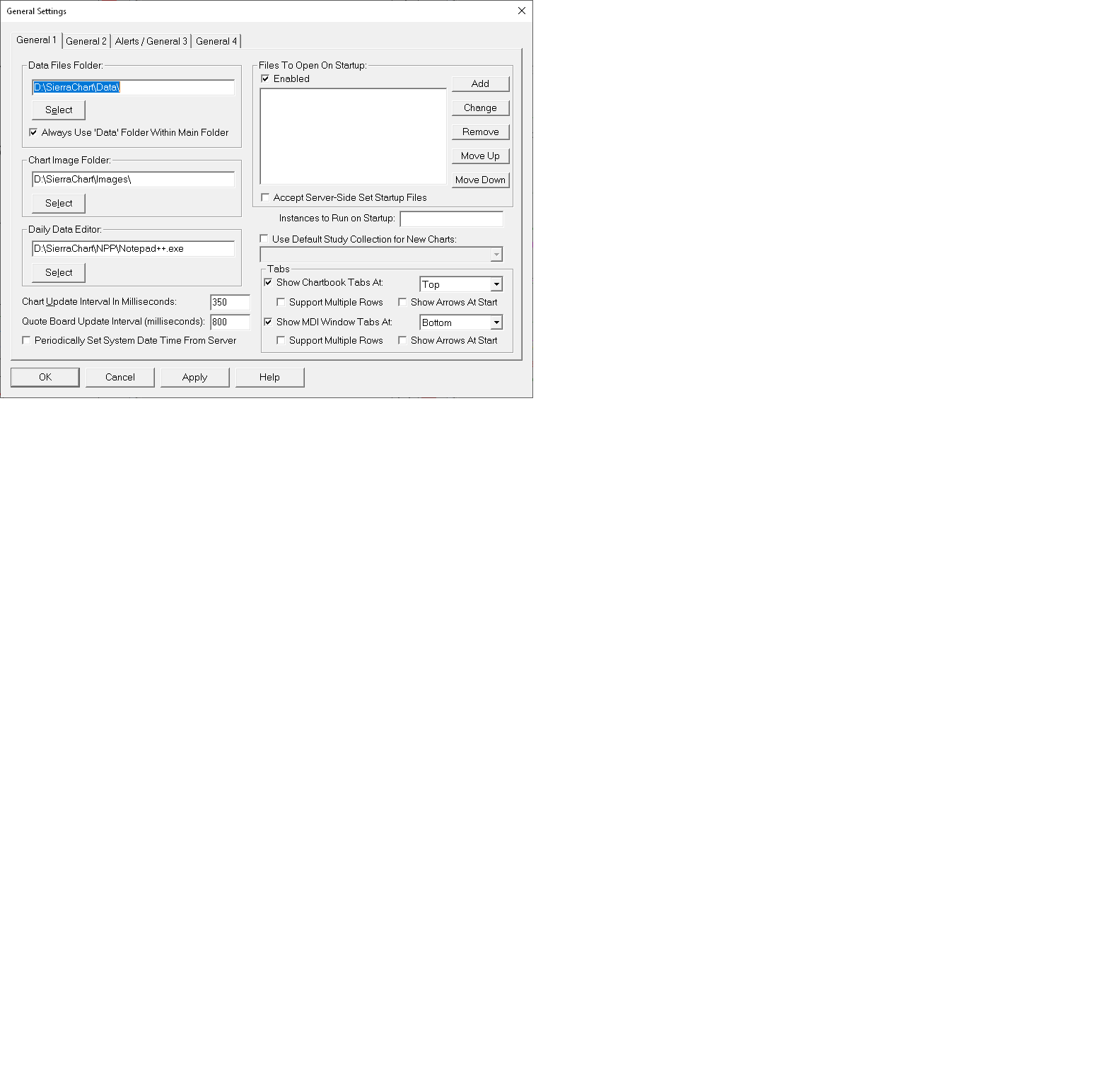

My Sierra invariably lags 10 sometimes 30 seconds behind market (as I see at my independent broker), whenever there is a sudden market move. I have increased my Chart Update Interval to 350 ms, but to no avail (see screen shot). I have 32 GB RAM (not that Sierra uses more than 10 pct of it!) and my processor also only used about a third of its capacity.
My data feed comes from AMP/Rithmic, but I cannot see such lag on the Rithmic Trader Application, so that leaves my Sierra.
Could you help please.
Thank you.

[2019-10-11 14:49:44]
Refer to this help topic:
Prices / Data Falling Behind
Consider using this data feed instead:
Denali Exchange Data Feed
And possibly this order routing service:
Sierra Chart Order Routing Service
We definitely do hear about lagging issues when using Rithmic.
