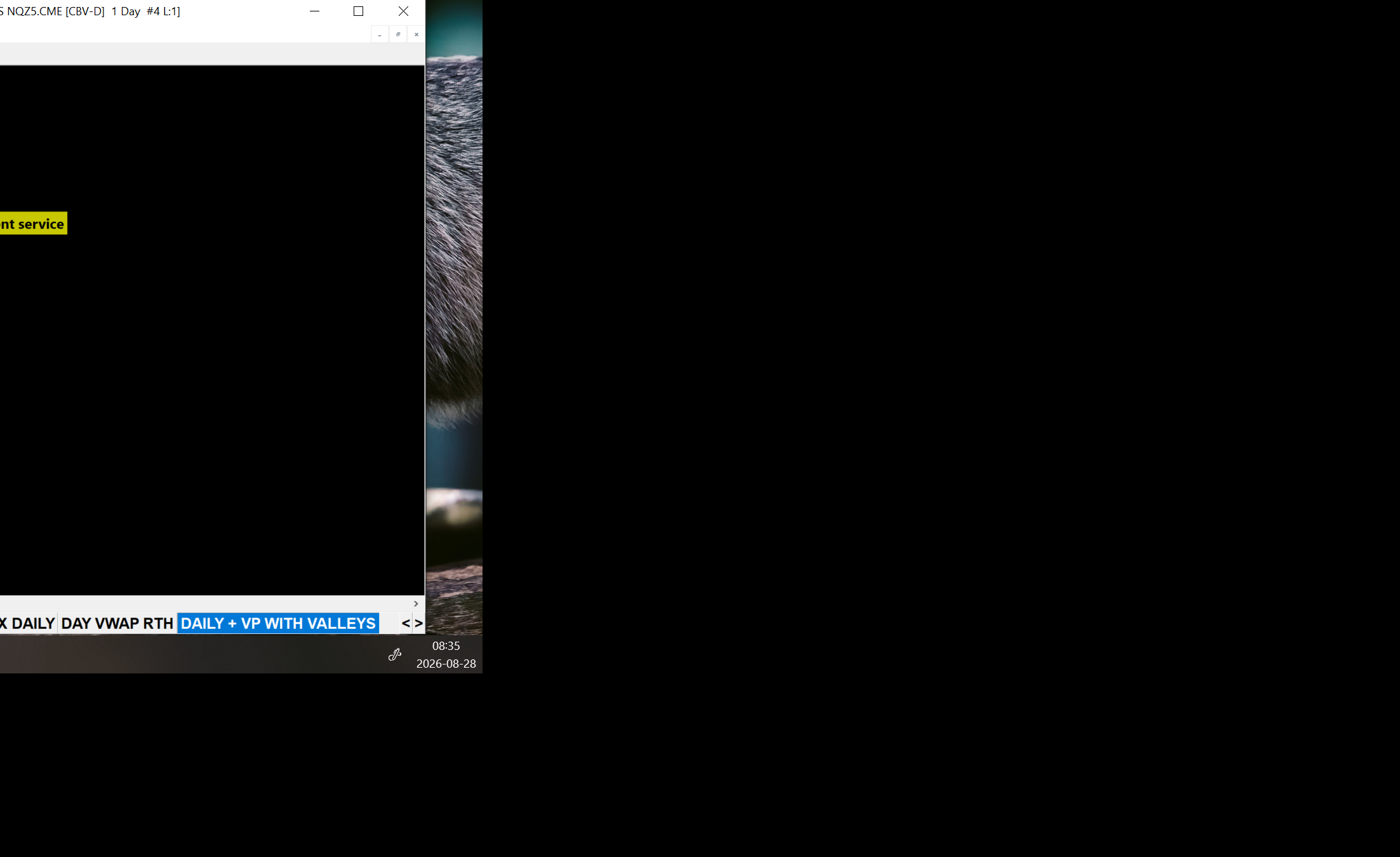

| User740755 - Posts: 25 |
https://www.sierrachart.com/image.php?Image=1788007610510.png bonjours, je vient de prendre une capture d'écran. Comment en fait pour reconnecté la page. merci |
| [2026-08-31 13:49:58] |
| John - SC Support - Posts: 48660 |
Is this just an issue with one chart or with all your charts? What is the symbol of that chart as it entered in "Chart >> Chart Settings >> Symbol >> Symbol"? What is "Global Settings >> Data/Trade Service Settings >> Main Settings >> Current Selected Service" set to? For the most reliable, advanced, and zero cost futures order routing, use the Teton service: Sierra Chart Teton Futures Order Routing |

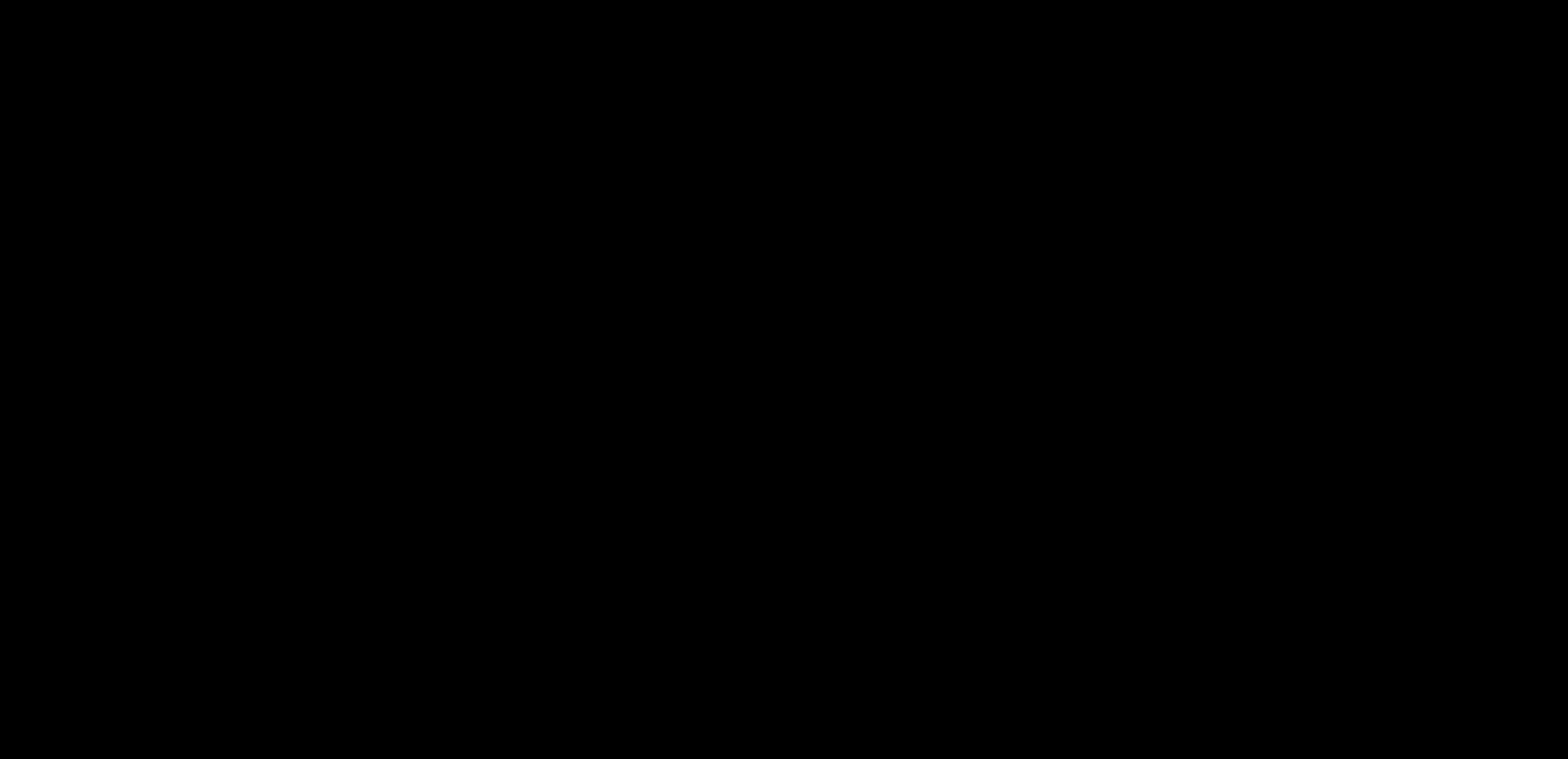

https://www.sierrachart.com/image.php?Image=1788201164355.png un écran noir |
| [2026-08-31 21:18:34] |
With that same setup that you did for us from post #13 where you got just the black screen. Please get us an image of your entire Sierra Chart window. We need to see the menu and title bar as well as the chart that you have open. You can do this by selecting "Edit >> Screen Images >> Upload Main Window Image" and then pasting that link like you did last time. For the most reliable, advanced, and zero cost futures order routing, use the Teton service: Sierra Chart Teton Futures Order Routing |

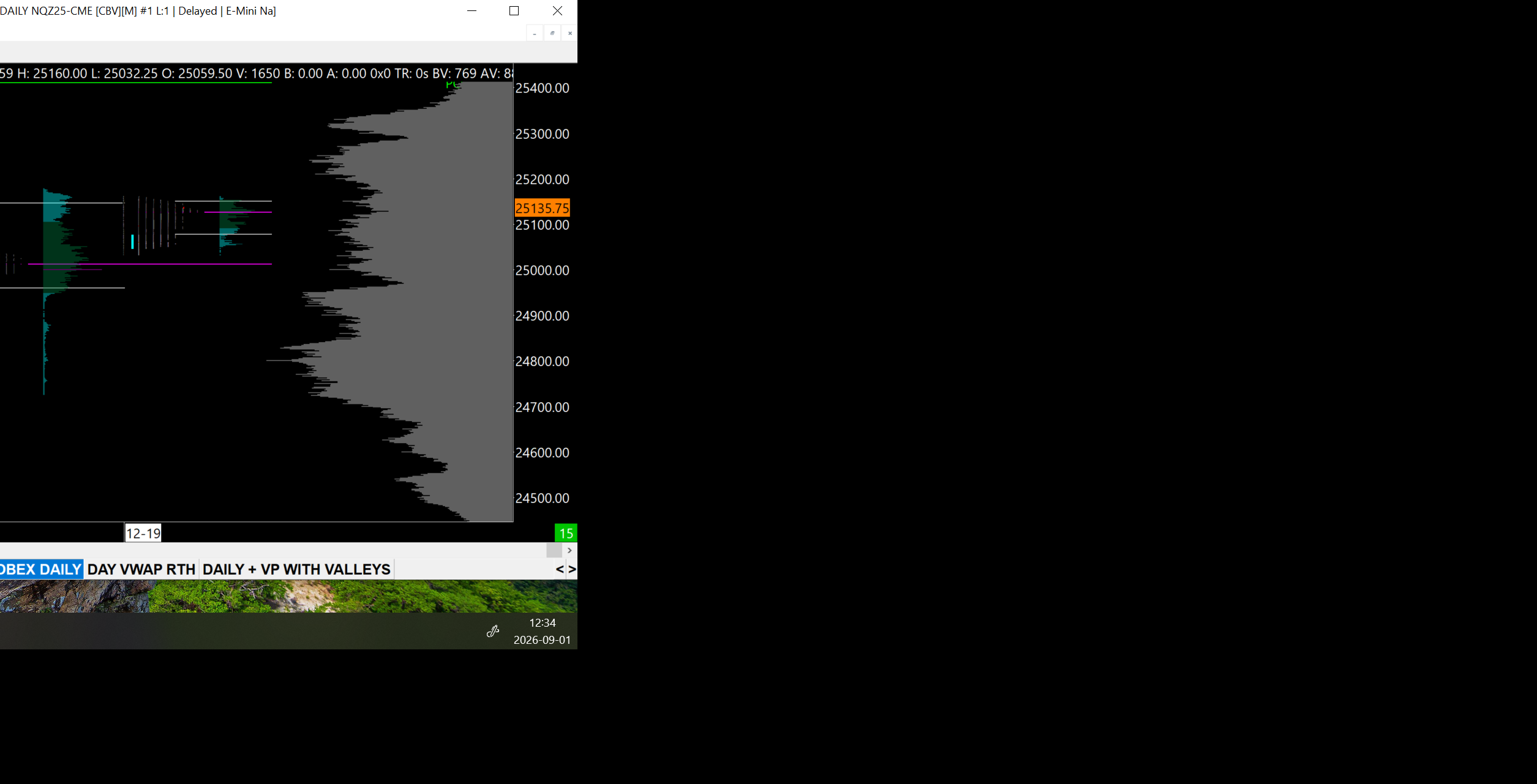

https://www.sierrachart.com/image.php?Image=1788280495399.png Comment on fait pour changer les mois sur le graphique. Présentement je suis le 2025-12-19 merci |
| [2026-09-01 16:43:59] |
The symbol for that chart is "NQZ25-CME". So you are looking at the December 2025 contract. You need to change the symbol for that chart to be the current front month and year, which is the U (September) 2026. So the symbol would be NQU26-CME. Refer to the following for how to change the symbol for a chart: Changing the Symbol of a Chart For the most reliable, advanced, and zero cost futures order routing, use the Teton service: Sierra Chart Teton Futures Order Routing |

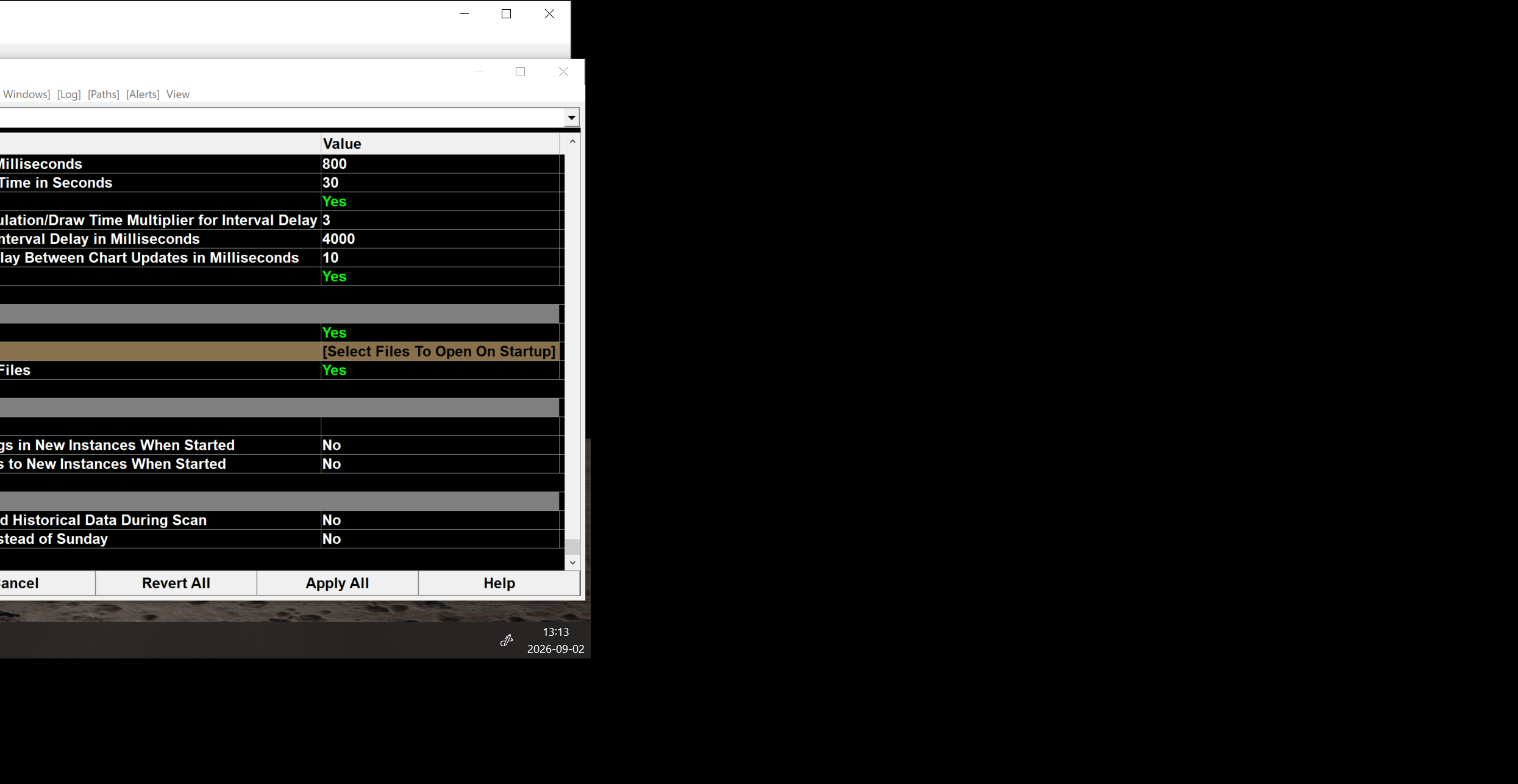

https://www.sierrachart.com/image.php?Image=1788369217565.png https://www.sierrachart.com/image.php?Image=1788369256597.png je vous envoie les image. |
| [2026-09-02 18:02:26] |
We need to see your entire Sierra Chart Main Window. The images you supply are cut off. Offhand, it looks like you are spreading your window over multiple monitors. If this is the case, then we need you to move the window to a single monitor and then get an image. Or, use the Windows Snipping Tool to get us an image (or any third party tool that you prefer to generate an image). For the most reliable, advanced, and zero cost futures order routing, use the Teton service: Sierra Chart Teton Futures Order Routing |

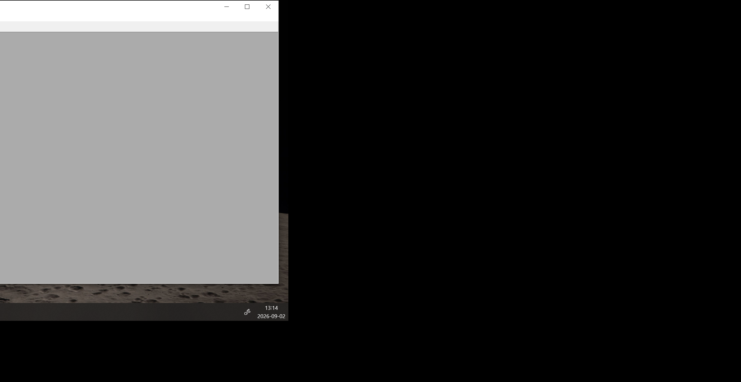

https://www.sierrachart.com/image.php?Image=1788379478968.png
| [2026-09-02 21:24:16] |
Please let us know if what you see in the iamge you provided in Post #22 is the entire Sierra Chart window. It does not make any sense if this is the entire window, as there is no information in the title bar at all. There should be some information in there. Is the Sierra Chart window moved off the side of the Monitor? Is there something else occurring? Do you not see any of the menu commands in your main Sierra Chart window (i.e. File, Edit, Chart, etc.)? For the most reliable, advanced, and zero cost futures order routing, use the Teton service: Sierra Chart Teton Futures Order Routing |
| [2026-09-02 22:47:54] |
oui il a un problème ,parce que se matin toute mais graphique fonctionné parfaitement et puis en avant midi mes graphique je n'avait plus aucun graphique.je voir ma barre de fichier,edition,graphique. je voir aussi la barre sur le coté gauche. Toute mets graphique de nasdac,sp500,dax sont disparue. J'aimerais savoir ces quoi le problème. Mardi toute fonctionné parfait. merci |
