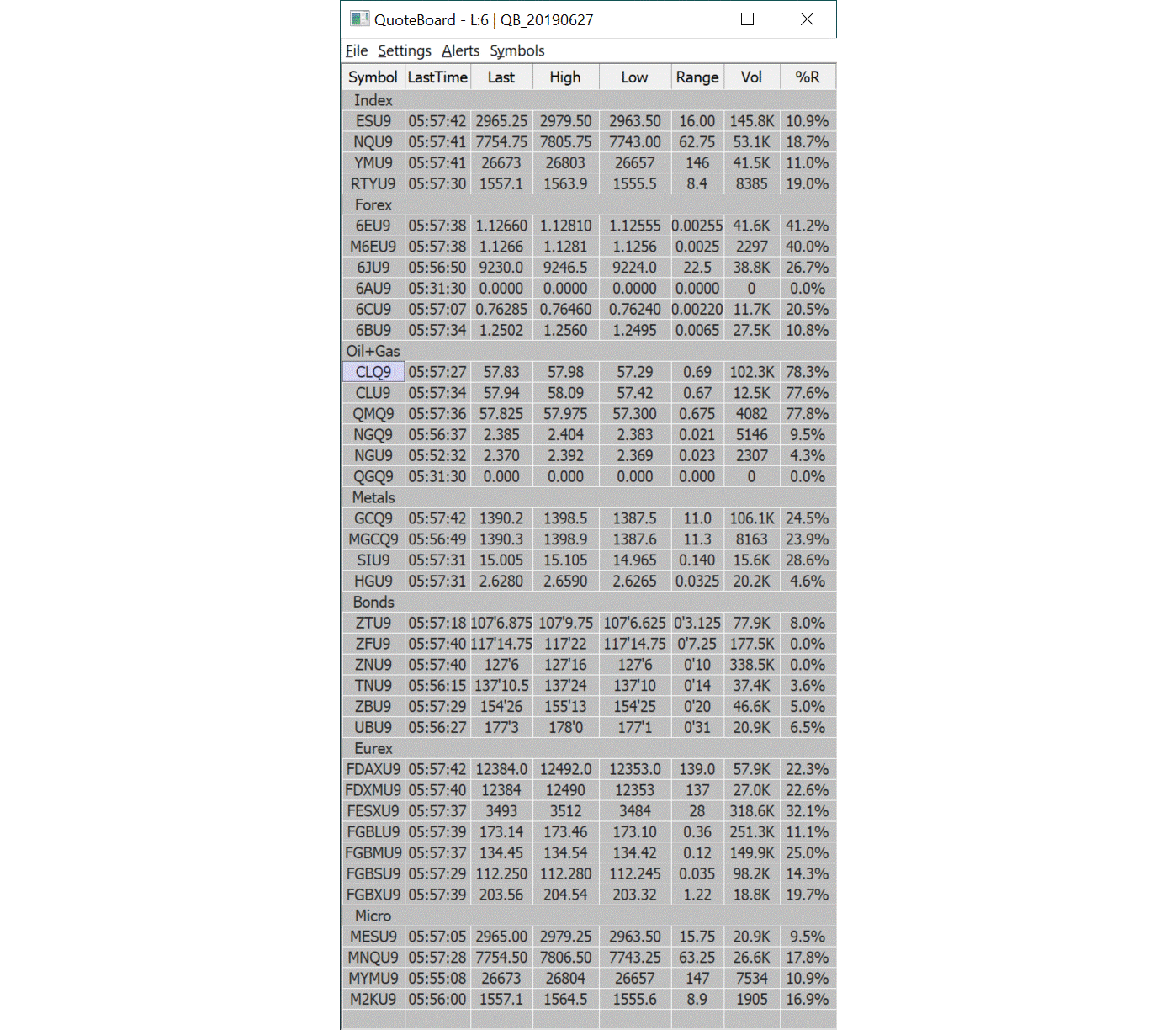

[2019-07-09 10:09:50]
User90125 - Posts: 715
Transact WS connection - v1946 64-bit does not stream all active symbols shown on QuoteBoard assigned to user account
User cannot prompt or otherwise restart/reactivate stuck symbols to stream data and chart actively with Websocket connection
Very unreliable; this behaviour does not occur with Transact legacy/bridge connection in v1941, which works properly, as intended
Message Log also sent for analysis
imageQB_STUCK_SYMBOLS_WS_Connections.gif / V - Attached On 2019-07-09 10:08:22 UTC - Size: 365.42 KB - 381 views
[2019-07-09 14:36:07]
For this issue you need to contact Transact.
