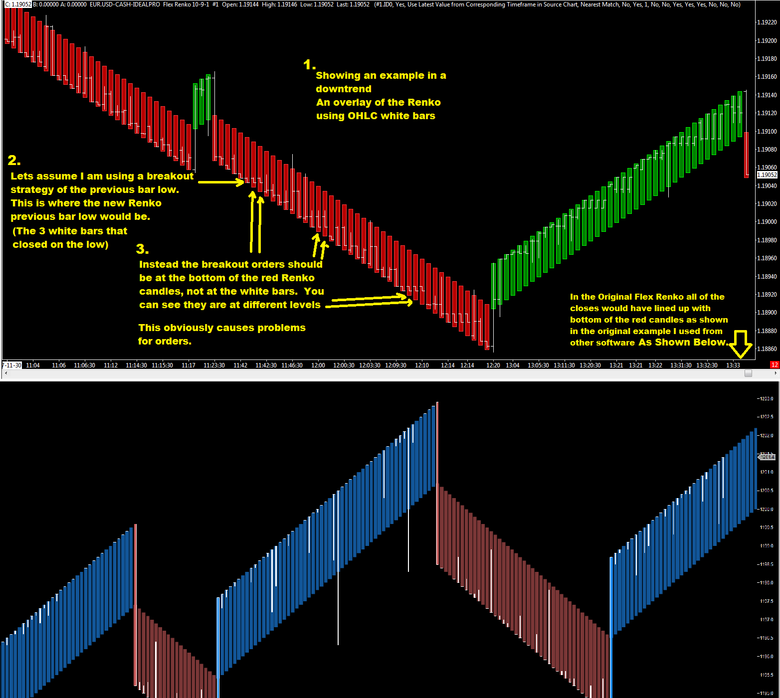

I've just recently returned to using SC and noticed that the Flex Renko bars are not plotting as they have in the past. I use the 10-9-1 setting to create a trend channel and I'd plot OHLC bars on top of them which would show me the intrabar movement of the price.
However, it seems your most recent versions of SC do not plot as smoothly as before, and using the OHLC setting you can see that the the open and closes are occurring intrabar all over the place. I've tried every new setting available, and I configured all of the settings (Gap fill = none / new trend bar when range exceeded/new reversal bar when reversal amount met). But as you can see from the screenshot, there are open and closes at different places within the bars which never occurred in previous versions.
Can you please tell me what settings are needed to return to the simple/clean bars 10-9-1 channel bars as shown in the top portion of my attached screenshot? Or, if this is not possible, tell me what previous version of software I need to revert to, to get back to the original working version of Flex Renko? I don't care for the implementation of the current bars and prefer not to fight or debate about it as I've seen in a similar post. Thanks.
imageFlex Renko Problem.png / V - Attached On 2017-11-30 23:58:07 UTC - Size: 136.34 KB - 1031 views

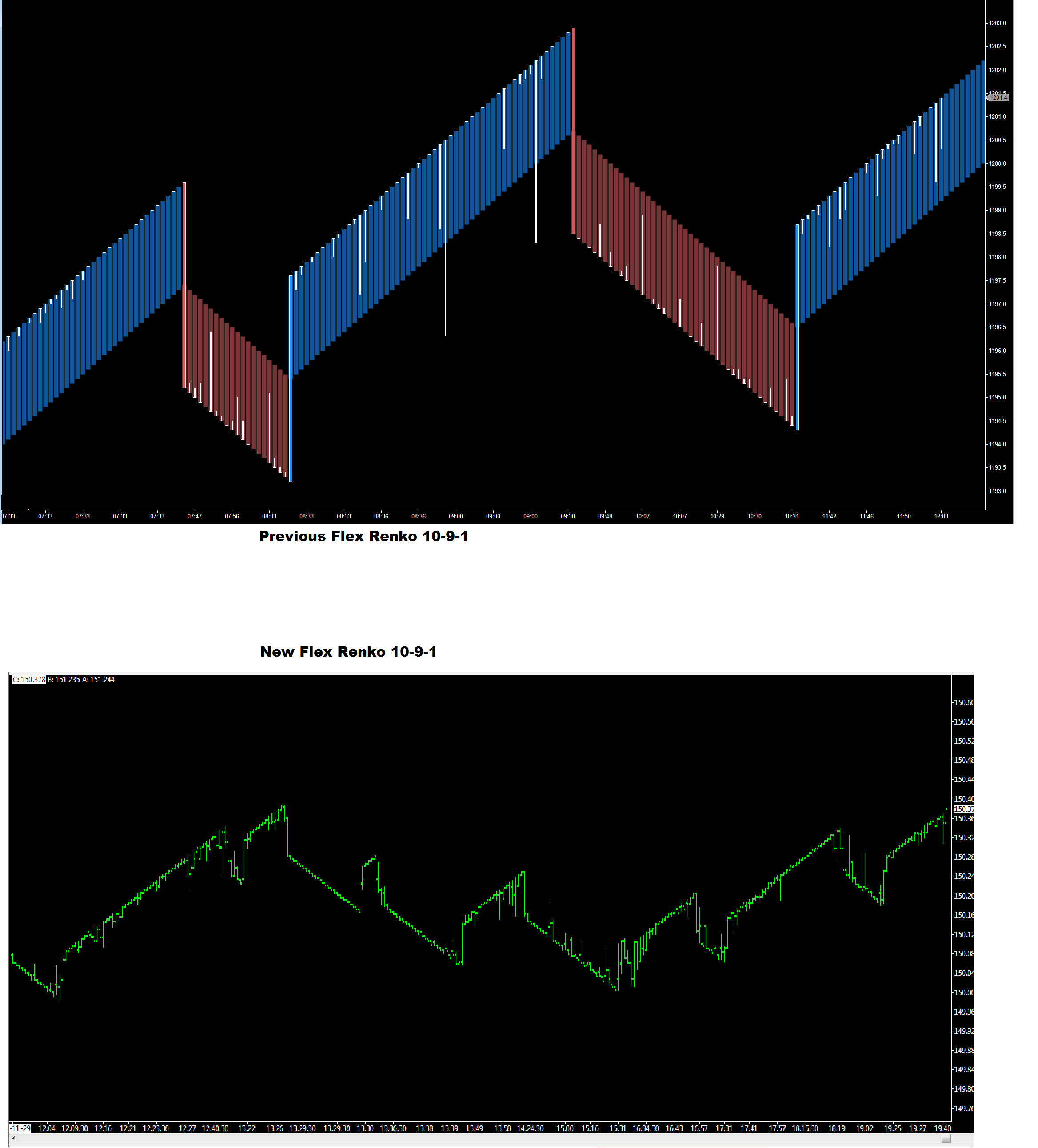

And furthermore, the image you posted here:
https://www.sierrachart.com/Download.php?Folder=SupportBoard&download=14734
Is comparing two totally different things. The chart above is from a different program which has no ability to show the true open high low and close values. Sierra Chart does give you that capability and that is what you are showing. You cannot make any valid comparison. It simply does not exist.

I had to use a chart from another program because I no longer have the ability to take screenshots of the older SC Flex bars and what they looked like. But they were identical to the picture I displayed. But as you stated above, "you are more than happy to lose business over your recent Renko bars development..." That says it all and where your priorities are at...
The point was never whether the bars were correct or not, there was no debate on that issue. The issue was whether you were able to compromise and still keep a version of the older bars for those customers who still wanted to use them. And you've now made your point very clear. You don't care about losing those customer's business... After hearing that, there is not much for me to say. Smh

But there is not a fair comparison with the screenshots. In the chart you have from Sierra Chart you are not using Renko Bricks and instead you are using the standard Candlestick drawing style which is showing the true open high low close values. The general appearance should look identical when using Renko bricks in Sierra Chart.
So anyone else looking at that screenshot, can get misled unless they comprehensively understand what you have done and what you are looking for. That is perfectly fine to us. We do not care about the misunderstanding. This thread is here to do all we can to help you.

I'm sorry but I stopped using graph paper in Junior High. Instead I've attached a screenshot explaining what I'm talking about. But even without the screenshot, what I don't understand is this...
1. The incorrectness of the original Flex bars is what made them unique. By changing to a true ohlc you change the functionality. Your outside developer developed the bars in the same way that your competitors software did because they realized what traders want.
2. You keep debating the fact of whether the true ohlc is the proper way to construct the bars, and as I said earlier, that is not the issue. If you look at my attached screenshots in this post, you will see there is a difference in the appearance of the two charts.
3. What I don't understand is if your developer developed them in a certain way for a reason, and your competitors software and other system creators also create the bars in the same way, that means there is a demand for the bars. But for some reason you don't seem to care about that and only care about being anal about whether the code is technically correct.
4. Rather than do the simple, logical thing and keep a version of the old bars for traders who have built systems around them, you take the stance that it's "your way, or no way!" You are so anal about the code, that you are forgetting the needs of your customers. You then put the responsibility on us, which means that some of us may have to pay to have things reprogrammed. And I'm sure there are others who preferred the old bars but who do not wish to get into a back and forth debate such as I've had to endure.
Then to add insult to injury, you say you're more than happy to lose customers over this (which I see you have since deleted) But kept my post saying how polite you are... Anyway, I've said all I can say. This is exhausting. I've attached a screenshot and you can decide whether that's enough to warrant keeping the old bars as a different operating mode as you suggested.
imageExample.png / V - Attached On 2017-12-03 05:35:35 UTC - Size: 76.72 KB - 529 views

1. This statement makes no sense whatsoever. Flex Renko bars have always been built upon the true high and low values of the underlying data records. Nothing has changed. You simply do not have the proper perspective to even be commenting on this.
2. You cannot make the comparison you are in the attached chart image. You are comparing a substandard piece of software ninja trash to a very very capable sophisticated program like Sierra Chart. Of course you are going to see the fake close values at the extreme of those chart bars because it is not capable of anything else. Sierra Chart also provides the Renko Close value as well. Why you do not use that, we do not know. But do not bother to tell us here. That is up to you.
3. At this present time we are delivering what users are requiring. The simple fact is you do not even realize why you see what you do. If you were to look at the Tool Values Window for each bar, you will see the correct OHLC values:
Chart Drawing Tools: Tool Values Window
The overlay that you are doing, is not copying the bars correctly because you are not using tick by tick data. It is giving you a false impression.
4. If you have to pay for reprogramming, and sometimes you have to realize that would be necessary but we do not even see that is the case here at all.

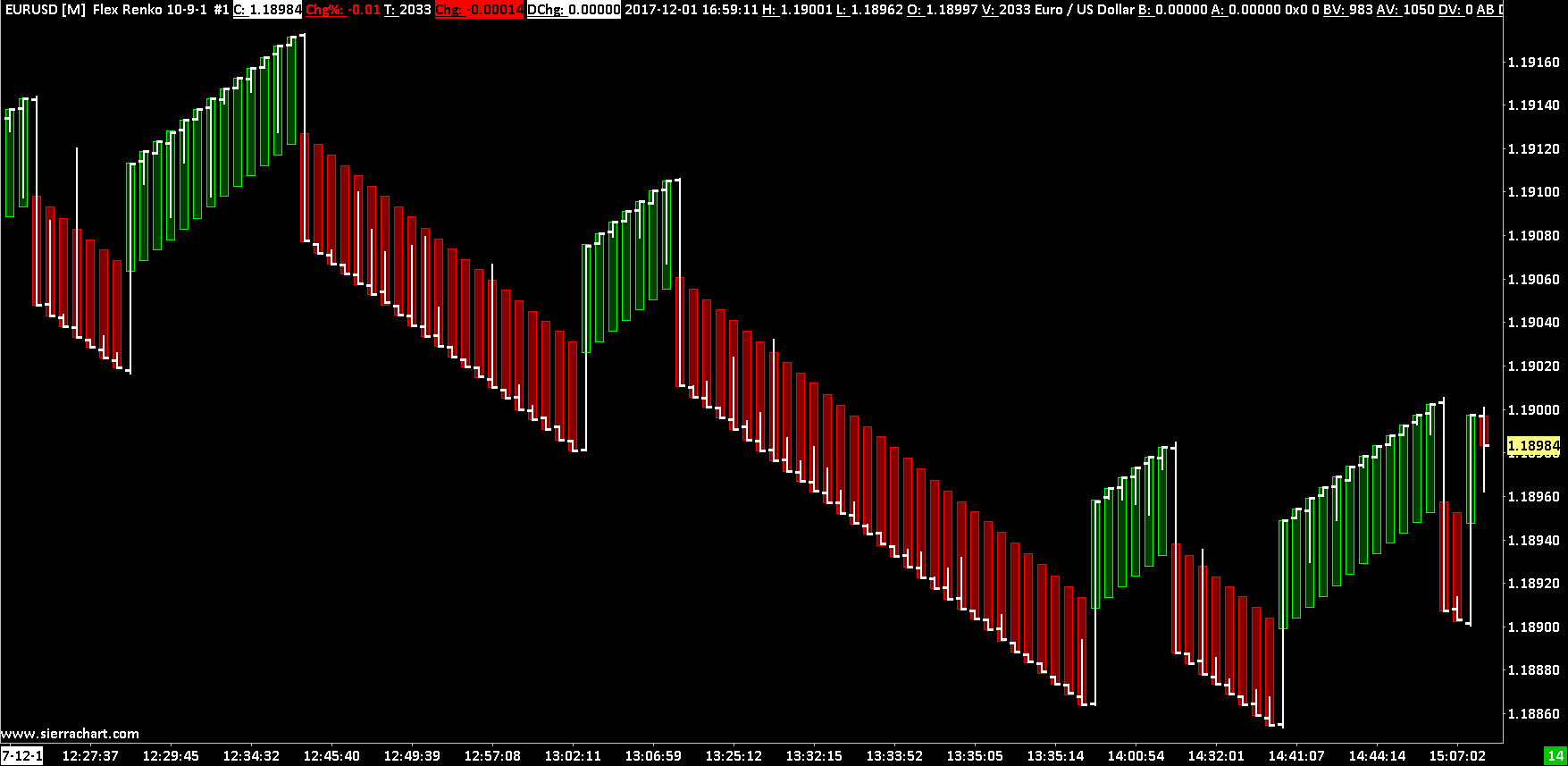

Furthermore, if you are not expressing an issue, until you sort of did in this last post, then we are not going to understand it. What you are enduring is simply the inability to properly express the issue. But actually you are expressing not any genuine issue at all. You are only showing a problem with the overlay study. Will see if we can solve that. But not necessarily.
This is what we see:
http://www.sierrachart.com/image.php?Image=1512293582220.png
This chart is using tick by tick data. The problem is you are not using tick by tick data, so the overlay is not actually overlaying the true data for each bar in some cases but rather the first bar which is getting split into other bars subsequent to it.

And what settings are you using to arrive at the screenshot you posted? My Intraday Data Storage Time Unit under the Data/Trade service settings has always been set to 1 tick, but my charts do not resemble yours.
[2017-12-04 08:55:50]
The problem is you are using Interactive Brokers forex data. So the historical data is going to be in 30 seconds units.
Also we do have the problem resolved with the repeating bars where you do not see the true close at or near the Renko bar close. We needed to apply a millisecond to those individual Renko bars so that they have a unique timestamp.
The new version will be out in a day or two.
[2017-12-04 20:27:06]
rwilliams1 - Posts: 347
I figured out the proper configuration used in your screenshot. Thx.

I just had an additional question about the bars. I switched to using SC historical data instead of Interactive Brokers so that I can be sure the tick information being received is correct. And I have noticed there are places where the bars have displayed some unusual behavior (see attached screenshots). It seems to be happening on some of the reversal bars. I know it's not the data causing this, so I'm hoping you can point out what this may be? Thx again.
imageExample.png / V - Attached On 2017-12-06 00:23:39 UTC - Size: 48.39 KB - 611 views
