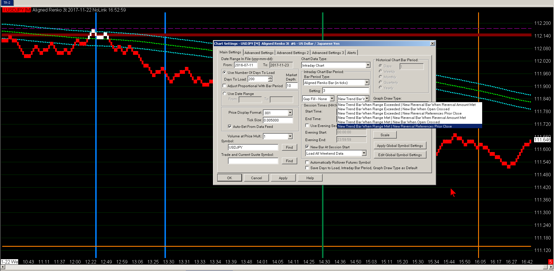

Please see attached images SC-1 and SC-2.
SC-1: About Sierra Chart - Version: 1644
SC-2: Aligned Renko Bar (in ticks) -> New Trend Bar When Range Met | New Reversal Reference Prior Close
1. Please note the Renko shape/form in SC-2.
2. I am unable to duplicate the renko shape/form of SC-2 in the current version 1649. In version 1649 I have tried every [New Trend Bar] option from the drop-down selection but every selection produces only standard [New Trend Bar]shape/form.
3. Surely this is not working correctly.
4. Please advise.

1. Thanks for reply.
2. To repeat - I am unable to duplicate the renko shape/form of SC-2 in the current version 1649. In version 1649 I have tried every [New Trend Bar] option from the drop-down selection but every selection produces only standard [New Trend Bar]shape/form.
3. Have you duplicated the Renko shape/form as illustrated in SC-2 ?
4. If so, what are the settings ?
5. To repeat - I am unable to duplicate the renko shape/form of SC-2 in the current version 1649. In version 1649 I have tried every [New Trend Bar] option from the drop-down selection but every selection produces only standard [New Trend Bar]shape/form.
6. Or does 'there has been a small change' interpret as 'the Renko shape/form as illustrated in SC-2 is discontinued'.
6. Please advise.

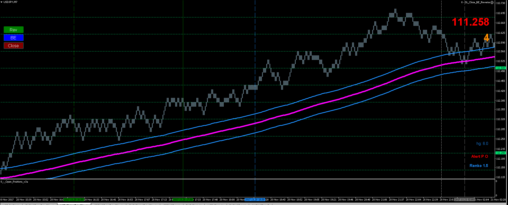

I'm not that accomplished a programmer. However an MT4 EA can be downloaded here for review - https://www.forexfactory.com/showthread.php?t=535170. Choose the 'Rail to Rail' option. The attached image illustrates. However, if there be no wider appeal no need to sacrifice the field for a lily. Thanks for clarifications.

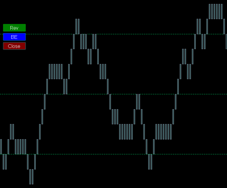

0. Assuming a Renko range of 10 then every increment or decrement of price by 10 marks a price rail and a new bar range is rail to rail. Below bar are assumed no wicks.
1. Bar 1: Price falls - a new bar prints with range 350 to 360.
2. Bar 2: Price falls to 340 without touching 360 - a new bar prints with range 340 to 350.
3. Bar 3: Price rises to 350 without touching 330 - a new bar prints with range 340 to 350.
4. Bar 4: Price falls to 340 without touching 360 - a new bar prints with range 340 to 350.
4. Bar 5: Price falls to 330 without touching 350 - a new bar prints with range 330 to 340.
5. Bar 6: Price rises to 340 without touching 320 - a new bar prints with range 330 to 340.
6. bar 7: Price rises to 350 without touching 330 - a new bar prints with range 340 to 350.
7. From the above it can be determined that every reversal has a minimum of two or more bars of the same price range - please see attachment Rail to Rail - 2 and SC - 2.
Summary of above:
Bar 1 is formed between price rails 350 and 360.
Bars 2,3 & 4 are formed between price rails 340 and 350.
Bars 5 & 6 are formed between price rails 330 and 340. (minimum 2 or more more bars reversal)
Bar 7 is formed between price rails 340 and 350.
If the above is not perfectly clear may be better to move on and refer me to programmer for a quote if the above can be implemented via custom study.

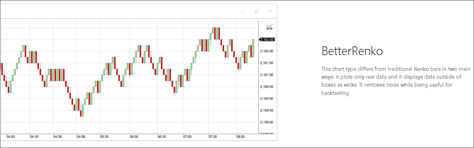

Comment: May be of interest - attachment Better Renko illustrates a slight difference to the above - offered by an established charting package.

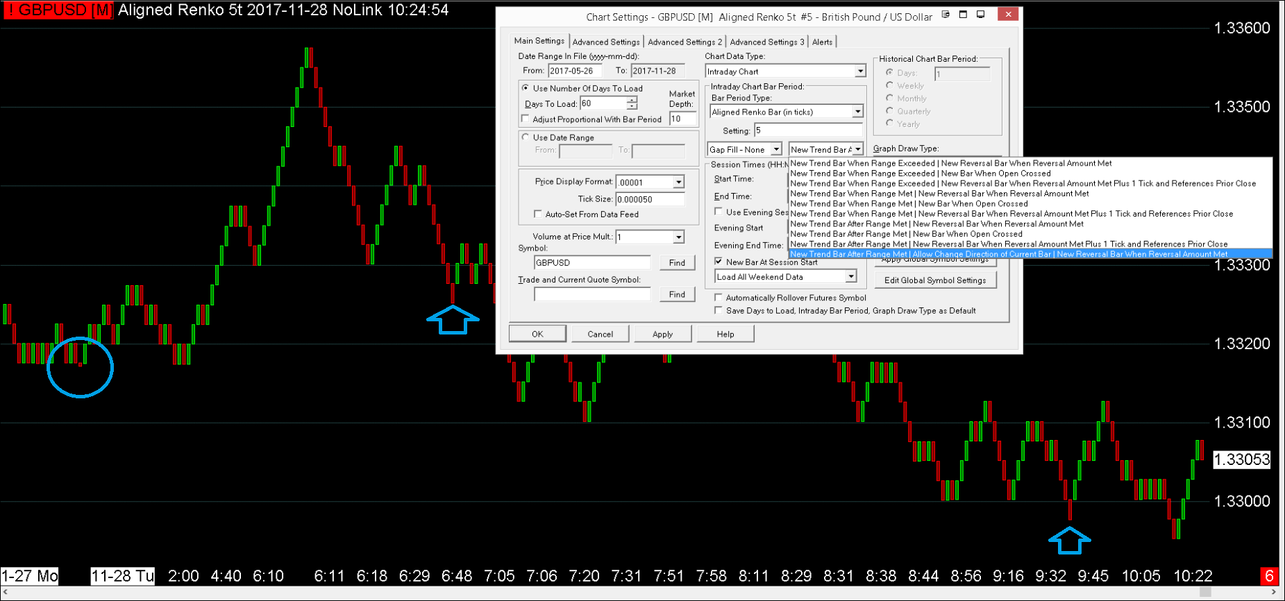

Thank you for implementation of above - New Trend Bar After Range Met | Allow Change Direction of Current Bar | New Reversal Bar When Reversal Amount Met.
1. The above has print errors - please see attached image SC-AR-1a.
2. The blue arrows point to incorrect reversal bar prints of only one bar instead of a minimum of two or more bars. Please see below a) and b) copied from above post #11:
a) 7. From the above it can be determined that every reversal has a minimum of two or more bars of the same price range - please see attachment Rail to Rail - 2 and SC - 2.
b) Bars 5 & 6 are formed between price rails 330 and 340. (minimum 2 or more more bars reversal)
3. Further to a) & b) the corresponding but now defunct [New Trend Bar When Range Met|New Reversal Reference Prior Close] incorporated in version 1644 (retained for reference and comparison) executes perfect prints in accordance with the described method and compares exactly to other alternative charting.
4. Ignore blue ring in attached image SC-AR-1a - it indicates daily 22:00 rollover break.
regards.
Date Time Of Last Edit: 2017-11-29 01:48:06

What you want is now supported in 1664 and documented. We apologize for the delay. Update to the latest prerelease:

Thanks - the accompanying image looks a though it needs updating
imageSC-AR-2.png / V - Attached On 2017-12-10 09:39:17 UTC - Size: 168.49 KB - 744 views
[2017-12-10 09:44:12]
OK that image is now up to date.
