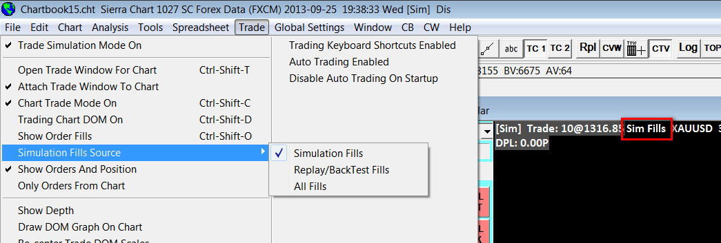

Trade Menu
Trade Simulation Mode On (Trade menu)
When this menu item is checked/enabled, then Trade Simulation Mode is globally enabled. This is a global state. All submitted orders, order modifications and order cancellations will be simulated when Trade Simulation Mode is enabled.
Trading Locked (Trade menu)
When Trading Locked is enabled, has a checkmark beside it, then this means that order submissions, order modifications and order cancellations from anywhere within Sierra Chart, including the DTC Server are blocked and will give an error message in the Trade >> Trade Service Log.
When Trading Locked is disabled, then none of this applies.
Open Trade Window for Chart (Trade menu)
Opens the Trade Window for the active chart.
Attach Trade Window To Chart Window (Trade menu)
Attaches the Trade Window for the active chart to the chart window. It can be attached to the left or right side. By default it is attached to the left side. To move it to the right side, select Chart >> Chart Settings >> Advanced Settings and enable Attach Trade Window to Right Side.
Chart Trade Mode On (Trade menu)
When this menu item is checked/enabled, then Chart Trade Mode for the active chart is enabled.
This means that order entry, modification, and cancellation is supported directly from the chart itself.
This menu command applies for the active chart. It is not global.
If you want to just display orders on the chart but not be able to modify or cancel them, then disable Trade >> Chart Trade Mode On and instead enable Trade >> Show Orders and Position.
Control Bar buttons can be set up for each of these commands.

Show Order Fills (Trade menu)
When this menu command is checked, then Order Fills will be displayed on the chart. Order Fills are displayed as small boxes on the chart indicating the Quantity and Price of the fill and other fill data along with a corresponding arrow at the price level of the fill. This command applies to the active chart. The data that is displayed can be customized. For complete documentation, refer to Displaying Order Fills on the Chart documentation.
Show Orders And Position (Trade menu)
When this menu item is checked, then working orders for the Symbol and Trade Account of the chart will be displayed on the chart. The Trade Position line will be displayed on the chart as well. Although it may not be visible if the Position Average Price is not known or its Average Price is outside of the range of prices currently displayed on the chart.
