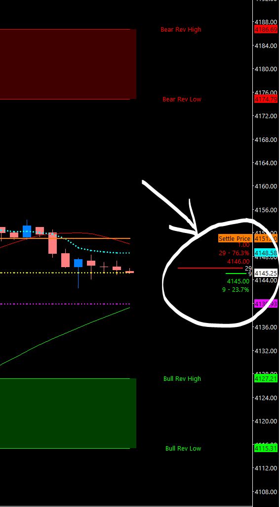

See the attached screen shot. This has been working fine for MONTHS. I haven't changed anything on the chart, or even in the entire chartbook.
It started happening about 2 weeks ago. The only way to get it expanded again is to close the entire INSTANCE. Just closing the chartbook doesn't do anything. When you reopen it, same issue.
I have attached a screen shot showing the issue. I use this regularly in my trading and would appreciate some guidance.
imageCapture.JPG / V - Attached On 2023-05-08 01:12:08 UTC - Size: 59.05 KB - 296 views
[2023-05-08 01:18:15]
User450463 - Posts: 147
Well, I spoke too soon. I just shut down the entire instance, and this time, the problem still persists. The last time I closed the instance, it appeared normal when I restarted it.
I should mention that this chart is in a sub-instance, not the main instance. I just discovered that when I disconnect from the data feed in the main instance, and reconnect, the DOM appears normal again. It looks like the main instance isn't passing along the market depth data or something...
Date Time Of Last Edit: 2023-05-08 01:25:17

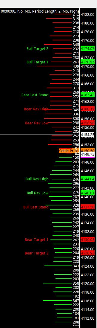

Yes. Do you see the Chart DOM graph consists of only 1-2 lines? There should be dozens. As I mentioned, this has been working properly for MONTHS until a few weeks ago. Here is what it normally looks like ON MY SYSTEM.
See attachment. The depth levels are all set correctly both in chart settings, and global symbol settings. Again, this has been working for months.
Pls advise.
imageWhat it SHOULD Look Like.JPG / V - Attached On 2023-05-08 23:20:57 UTC - Size: 79.16 KB - 262 views
