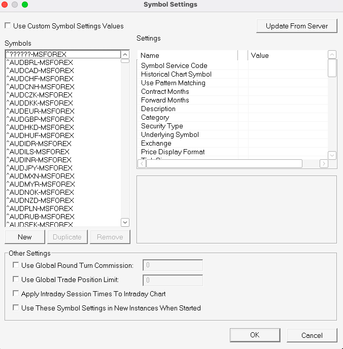

Sierra_Chart Engineering - Posts: 25069
There are two different issues in this thread.
Regarding post #3, disable the use of custom symbol settings:
Global Symbol Settings: Disabling Custom Symbol Settings
Regarding post #4:
This issue is now resolved.
Follow the instructions here to download missing data:

[2023-02-05 12:20:15]
As we said before, disable the use of custom symbol settings:
[2023-02-05 21:04:27]
User24242424 - Posts: 11
Hi , I've disabled custom system setting and attached the screenshot and find below the logs. But its still not working.

imageScreen Shot 2023-02-05 at 2.53.09 PM.png / V - Attached On 2023-02-05 21:04:16 UTC - Size: 44.88 KB - 199 views
[2023-02-05 22:04:06]
We see the problem now. You are using a CQG symbol. This is not the correct symbol for the Service you have Sierra Chart set to. Translate them with this Edit menu command:
Edit Menu: Edit >> Translate Symbols To Current Service
