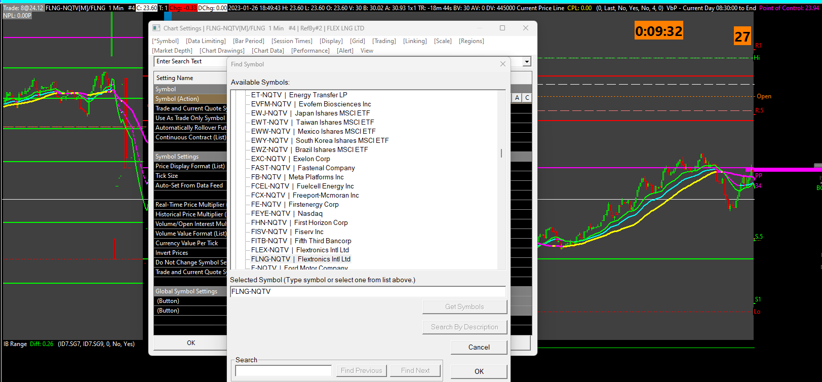

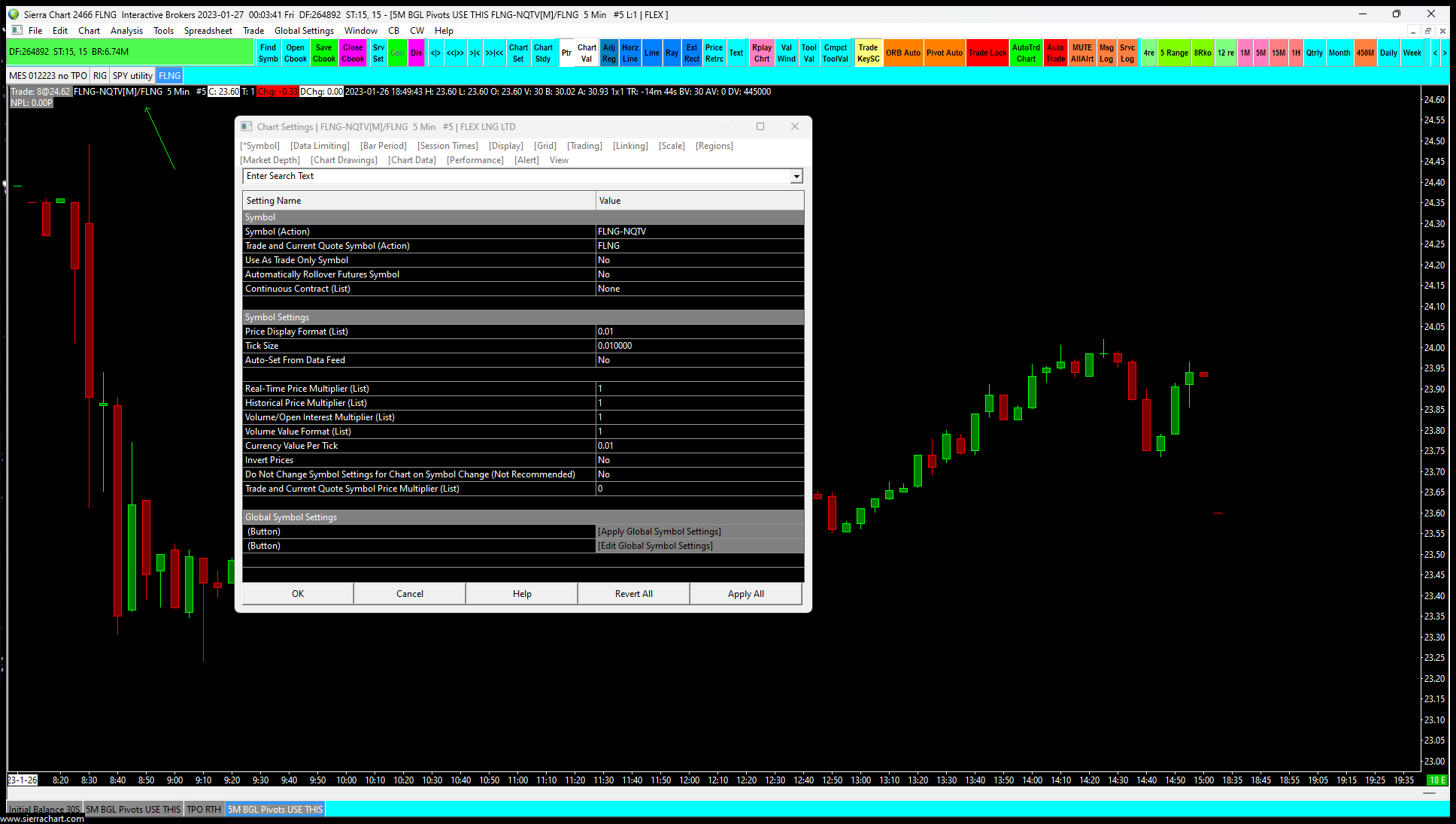

[2023-01-27 06:01:39]
John M - Posts: 189
I don't think it's on my end. Please see attached and tell me what's incorrect.
If you look in Find symbol you will see FLEX-NQTV | Flextronics Intl Ltd
Below it you will see FLNG-NQTV | Flextronics Intl Ltd
https://www.sierrachart.com/image.php?Image=1674799167632.png
https://www.sierrachart.com/image.php?Image=1674799423515.png
Date Time Of Last Edit: 2023-01-27 06:13:06
imageScreenshot_20230127_120950.png / V - Attached On 2023-01-27 06:12:43 UTC - Size: 121.23 KB - 292 views

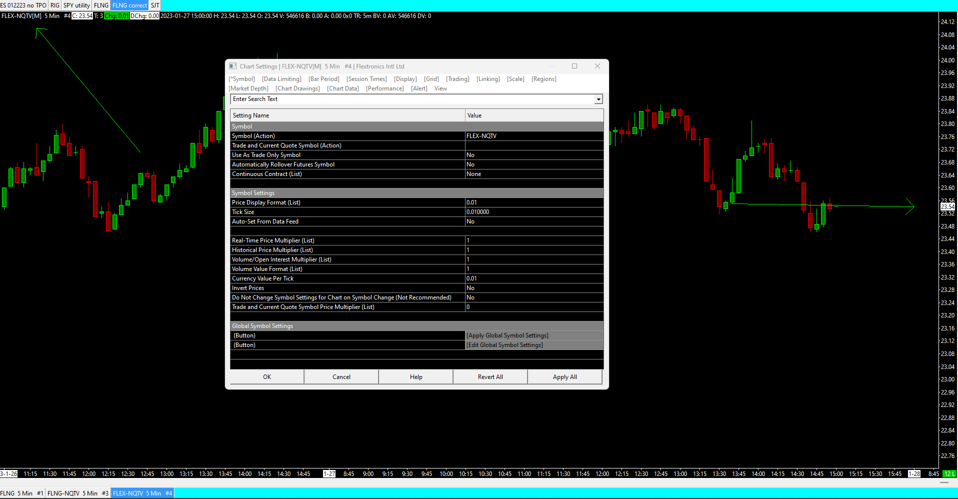

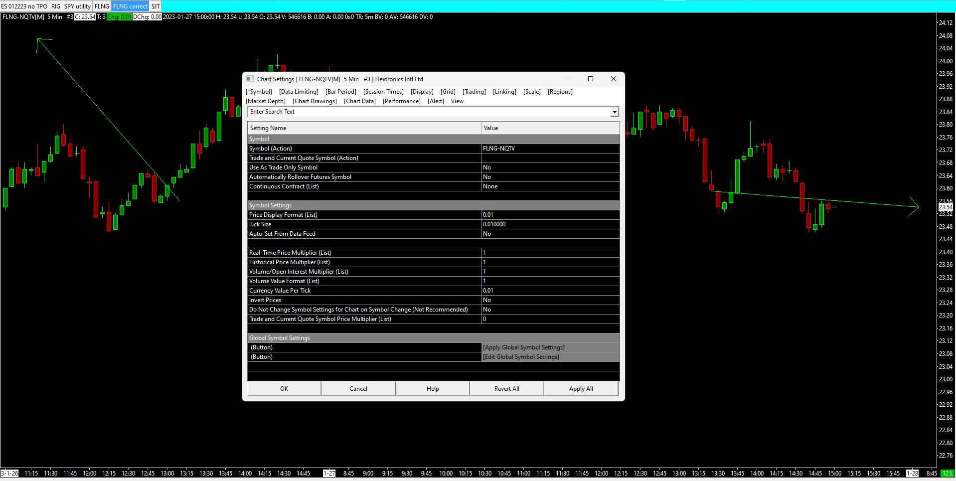

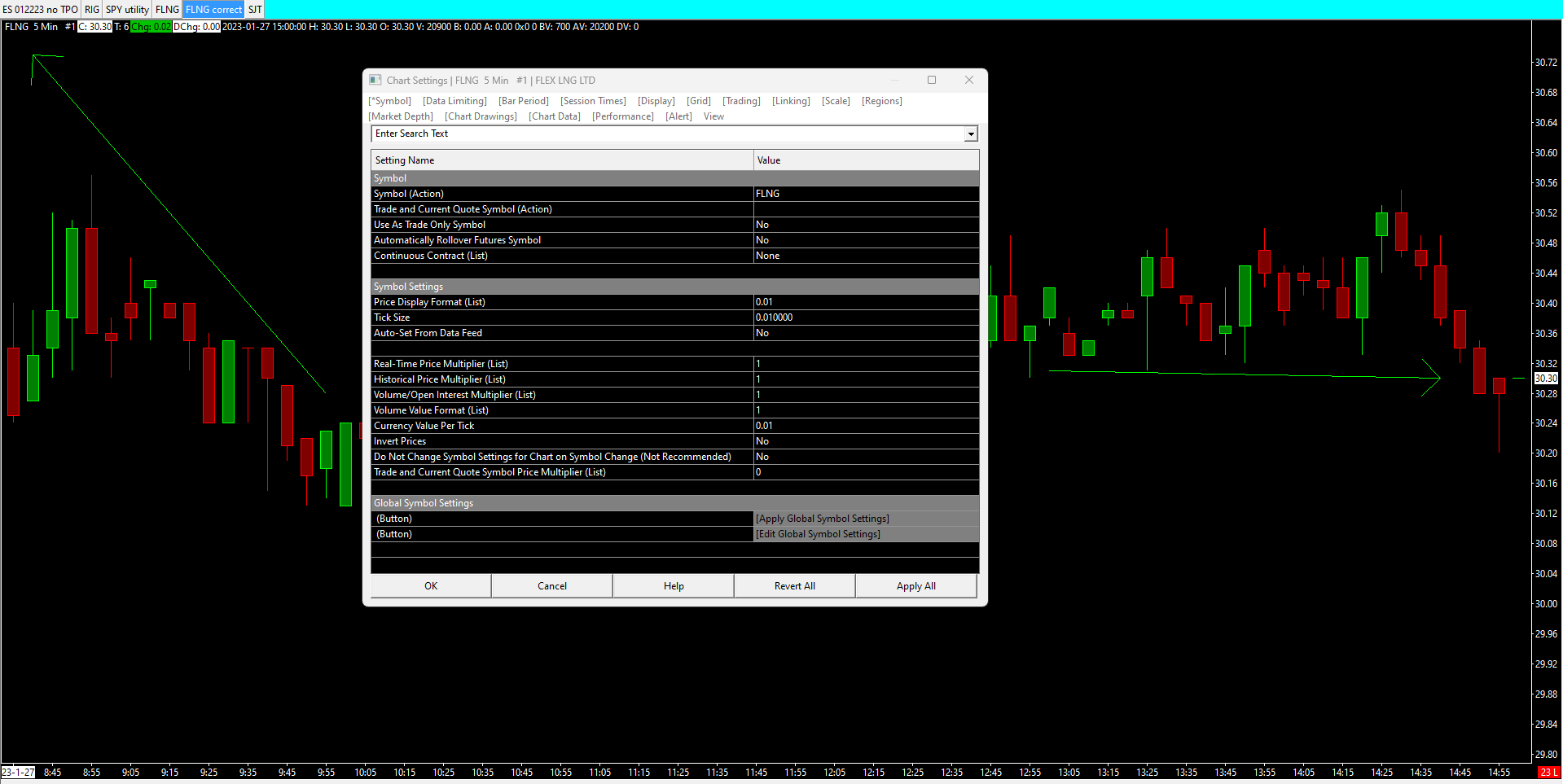

[2023-01-27 13:21:22]
John M - Posts: 189
Someone really needs to look at the above post please. The screen captures document the issue well.
This is a reproducible problem with FLEX-NQTV and FLNG-NQTV giving the same data for FLEX and not FLNG.
If I input FLNG, I get the proper price data for Flex LNG.
If I input FLNG-NQTV I get the price data for Flextronics.
I do not have this issue with other symbols.
thank you.
https://www.sierrachart.com/image.php?Image=1674827236403.png
https://www.sierrachart.com/image.php?Image=1674827340123.png
Date Time Of Last Edit: 2023-01-27 13:49:26

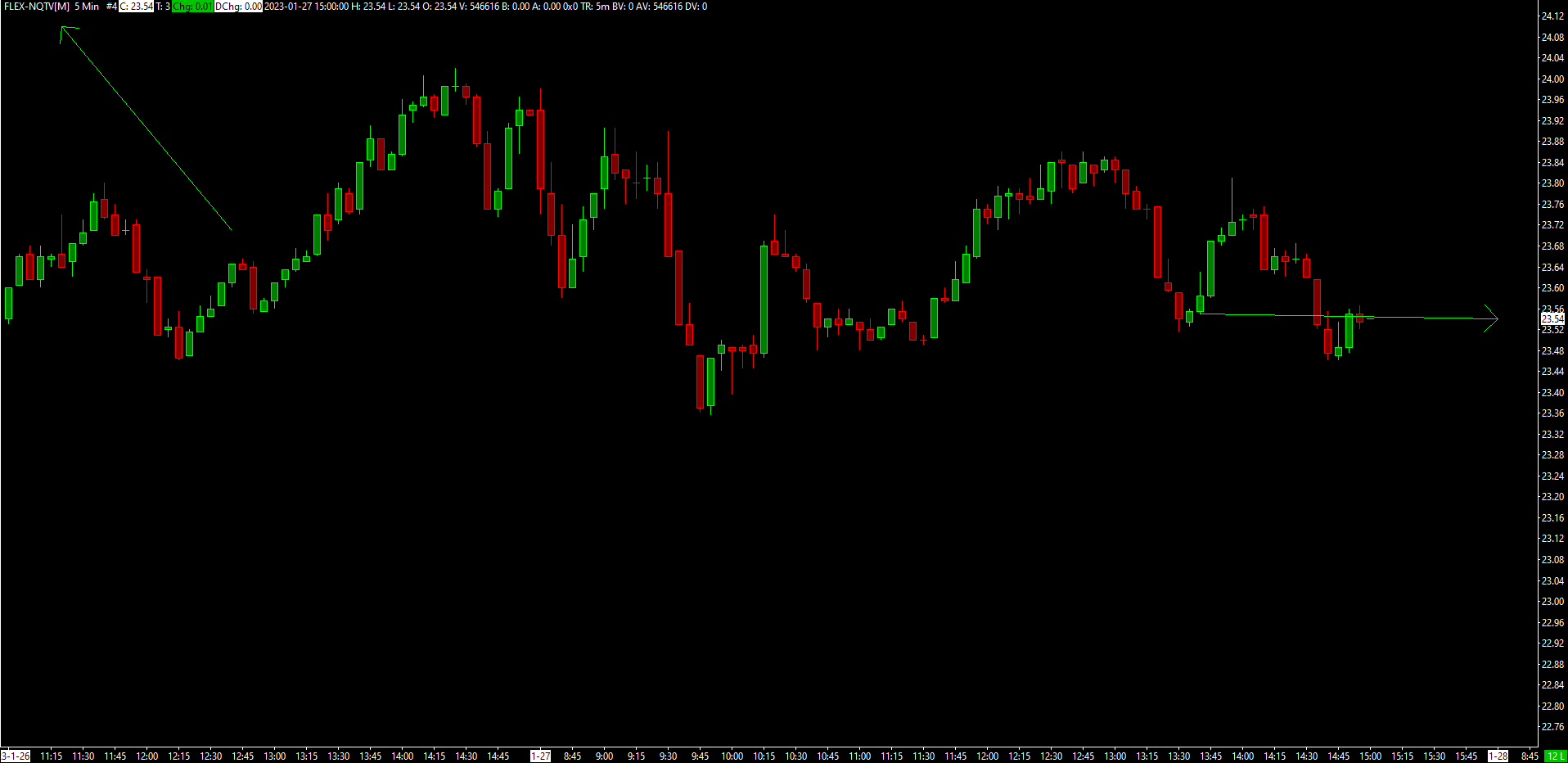

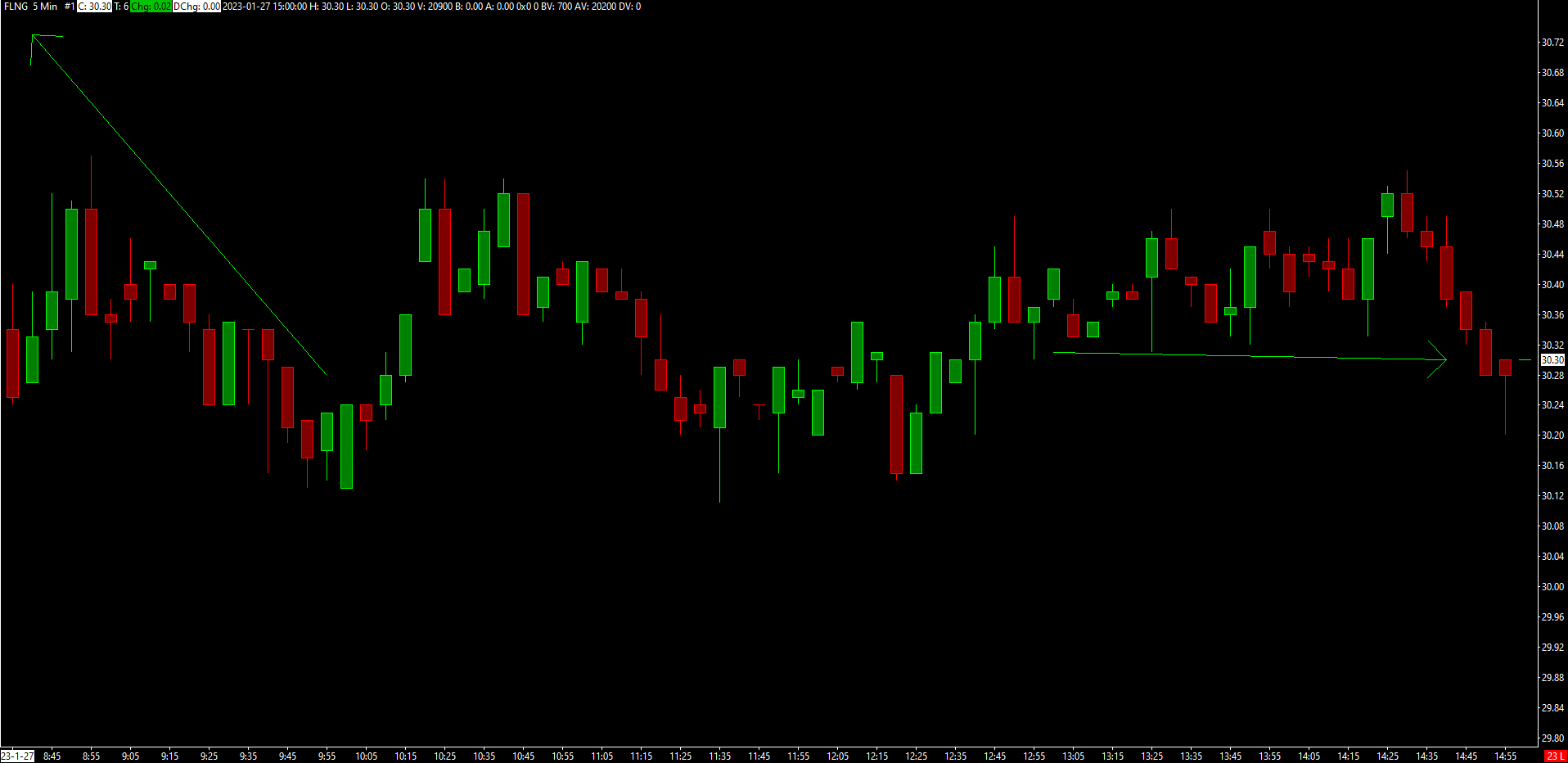

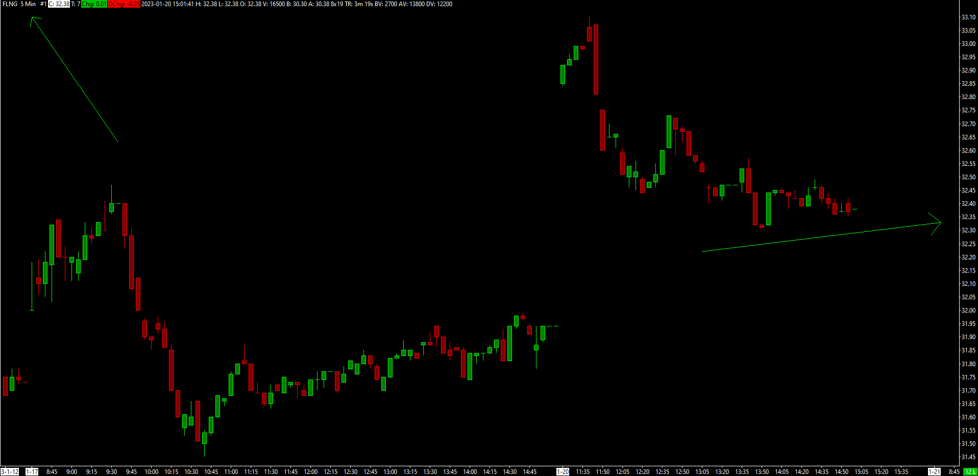

[2023-01-28 17:19:29]
John M - Posts: 189
"Curiouser and Curiouser", said Alice.
-Alice in Wonderland-

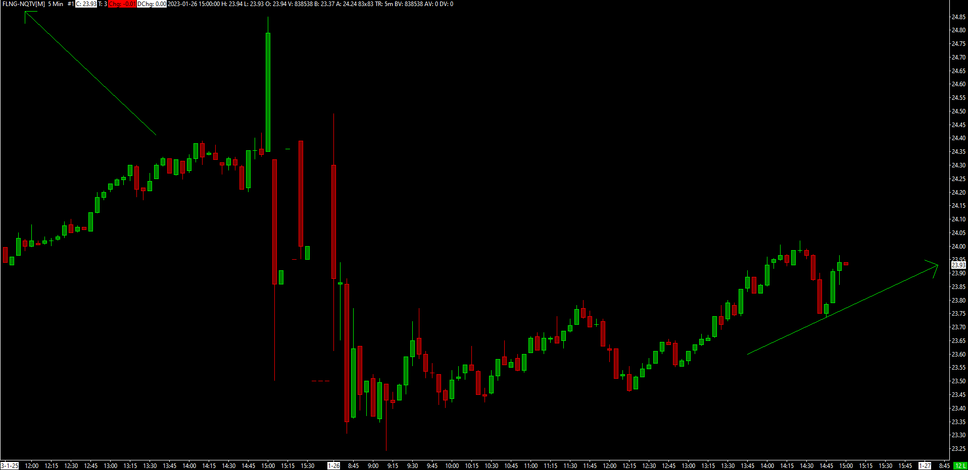

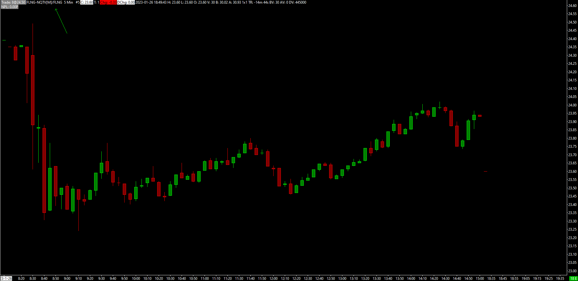

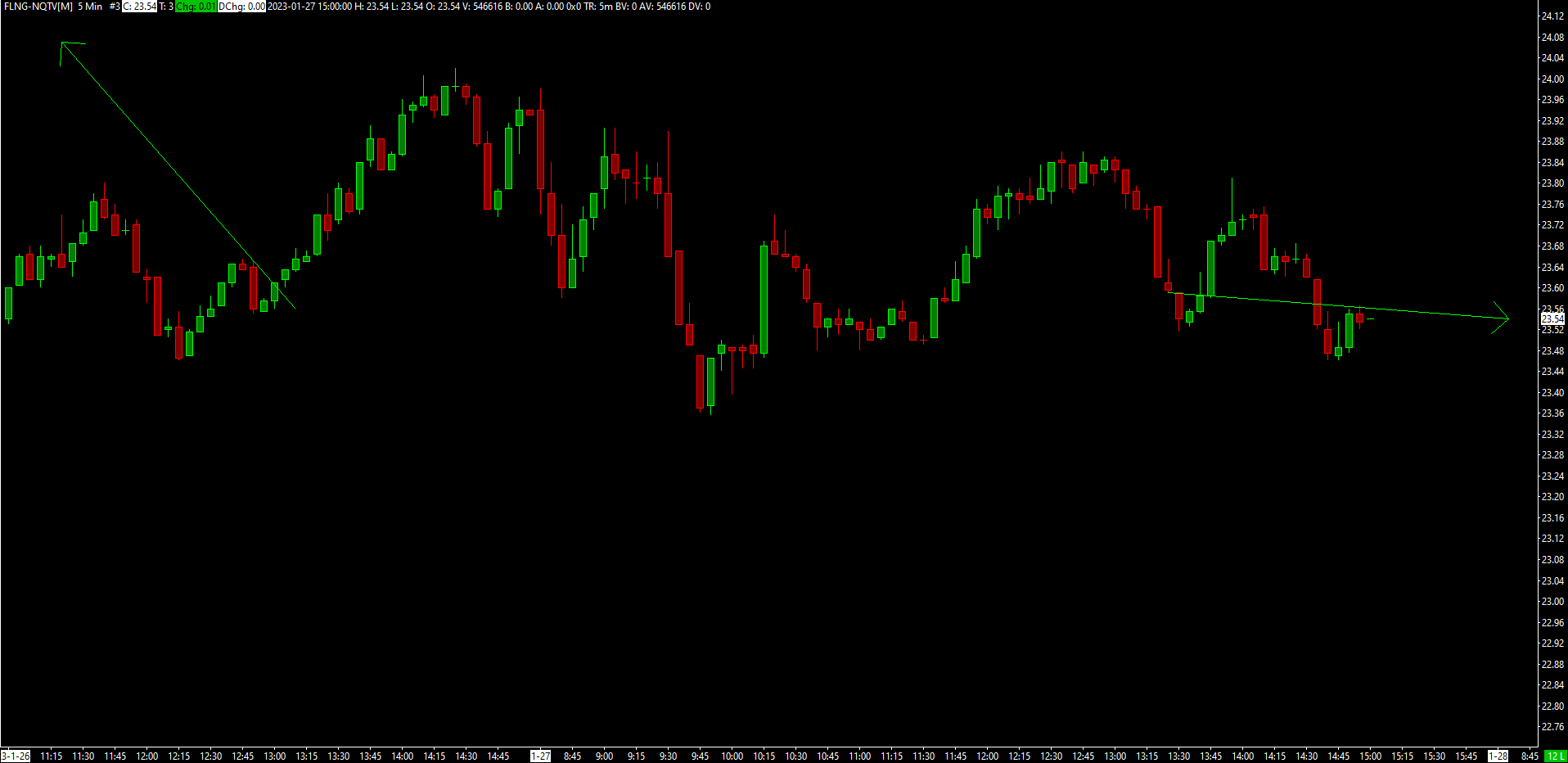

Some charts and such for your perusal in pursuing this problem. It isn't operator error.
https://www.sierrachart.com/image.php?Image=1674925432388.png
https://www.sierrachart.com/image.php?Image=1674925586853.png
https://www.sierrachart.com/image.php?Image=1674925616780.png
imageFLNG-NQTV 20230128_110952.png / V - Attached On 2023-01-28 17:15:57 UTC - Size: 81.28 KB - 382 views
imageFLNG 2023-01-28 111247.png / V - Attached On 2023-01-28 17:16:33 UTC - Size: 73.68 KB - 342 views
imageFLEX 2023-01-28 110833.png / V - Attached On 2023-01-28 17:16:50 UTC - Size: 83.99 KB - 285 views

Sierra_Chart Engineering - Posts: 25488
Sierra Chart does not provide any symbol settings for:
FLNG-NQTV
If you see that in File >> Find Symbol , then you must have set that up yourself. Not Sierra Chart. And there is an error in the Symbol Settings you created. This is what is causing the problem. This is not the fault of Sierra Chart.
Exit from Sierra Chart, go into the Sierra Chart installation folder and go to the SymbolSettings sub folder and delete the custom symbol settings file : CustomSymbolSettings.interactive_brokers.trading.xml
