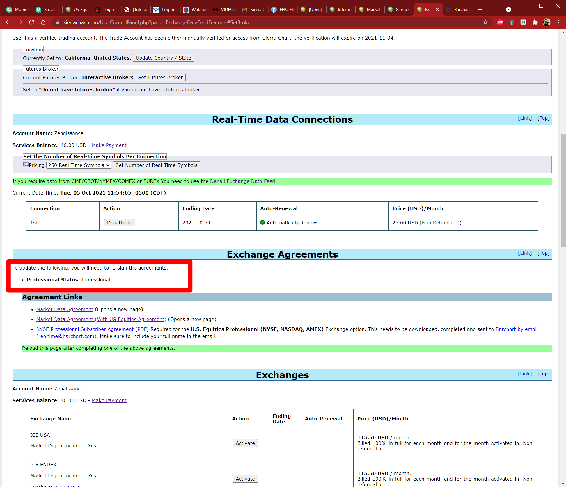

Thank you for the reply John. I believe I've found the source of the delayed Equities data. Looks like I'm still classified as a Professional. My previous email was the reason of the Pro tag. I have updated my email and resubmitted the exchange agreements. What is the ETA to correct my status to non Professional and have my US data back to real-time?
Thank you for the help.

[2021-10-05 18:24:39]
You are correct, it is the Professional status.
We have sent an email to our provider for this data to find out the status of your resubmission of the agreements. As soon as we hear back, we will let you know.
[2021-10-05 20:00:16]
MetaTradingVR - Posts: 33
My status has been updated to Non Professional, but data is still delayed. I've disconnected and reconnected from data as well as shut down Sierra.
[2021-10-05 22:37:17]
Effective tomorrow morning, you will begin to receive real-time data for US equities.
