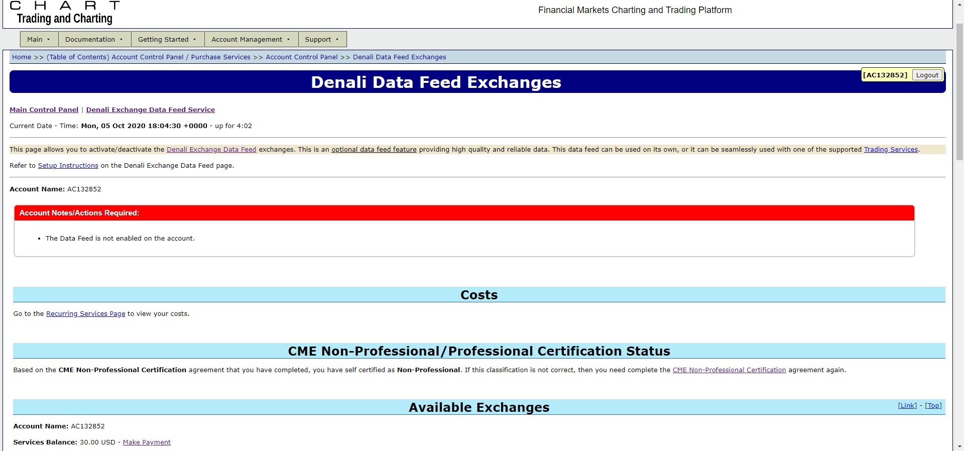

[2020-10-05 18:28:54]
User341105 - Posts: 20
And why does it say "The Data Feed is not enabled on the account?"
imagedownload (2).jpg / V - Attached On 2020-10-05 18:28:05 UTC - Size: 226.11 KB - 401 views
[2020-10-05 20:09:41]
The data feed is not enabled as you need to get AMP to complete the setup. But, you first need to sign the agreements. The page you went to is not the right one. Select this link to get the agreements:
https://www.sierrachart.com/UserControlPanel.php?page=ExchangeAgreements
Scroll down the page a bit to get to the section for Real-Time Agreements and fill those out.

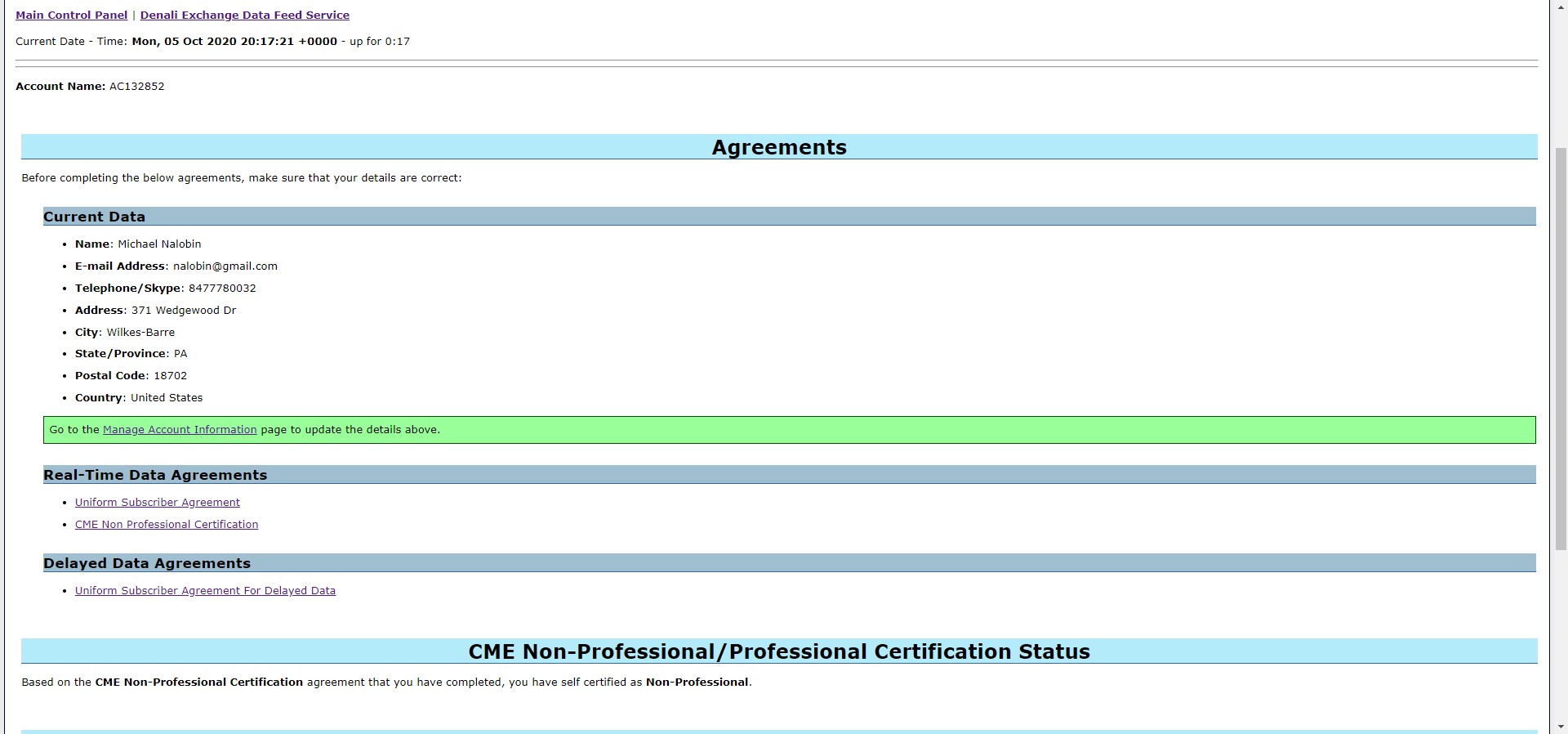

[2020-10-05 20:19:28]
Please explain what does it mean "get the agreements"
Please see attached screenshot.
imagedownload (3).jpg / V - Attached On 2020-10-05 20:19:18 UTC - Size: 158.41 KB - 459 views
[2020-10-05 20:24:20]
On that page that you took the screenshot of, there is a section that states "Real-Time Data Agreements". In that section there are two links. You will need to select each one, which will open a document that you need to read, fill out (as necessary) and then submit. Just follow the directions in each document. The documents are named the following:
- Uniform Subscriber Agreement
- CME Non-Professional Certification

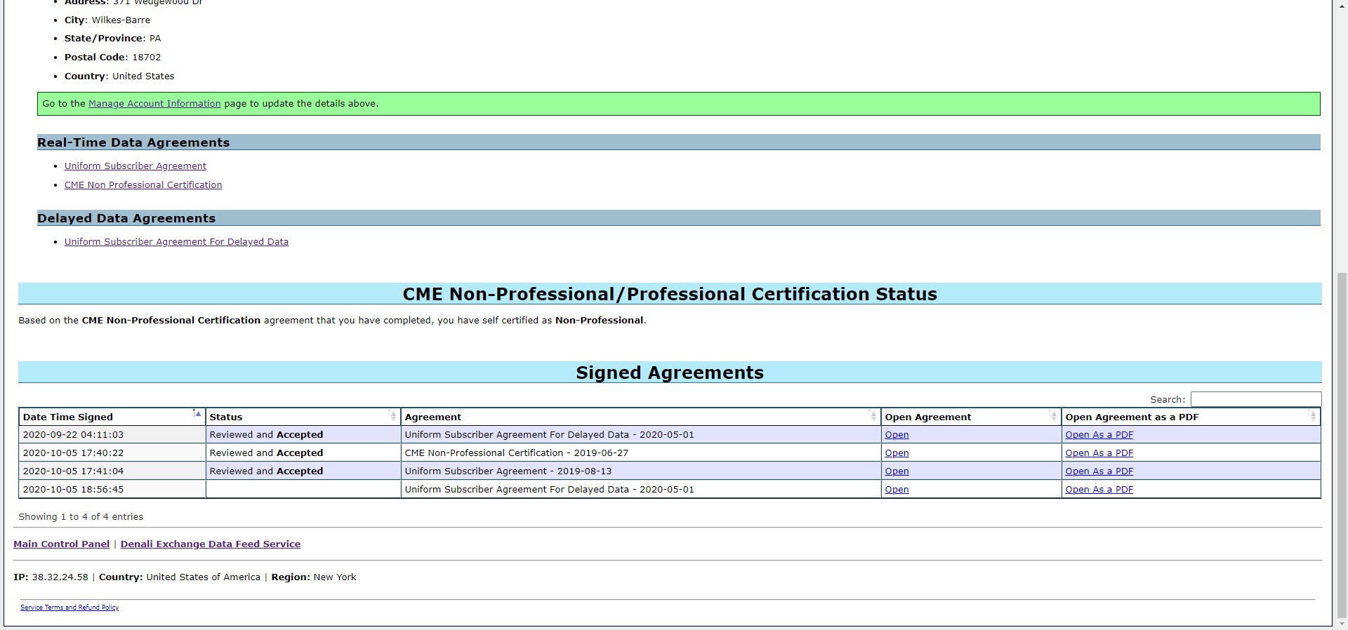

[2020-10-05 21:39:15]
But i keep telling you that i did it this morning. that why I send you the screenshot showing that all of that has done
However, it did not resolve the problem. Please see attached screenshot. it shows that the agreements are sign
I still has the same problem. Please help.
imagedownload (4).jpg / V - Attached On 2020-10-05 21:39:04 UTC - Size: 216.22 KB - 416 views
[2020-10-05 22:01:39]
Sorry, I must have looked at a different account where they were not showing as complete.
Since those are done, you now need to call AMP and tell them that you want to get the Denali Exchange Data Feed setup for your account and that you have completed the Agreements. They will take care of getting it setup for you.

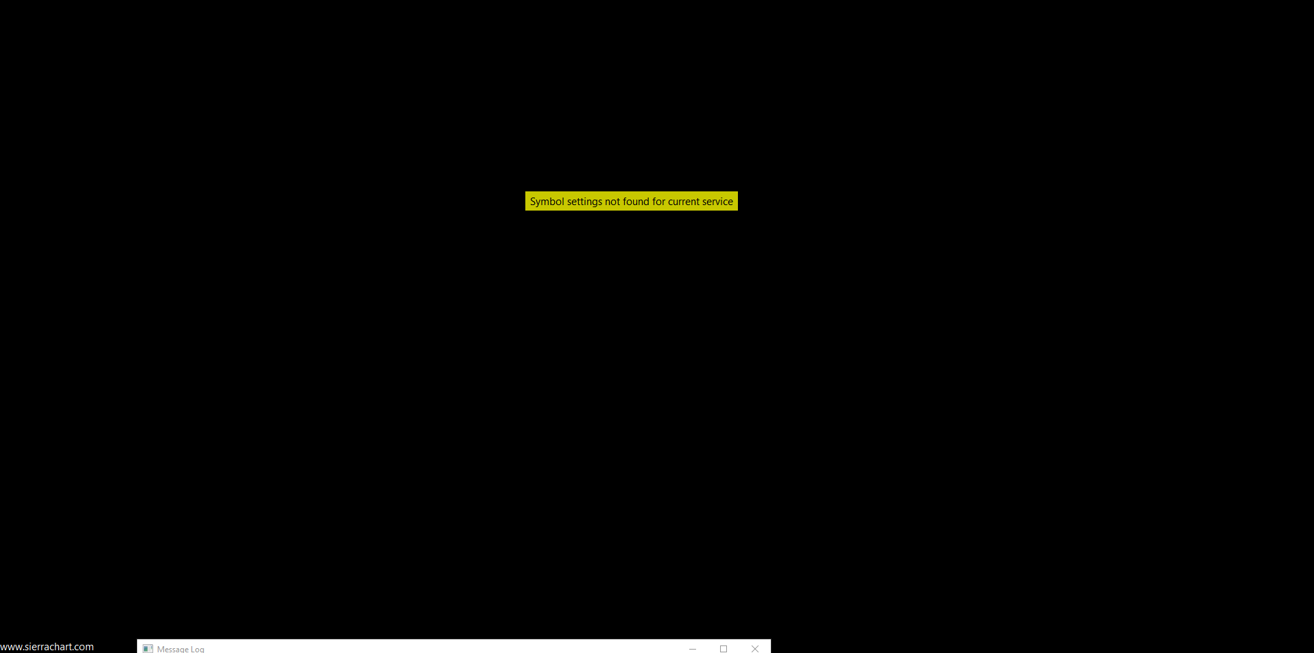

[2020-10-06 12:31:50]
I just uploaded chart emage. It is a black crean with note on yelow - "Symbol settings not found for current service"
The symbol is MESZ20-MESH21.MES.FUT_SPREAD.CME
[2020-10-06 12:33:52]
http://www.sierrachart.com/image.php?Image=1601987553631.png
http://www.sierrachart.com/image.php?Image=1601987615533.png

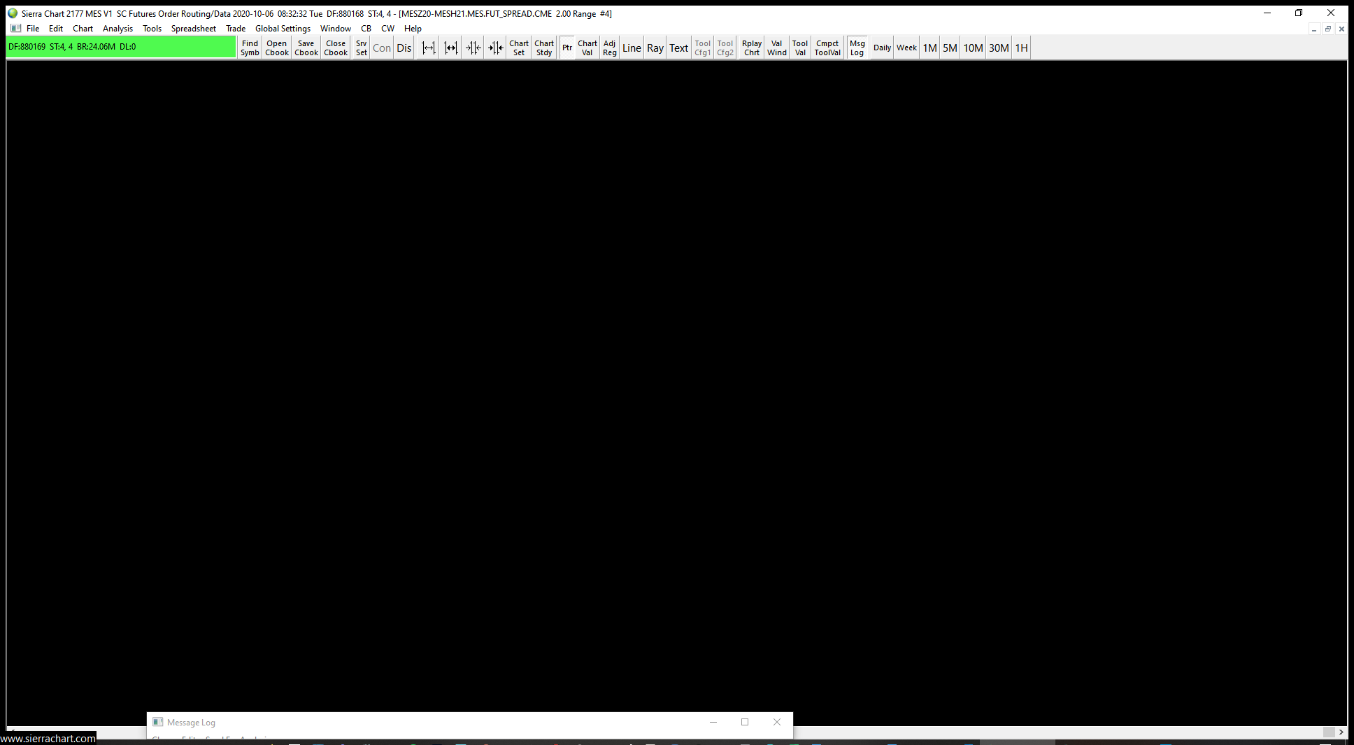

[2020-10-06 16:03:17]
The issues is with MES
ES seems working
[2020-10-06 16:51:57]
It does not download chart data
[2020-10-06 22:52:25]
This is what we see for that spread:
http://www.sierrachart.com/image.php?Image=1602024699186.png
There is not much data. But you should see that.
Go to that chart and follow these instructions:
Fully re-download the data in the chart by going to the chart and selecting "Edit >>Delete All Data and Download".
After about a minute provide a copy of the Message Log following these instructions:
