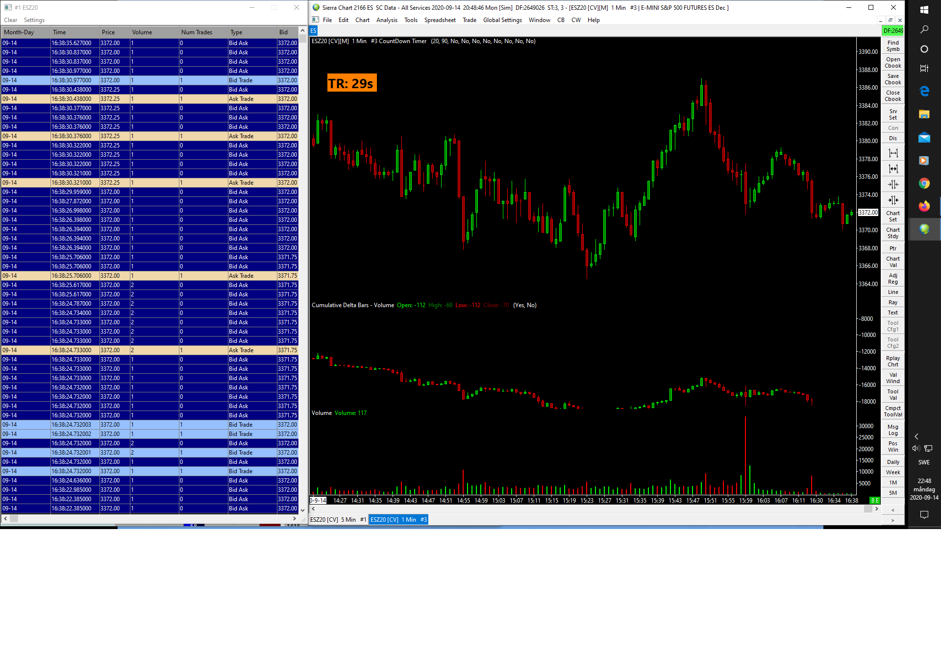

User804994 - Posts: 8
I've attached a screenshot taken during a 6 sec stall. So what I mean with stall is that the chart stops moving and no orders print on the DOM, but there's no freezinf of the screen or anything.
When I first noticed it I put your study countdown timer on the chart, and there I could see that even the timer stops. So when this screenshot is taken for example, the countdown timer stopped at 29 sec, and after 6 seconds it jumped to 23 seconds and the chart moved again. On the DOM you can clearly see how it jumps and "catches up" every time it has stalled.
Since I had to take a screenshot when the problem actually occurs I couldn't use your instructions for uploading charts, I had to use print screen and upload it, hope it's okey.

[2020-09-14 23:01:10]
If you are looking at the difference between 16:38:30 and 16:38:35 in the time and sales window, this is nothing unusual. There were just simply no bid/ask updates transmitted by the exchange.
And if there was no reconnection at the time and you would know because you would see Downloading Historical Data displayed on the chart, then this is just totally normal.
There simply is no problem here as we suspected.
And what you describe about the countdown timer is also perfectly normal. Why would you expect the market to trade every second. If you have further questions contact the exchange. If you have questions about the exchange trading activity contact the exchange . They should not be posted here.
Date Time Of Last Edit: 2020-09-14 23:01:59
