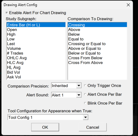

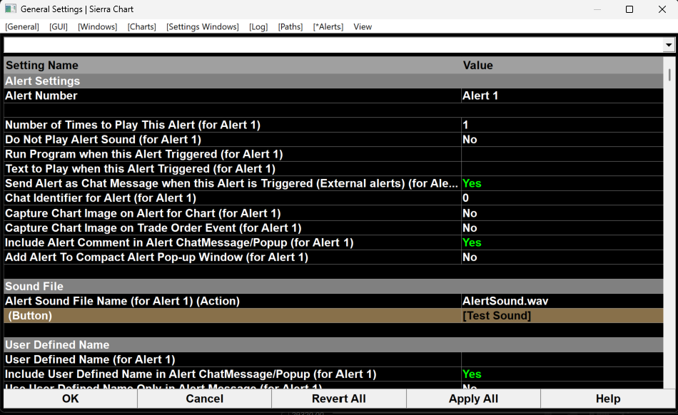

[2026-08-26 16:00:00]
Please get us an image of the Chart Drawing Alert window for the specific chart drawing that you are trying to make work.
Then also get us an image of the Alerts tab on the General Settings window with the specific alert selected that you are trying to make work with that drawing.

[2026-08-26 16:07:52]
Louis Vs - Posts: 26
Here you are. note, I have tried crossing or equal too and equal to also.

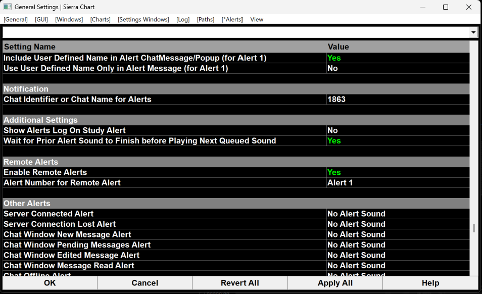

[2026-08-26 20:53:32]
Everything looks good, so from what we can see, you should be getting the notifications to your Chat.
We just want to verify, especially because you say you tried different Alert settings, you are getting an alert showing in your Alert Manager? But that alert is not going to the Chat?
Also, please verify that the Chat Identifier for the chat group you setup is, in fact, 1863.
[2026-08-27 13:31:17]
I am yes. And no errors in the message log. Yesterday I received multiple notifications on NTFY for a drawing that was not even on the chart. But any newly drawn ones do not work. This morning, I was spammed with “rectangle 24, crossing from below” at 7715.5. There is no rectangle at 7715.5.
As I said, I recently switched windows device from a PC to a laptop. Perhaps sierra chart is still responding to old drawings that existed on that device but did not carry over visually to this one? Best I can think of.
I’m stumped. Could you reccomend any method whatsoever I could fix this? Do you think I should start a new chat and fill everything in from scratch? If so, how can I silence the old one, and “delete” any chat drawings that do NOT show up in the chart drawings window. Or at least, make it so that these seemingly invisible drawings cannot fire alerts any longer.
Thank you.
And yes, the chat identifier number is correct.
