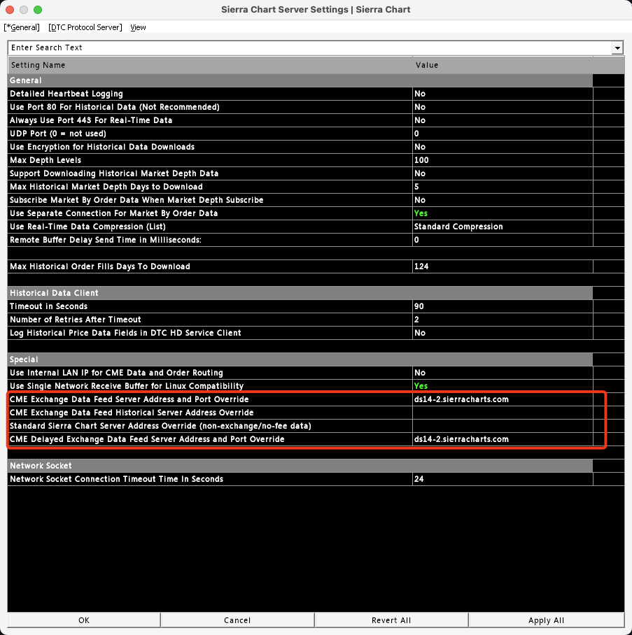

[2026-08-04 10:40:48]
dikii_tapok - Posts: 8
Hello, just to check. If I live in Ukraine, it's better to use this?
imagetg_image_4187613774.png / V - Attached On 2026-08-04 10:40:14 UTC - Size: 86.29 KB - 105 views
[2026-08-04 14:10:08]
Sierra_Chart Engineering - Posts: 25393
It does not matter. We would actually recommend using no setting if you are in Europe and the US servers would be used. Generally that is going to be better.
