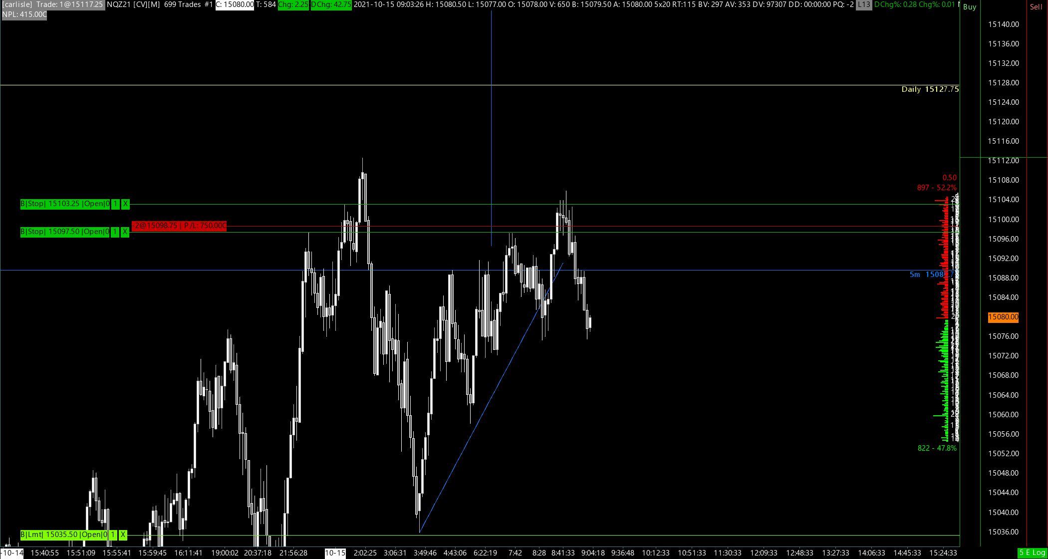

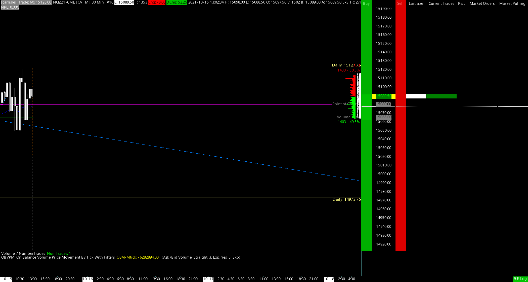

I uploaded the chart, but am having issues figuring out how to upload the stand alone DOM the same way.
Edit: and no, i am not seeing anything in the DOM.
http://www.sierrachart.com/image.php?Image=1634303008881.png
Date Time Of Last Edit: 2021-10-15 13:05:31
[2021-10-15 14:02:39]
Given what you are showing, implies that you do not have the correct columns displayed.

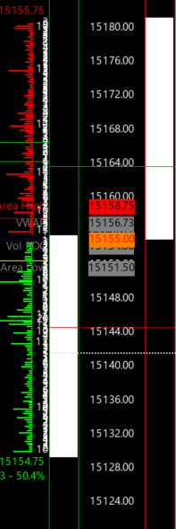

I did not have anything more than what was 'stock' so to speak enabled. I went ahead and added a few columns and 'enabled' the generic colors that are populated in the chart DOM global settings and resent the screen image.
Date Time Of Last Edit: 2021-10-15 17:04:32
[2021-10-15 18:07:39]
There are no images attached. Can you please attach them again to this thread?
[2021-10-15 20:11:10]
Drew1904 - Posts: 26
By all means: https://www.sierrachart.com/image.php?Image=16343173568.png
Thanks again.

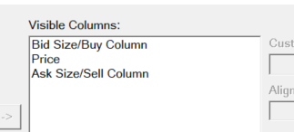

Unfortunately as much as I wish that is the problem it is not. Screenshots attached.
Thank you
imageBid ASk Columns.PNG / V - Attached On 2021-10-17 22:08:16 UTC - Size: 37.12 KB - 306 views
imageVisible columns.PNG / V - Attached On 2021-10-17 22:08:24 UTC - Size: 11.76 KB - 278 views

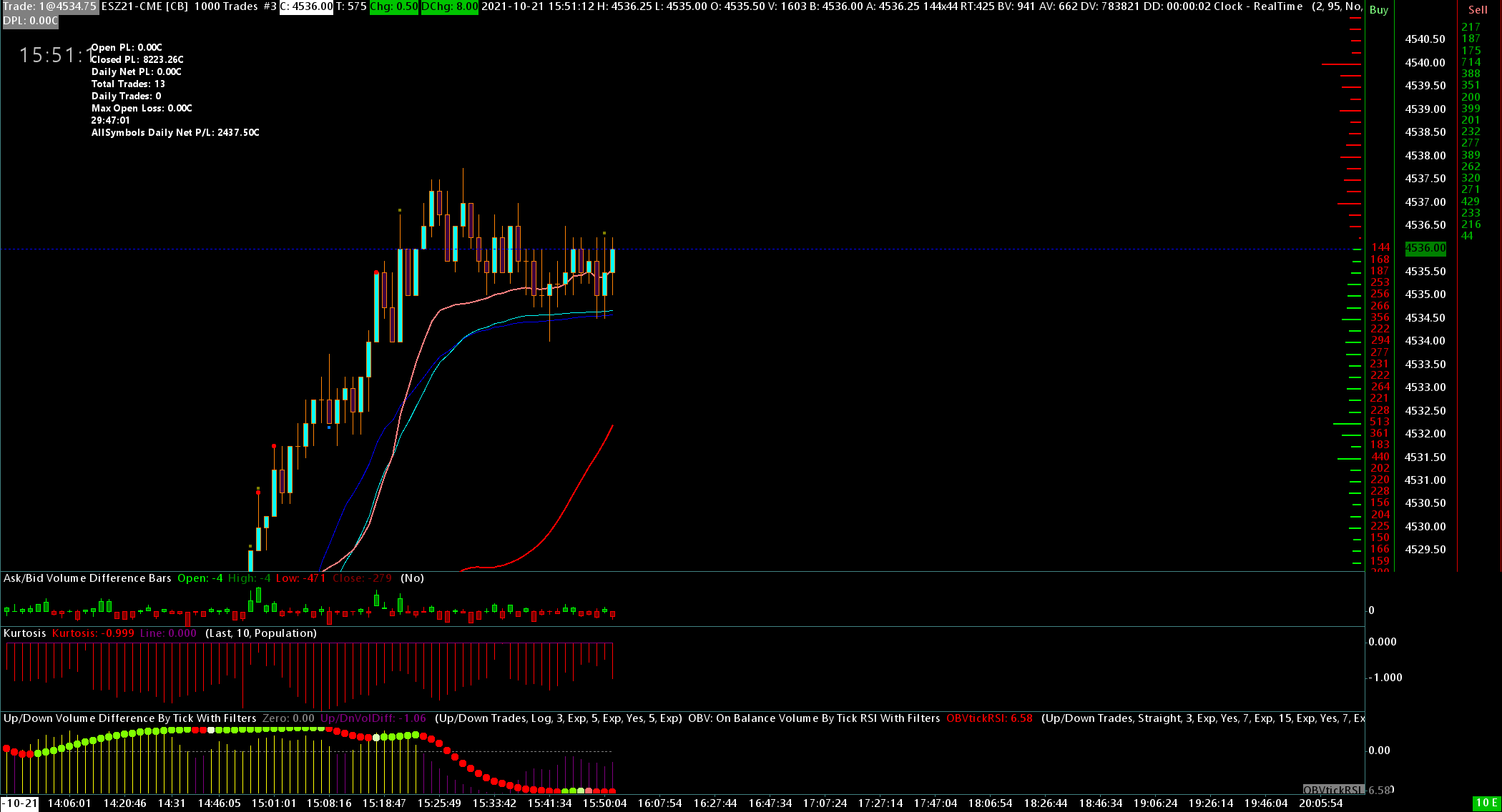

So, for whatever reason I just had the DOM populate on ONE of my instances. It's a sub instance for one of the parents i have. No idea how, no idea why. But here's the screenshot.
http://www.sierrachart.com/image.php?Image=1634845876717.png
