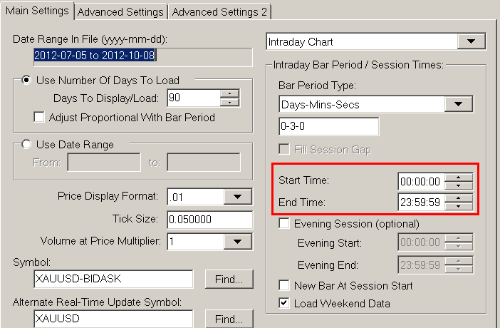

3.3 - Session Start Time and End Time not Covering Current Time
An Intraday chart will be blank, or will not update in real time or not update during a replay if the Start Time and End Time in the Chart Settings window do not cover some of the time period when there has been trading and the time period that trading is currently occurring at. Select Chart >> Chart Settings on the menu to open this window. To see if this might be the problem, set the Start Time to 0:00:00 and the End Time to 23:59:59 anyway, even if you think this is not the issue.
For additional information, refer to Session Times on the Chart Settings page.
These times must be relative to the Time Zone setting in Global Settings >> Data/Trade Service Settings. Make sure the Time Zone setting is set as you expect.

3.17 - Weekend Data and Chart Not Set to Load Weekend Data
An Intraday chart will not update in real-time or during a chart replay if the date of the most recent data in the chart is on a weekend or considered a weekend, and the Load Weekend Data option in Chart Settings is set to not load Saturday or Sunday data.
The solution is to select Chart >> Chart Settings >> Main Settings. In the Session Times frame choose from the list of Load Weekend Data options, Load All Weekend Data. Press OK.
For additional information, refer to Load Weekend Data Setting.
