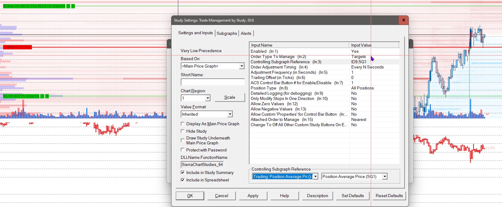

Would you tell me what I do wrong as this seems does not work for me.
I used study Trading: Avarage price study as a basis. It draws a line at average price following the new orders that I place. It seems to be aligned with break/even line that I see when I place a trades.
Then I add Trade Management by Study and set it to enabled. And make a reference to my study Avarage price.
I add then the trade management study to my control bar.
I expected that once I have some orders placed with bracket order for SL and TP and I enable the study then my Take profit lvl will be immediately adjusted to the value from the avarage price study. But it does not work...
I add screenshot from Trade Management Study. Will you be so kind and check what do I do wrong?
Thank you
imageTrade Management study.jpg / V - Attached On 2022-05-12 08:54:38 UTC - Size: 173.05 KB - 344 views

John - SC Support - Posts: 48495
Everything looks good. The only item of note is that you do not want to "Enable" the study until you are ready to move the Targets to the line. That is what the Control Bar button will do, it will Enable the study and then the targets will move.
From what you are showing, your Targets should be moving immediately when you add the study, or vice versa, depending on which one is entered first.
Make sure the study is working without the Control Bar Button first. Then add the control bar button functionality - that way you can determine where the issue lies.

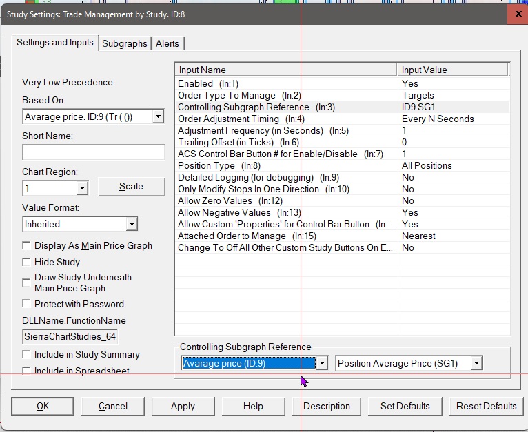

User308424 - Posts: 78
Hey John,
this is exactly what I do... and it does not work...
Controling Subgraph reference in Trade Management by study is Trading: Position Avarage price.
Order Type to manage: targets
I am set to adjust order in seconds, adjustment frequency is set to 1.
Trailing offset is 0.
Allowed zero and negative values is set to no (buy it did not work with yes too)
Is there any other setting which may overcontrol/prevent this?
The instruction you gave me is very simple to implement. I just cant get it working... for some reason. Would you agree that setting of a trade management by study is correct?? (see attached picture please).
image1.jpg / V - Attached On 2022-05-16 17:42:42 UTC - Size: 356.58 KB - 408 views
Everything looks good in terms of the setup.
This leads us to have to ask how you are adding the target Limit order? The Trade Management by Study only works with Attached Orders. If you are setting that target separate from the main order, then that would be why it is not adjusting.

[2022-05-17 14:22:25]
One more item to try.
On the Trade Management by Study there is an Input for Detailed Logging. Please set this to Yes, then go through the process to put on a trade and enable the Trade Management by Study and wait a minute to ensure that enough time has passed. Then copy and paste your Message Log to this thread by following these instructions:

Chart: ESM22 10 Sec #1 | Study: Trade Management by Study | Study not enabled. | 2022-05-17 09:54:04.328
Chart: ESM22 10 Sec #1 | Study: Trade Management by Study | Study not enabled. | 2022-05-17 09:54:08.253
Chart: ESM22 10 Sec #1 | Study: Trade Management by Study | Study not enabled. | 2022-05-17 09:54:09.070
Chart: ESM22 10 Sec #1 | Study: Trade Management by Study | Study not enabled. | 2022-05-17 09:54:10.424
Chart: ESM22 10 Sec #1 | Study: Trade Management by Study | There was an error modifying the Stop/Target order. Internal Order ID: 75414. New Price: 4035.750000. Error Code -8998. | 2022-05-17 09:54:59.587
Chart: ESM22 10 Sec #1 | Study: Trade Management by Study | 'Trade >> Auto Trading Enabled' is disabled. | 2022-05-17 09:55:00.290
Chart: ESM22 10 Sec #1 | Study: Trade Management by Study | Time interval has not elapsed yet for 'Every N Seconds'. | 2022-05-17 09:55:00.600
Chart: ESM22 10 Sec #1 | Study: Trade Management by Study | 'Trade >> Auto Trading Enabled' is disabled. | 2022-05-17 09:55:01.227
Chart: ESM22 10 Sec #1 | Study: Trade Management by Study | Time interval has not elapsed yet for 'Every N Seconds'. | 2022-05-17 09:55:01.538
Chart: ESM22 10 Sec #1 | Study: Trade Management by Study | 'Trade >> Auto Trading Enabled' is disabled. | 2022-05-17 09:55:02.478
Chart: ESM22 10 Sec #1 | Study: Trade Management by Study | Time interval has not elapsed yet for 'Every N Seconds'. | 2022-05-17 09:55:02.789
Chart: ESM22 10 Sec #1 | Study: Trade Management by Study | 'Trade >> Auto Trading Enabled' is disabled. | 2022-05-17 09:55:03.413
Chart: ESM22 10 Sec #1 | Study: Trade Management by Study | Time interval has not elapsed yet for 'Every N Seconds'. | 2022-05-17 09:55:03.702
Chart: ESM22 10 Sec #1 | Study: Trade Management by Study | Time interval has not elapsed yet for 'Every N Seconds'. | 2022-05-17 09:55:04.830
Chart: ESM22 10 Sec #1 | Study: Trade Management by Study | 'Trade >> Auto Trading Enabled' is disabled. | 2022-05-17 09:55:05.626
Chart: ESM22 10 Sec #1 | Study: Trade Management by Study | Time interval has not elapsed yet for 'Every N Seconds'. | 2022-05-17 09:55:06.106
Chart: ESM22 10 Sec #1 | Study: Trade Management by Study | 'Trade >> Auto Trading Enabled' is disabled. | 2022-05-17 09:55:07.189
Chart: ESM22 10 Sec #1 | Study: Trade Management by Study | There was an error modifying the Stop/Target order. Internal Order ID: 75414. New Price: 4035.750000. Error Code -8994. | 2022-05-17 09:55:09.085
Chart: ESM22 10 Sec #1 | Study: Trade Management by Study | Time interval has not elapsed yet for 'Every N Seconds'. | 2022-05-17 09:55:09.351
Chart: ESM22 10 Sec #1 | Study: Trade Management by Study | 'Trade >> Auto Trading Enabled' is disabled. | 2022-05-17 09:55:10.244
Chart: ESM22 10 Sec #1 | Study: Trade Management by Study | Time interval has not elapsed yet for 'Every N Seconds'. | 2022-05-17 09:55:11.145
Chart: ESM22 10 Sec #1 | Study: Trade Management by Study | 'Trade >> Auto Trading Enabled' is disabled. | 2022-05-17 09:55:11.519
Chart: ESM22 10 Sec #1 | Study: Trade Management by Study | Time interval has not elapsed yet for 'Every N Seconds'. | 2022-05-17 09:55:11.650
Chart: ESM22 10 Sec #1 | Study: Trade Management by Study | 'Trade >> Auto Trading Enabled' is disabled. | 2022-05-17 09:55:12.580
Chart: ESM22 10 Sec #1 | Study: Trade Management by Study | Time interval has not elapsed yet for 'Every N Seconds'. | 2022-05-17 09:55:12.820
Chart: ESM22 10 Sec #1 | Study: Trade Management by Study | 'Trade >> Auto Trading Enabled' is disabled. | 2022-05-17 09:55:13.863
Chart: ESM22 10 Sec #1 | Study: Trade Management by Study | Time interval has not elapsed yet for 'Every N Seconds'. | 2022-05-17 09:55:14.140
Chart: ESM22 10 Sec #1 | Study: Trade Management by Study | 'Trade >> Auto Trading Enabled' is disabled. | 2022-05-17 09:55:15.186
Chart: ESM22 10 Sec #1 | Study: Trade Management by Study | Time interval has not elapsed yet for 'Every N Seconds'. | 2022-05-17 09:55:15.328
Chart: ESM22 10 Sec #1 | Study: Trade Management by Study | 'Trade >> Auto Trading Enabled' is disabled. | 2022-05-17 09:55:16.267
Chart: ESM22 10 Sec #1 | Study: Trade Management by Study | Time interval has not elapsed yet for 'Every N Seconds'. | 2022-05-17 09:55:16.683
Chart: ESM22 10 Sec #1 | Study: Trade Management by Study | 'Trade >> Auto Trading Enabled' is disabled. | 2022-05-17 09:55:17.625
Chart: ESM22 10 Sec #1 | Study: Trade Management by Study | Time interval has not elapsed yet for 'Every N Seconds'. | 2022-05-17 09:55:17.819
Chart: ESM22 10 Sec #1 | Study: Trade Management by Study | 'Trade >> Auto Trading Enabled' is disabled. | 2022-05-17 09:55:18.561
Chart: ESM22 10 Sec #1 | Study: Trade Management by Study | Time interval has not elapsed yet for 'Every N Seconds'. | 2022-05-17 09:55:18.873
Chart: ESM22 10 Sec #1 | Study: Trade Management by Study | 'Trade >> Auto Trading Enabled' is disabled. | 2022-05-17 09:55:19.809
Chart: ESM22 10 Sec #1 | Study: Trade Management by Study | Time interval has not elapsed yet for 'Every N Seconds'. | 2022-05-17 09:55:20.007
Chart: ESM22 10 Sec #1 | Study: Trade Management by Study | 'Trade >> Auto Trading Enabled' is disabled. | 2022-05-17 09:55:20.742
Chart: ESM22 10 Sec #1 | Study: Trade Management by Study | Time interval has not elapsed yet for 'Every N Seconds'. | 2022-05-17 09:55:21.057
Chart: ESM22 10 Sec #1 | Study: Trade Management by Study | 'Trade >> Auto Trading Enabled' is disabled. | 2022-05-17 09:55:21.941
Chart: ESM22 10 Sec #1 | Study: Trade Management by Study | Time interval has not elapsed yet for 'Every N Seconds'. | 2022-05-17 09:55:22.307
Chart: ESM22 10 Sec #1 | Study: Trade Management by Study | 'Trade >> Auto Trading Enabled' is disabled. | 2022-05-17 09:55:23.839
Chart: ESM22 10 Sec #1 | Study: Trade Management by Study | Time interval has not elapsed yet for 'Every N Seconds'. | 2022-05-17 09:55:24.085
Chart: ESM22 10 Sec #1 | Study: Trade Management by Study | 'Trade >> Auto Trading Enabled' is disabled. | 2022-05-17 09:55:24.884
Chart: ESM22 10 Sec #1 | Study: Trade Management by Study | Time interval has not elapsed yet for 'Every N Seconds'. | 2022-05-17 09:55:25.125
Chart: ESM22 10 Sec #1 | Study: Trade Management by Study | 'Trade >> Auto Trading Enabled' is disabled. | 2022-05-17 09:55:25.944
Chart: ESM22 10 Sec #1 | Study: Trade Management by Study | Time interval has not elapsed yet for 'Every N Seconds'. | 2022-05-17 09:55:26.369
Chart: ESM22 10 Sec #1 | Study: Trade Management by Study | 'Trade >> Auto Trading Enabled' is disabled. | 2022-05-17 09:55:26.995
Chart: ESM22 10 Sec #1 | Study: Trade Management by Study | Time interval has not elapsed yet for 'Every N Seconds'. | 2022-05-17 09:55:27.305
Chart: ESM22 10 Sec #1 | Study: Trade Management by Study | 'Trade >> Auto Trading Enabled' is disabled. | 2022-05-17 09:55:28.244
Chart: ESM22 10 Sec #1 | Study: Trade Management by Study | Time interval has not elapsed yet for 'Every N Seconds'. | 2022-05-17 09:55:28.445
Chart: ESM22 10 Sec #1 | Study: Trade Management by Study | 'Trade >> Auto Trading Enabled' is disabled. | 2022-05-17 09:55:29.384
Chart: ESM22 10 Sec #1 | Study: Trade Management by Study | Time interval has not elapsed yet for 'Every N Seconds'. | 2022-05-17 09:55:29.805
Chart: ESM22 10 Sec #1 | Study: Trade Management by Study | 'Trade >> Auto Trading Enabled' is disabled. | 2022-05-17 09:55:30.744
Chart: ESM22 10 Sec #1 | Study: Trade Management by Study | Time interval has not elapsed yet for 'Every N Seconds'. | 2022-05-17 09:55:31.053
Chart: ESM22 10 Sec #1 | Study: Trade Management by Study | 'Trade >> Auto Trading Enabled' is disabled. | 2022-05-17 09:55:31.991
Chart: ESM22 10 Sec #1 | Study: Trade Management by Study | Time interval has not elapsed yet for 'Every N Seconds'. | 2022-05-17 09:55:32.305
Chart: ESM22 10 Sec #1 | Study: Trade Management by Study | 'Trade >> Auto Trading Enabled' is disabled. | 2022-05-17 09:55:32.890
Chart: ESM22 10 Sec #1 | Study: Trade Management by Study | Time interval has not elapsed yet for 'Every N Seconds'. | 2022-05-17 09:55:33.188
Chart: ESM22 10 Sec #1 | Study: Trade Management by Study | 'Trade >> Auto Trading Enabled' is disabled. | 2022-05-17 09:55:34.181
Chart: ESM22 10 Sec #1 | Study: Trade Management by Study | Time interval has not elapsed yet for 'Every N Seconds'. | 2022-05-17 09:55:34.382
Chart: ESM22 10 Sec #1 | Study: Trade Management by Study | 'Trade >> Auto Trading Enabled' is disabled. | 2022-05-17 09:55:35.635
Chart: ESM22 10 Sec #1 | Study: Trade Management by Study | Time interval has not elapsed yet for 'Every N Seconds'. | 2022-05-17 09:55:35.945
Chart: ESM22 10 Sec #1 | Study: Trade Management by Study | 'Trade >> Auto Trading Enabled' is disabled. | 2022-05-17 09:55:36.995
Chart: ESM22 10 Sec #1 | Study: Trade Management by Study | Time interval has not elapsed yet for 'Every N Seconds'. | 2022-05-17 09:55:37.194
Chart: ESM22 10 Sec #1 | Study: Trade Management by Study | 'Trade >> Auto Trading Enabled' is disabled. | 2022-05-17 09:55:38.134
Chart: ESM22 10 Sec #1 | Study: Trade Management by Study | Time interval has not elapsed yet for 'Every N Seconds'. | 2022-05-17 09:55:38.554
Chart: ESM22 10 Sec #1 | Study: Trade Management by Study | 'Trade >> Auto Trading Enabled' is disabled. | 2022-05-17 09:55:39.694
Chart: ESM22 10 Sec #1 | Study: Trade Management by Study | Time interval has not elapsed yet for 'Every N Seconds'. | 2022-05-17 09:55:40.010
Chart: ESM22 10 Sec #1 | Study: Trade Management by Study | 'Trade >> Auto Trading Enabled' is disabled. | 2022-05-17 09:55:41.053
Chart: ESM22 10 Sec #1 | Study: Trade Management by Study | Time interval has not elapsed yet for 'Every N Seconds'. | 2022-05-17 09:55:41.256
Chart: ESM22 10 Sec #1 | Study: Trade Management by Study | 'Trade >> Auto Trading Enabled' is disabled. | 2022-05-17 09:55:41.885
Chart: ESM22 10 Sec #1 | Study: Trade Management by Study | Time interval has not elapsed yet for 'Every N Seconds'. | 2022-05-17 09:55:42.193
Chart: ESM22 10 Sec #1 | Study: Trade Management by Study | 'Trade >> Auto Trading Enabled' is disabled. | 2022-05-17 09:55:43.244
Chart: ESM22 10 Sec #1 | Study: Trade Management by Study | Time interval has not elapsed yet for 'Every N Seconds'. | 2022-05-17 09:55:43.444
Chart: ESM22 10 Sec #1 | Study: Trade Management by Study | 'Trade >> Auto Trading Enabled' is disabled. | 2022-05-17 09:55:44.069
Chart: ESM22 10 Sec #1 | Study: Trade Management by Study | Time interval has not elapsed yet for 'Every N Seconds'. | 2022-05-17 09:55:44.385
Chart: ESM22 10 Sec #1 | Study: Trade Management by Study | 'Trade >> Auto Trading Enabled' is disabled. | 2022-05-17 09:55:45.317
Chart: ESM22 10 Sec #1 | Study: Trade Management by Study | Time interval has not elapsed yet for 'Every N Seconds'. | 2022-05-17 09:55:45.932
Chart: ESM22 10 Sec #1 | Study: Trade Management by Study | 'Trade >> Auto Trading Enabled' is disabled. | 2022-05-17 09:55:46.749
Chart: ESM22 10 Sec #1 | Study: Trade Management by Study | Time interval has not elapsed yet for 'Every N Seconds'. | 2022-05-17 09:55:47.577
Chart: ESM22 10 Sec #1 | Study: Trade Management by Study | 'Trade >> Auto Trading Enabled' is disabled. | 2022-05-17 09:55:47.790
Chart: ESM22 10 Sec #1 | Study: Trade Management by Study | Time interval has not elapsed yet for 'Every N Seconds'. | 2022-05-17 09:55:48.342
Chart: ESM22 10 Sec #1 | Study: Trade Management by Study | 'Trade >> Auto Trading Enabled' is disabled. | 2022-05-17 09:55:49.150
Chart: ESM22 10 Sec #1 | Study: Trade Management by Study | Time interval has not elapsed yet for 'Every N Seconds'. | 2022-05-17 09:55:49.979
Chart: ESM22 10 Sec #1 | Study: Trade Management by Study | 'Trade >> Auto Trading Enabled' is disabled. | 2022-05-17 09:55:50.291
Chart: ESM22 10 Sec #1 | Study: Trade Management by Study | Time interval has not elapsed yet for 'Every N Seconds'. | 2022-05-17 09:55:50.604
Chart: ESM22 10 Sec #1 | Study: Trade Management by Study | 'Trade >> Auto Trading Enabled' is disabled. | 2022-05-17 09:55:51.538
Chart: ESM22 10 Sec #1 | Study: Trade Management by Study | Time interval has not elapsed yet for 'Every N Seconds'. | 2022-05-17 09:55:51.851
Chart: ESM22 10 Sec #1 | Study: Trade Management by Study | 'Trade >> Auto Trading Enabled' is disabled. | 2022-05-17 09:55:52.790
Chart: ESM22 10 Sec #1 | Study: Trade Management by Study | Time interval has not elapsed yet for 'Every N Seconds'. | 2022-05-17 09:55:53.101
Chart: ESM22 10 Sec #1 | Study: Trade Management by Study | 'Trade >> Auto Trading Enabled' is disabled. | 2022-05-17 09:55:54.041
Chart: ESM22 10 Sec #1 | Study: Trade Management by Study | Time interval has not elapsed yet for 'Every N Seconds'. | 2022-05-17 09:55:55.005
Chart: ESM22 10 Sec #1 | Study: Trade Management by Study | 'Trade >> Auto Trading Enabled' is disabled. | 2022-05-17 09:55:55.625

[2022-05-17 16:16:44]
Very good you figured out what the issue was.
Unfortunately, Trade MAnagement by Study remains enabled after my bracket orders are closed and when I place new order it immediatly moves the TP bracket order to break even.
Is there an option to disable the study automatically after the execution?
No, there is not an automatic way to disable the study, but that is what the Control Bar Button option is for. You can add a Control Bar Button to Enable and Disable the study. Refer to the information here:
Attached Orders: Instructions
[2022-05-17 16:38:42]
Thank you John, appreciate your assistance with the topic. Have a great day.
