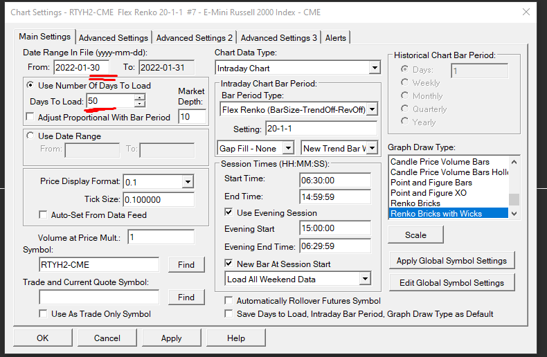

Hi - I have been using SC with Rithmic for over a year, and haven't changed any settings in months. Today when I logged in I could not load historical data. Current data is coming through, but my intraday and profile charts are blank. I tried all of the steps in the documentation and they did not work.
When looking at chart settings, when I try to load 50 days of data, it will not allow the "From" field to go earlier then 1/30/22 (see attatchement)
How do I resolve this?

To solve this you need to activate the exchanges that you require here:
When that is done re-download the data:
Re-download all the data in the chart by going to the chart and selecting "Edit >> Delete All Data and Download". You just need to do this once per symbol and not for each chart.
For background information on this issue, refer to:
Rithmic Trading Platform Service: Rithmic Support Policy (Be sure to read that section)
You are also using the old Rithmic bridge program which is unsupported. You really need to update to the current version:

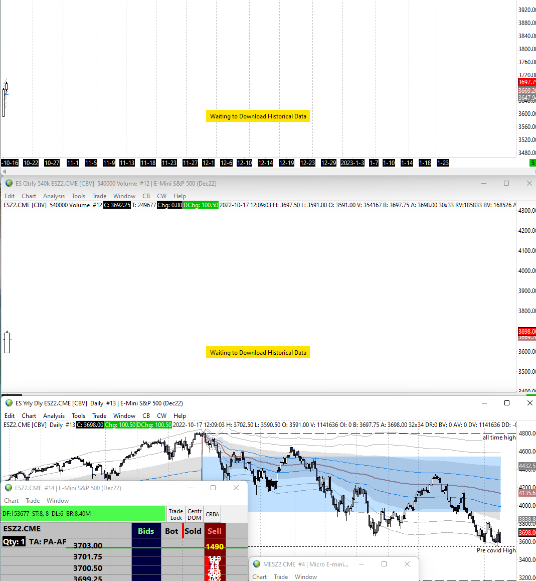

I will add I can see historical data on my daily chart as shown in picture but not on any of my other cahrts which doesn't make sense right??
I have actually upgraded my package to package 11 advanced to see if renewed to a different package. Still the same error. I would like this sorted out please asap and refunded.

Just loaded up my Sierra chart like I always do and none of the data has loaded up since I logged out from that spot Friday morning, and then gapped to today's new prices.
I have refreshed the charts and when I did that it actually took away another 2 days so now missing the last 2 days data!
I have noticed sierra did take a payment off me last 24 hours. So I am wondering if the package I have has changed and I need a different one? for the record, I trade ES on CME via apex trader (rithmic)

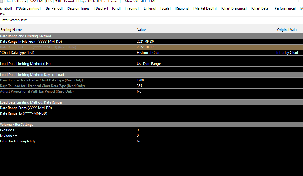

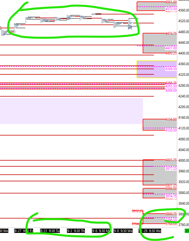

I am missing a huge gap for the last few months of data but on my TPO charts. And cant see any historical data on my 5min ES candle chart and it just started at the point where I log in each time... and some of my charts just has 3 previous days missing and can go way back on them. This is clearly a Sierra chart issue that needs sorting ASAP - I need someone to sieraa to call me and do a remote access so I can show what I mean as it was working but your last message says it would be impossible
I have attached my TPO where I have historic data form 2 years ago until september 2021 then it stops and jump to today's TPO and misses everything. Why?
Also attached the chart settings where loads have all been greyed out and cant change. I must note if I move back to SC all data delayed everyone works fine.

We can not say why things were working previously. But from what we see of your account, you would have been getting the Rithmic data previously and you are still doing so. Therefore, the issue you are having is related to the Rithmic data. Refer to the following:
We do see that you had setup the Denali Exchange Data Feed for CME data, but the problem is that the CME Group has a requirement that you have a live, funded, futures trading account to which you can connect Sierra Chart in order to qualify for the non-professional exchange fees. A prop firm account (such as Apex) does not count towards this requirement. Refer to the following for more information on this:
Real-Time Exchange Data Feeds Available From Sierra Chart: Understanding and Accessing Data From the CME, CBOT, NYMEX, COMEX Exchanges
If you do not have another account that will qualify for this purpose, then we recommend the solution outlined at the following link:
Easy Solution to CME Funded Trading Account Requirement
Once you start getting the Denali data, then you can "Delete All Data and Download" and everything will fill in with our historical data.
