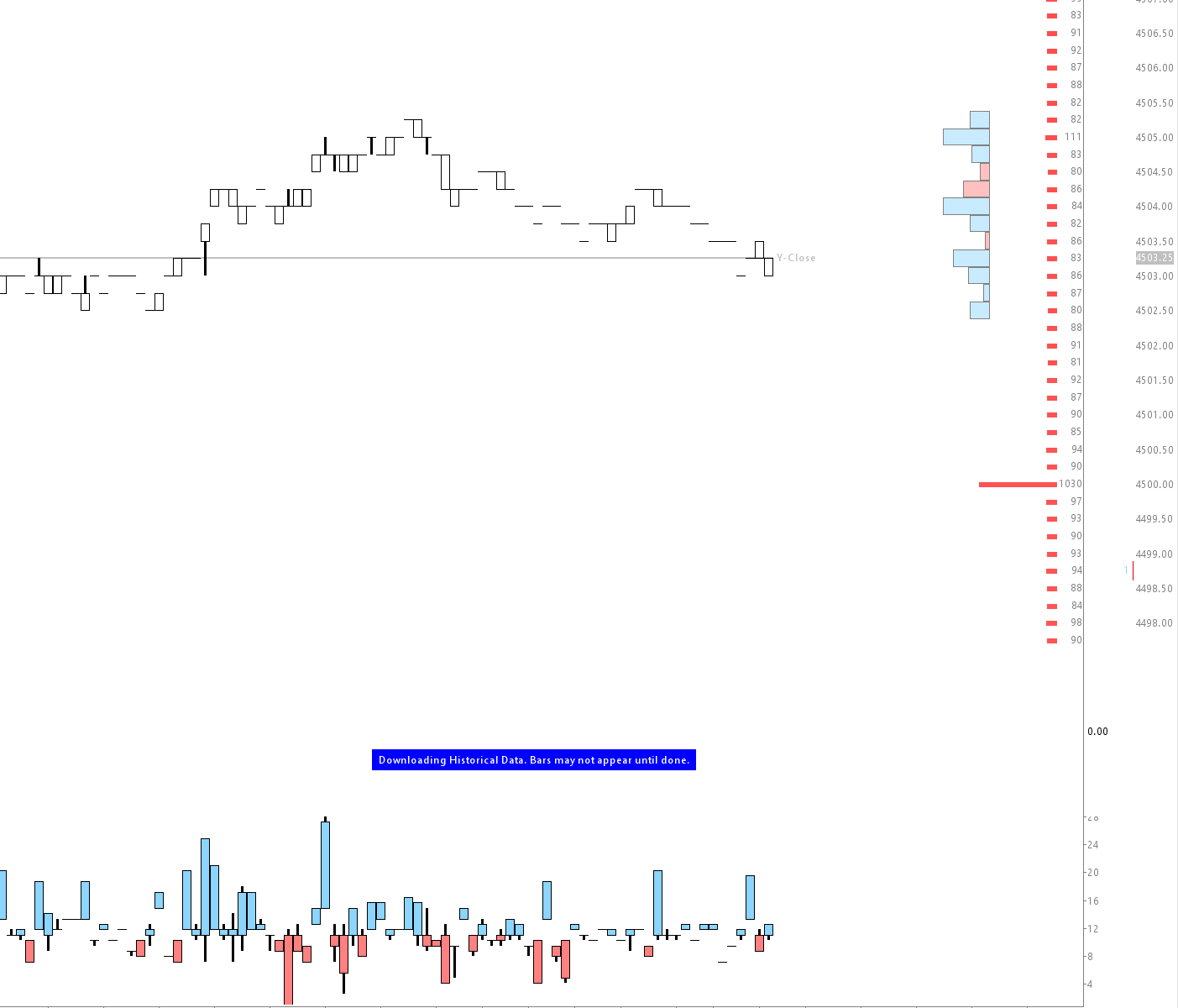

I have the same issue this morning. Stuck on Downloading Historical Date. Rithmic.
imageCapture.PNG / V - Attached On 2021-10-18 11:20:50 UTC - Size: 42.75 KB - 401 views

Assuming you require CME Group data, first complete the exchange agreements:
https://www.sierrachart.com/UserControlPanel.php?page=ExchangeAgreements
And then activate the exchange or exchanges that you need here:
[2021-10-18 12:59:20]

Yes you cannot rely on Rithmic historical data. You need to cancel the exchange fees you are paying through AMP. You do not need to pay twice.
