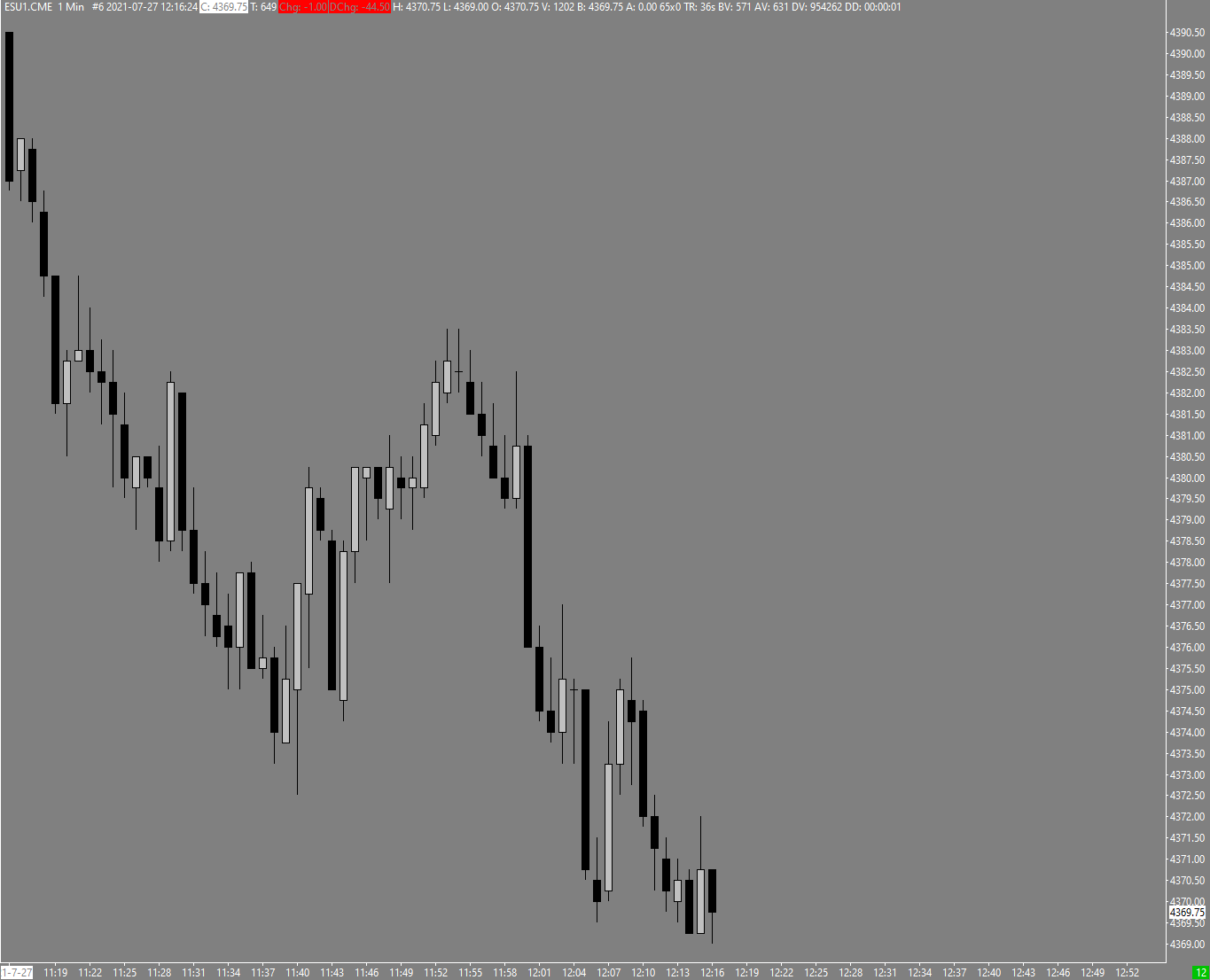

I have followed all of the instructions from the prior messages (enabled Denali, signed agreement, enabled CME data, Delete and Download data) above and still have the data issue. I have some data from today, then it skips back to June 9?

Can you please show us an image of what you are seeing by following these instructions: Support Board Posting Information: Attaching or Posting a Screenshot/Image (Optional) For the most reliable, advanced, and zero cost futures order routing, use the Teton service: Sierra Chart Teton Futures Order Routing |
| [2021-07-27 16:18:23] |
| 12VMan - Posts: 58 |
Sure, here it is: http://www.sierrachart.com/image.php?Image=1627402585729.png Note, I tried shutting my PC all the way down and restarting to see if anything changed. Now, instead of having a gap from today's data to 6/9 data, I am now only getting some of today's data. |
| [2021-07-27 16:25:21] |
| John - SC Support - Posts: 48459 |
Go to File >> Data/Trade Service Settings >> Common Settings and ensure that the option for Allow Support for Sierra Chart Data Feeds is set to Yes. It does not appear that this is the case from what you showed us. If you have to change this from No to Yes, then be sure you then selected File >> Disconnect, followed by file >> Connect to Data Feed, then select Edit >> Delete All Data and Download. For the most reliable, advanced, and zero cost futures order routing, use the Teton service: Sierra Chart Teton Futures Order Routing |
It is set to yes so that does not appear to be the issue
