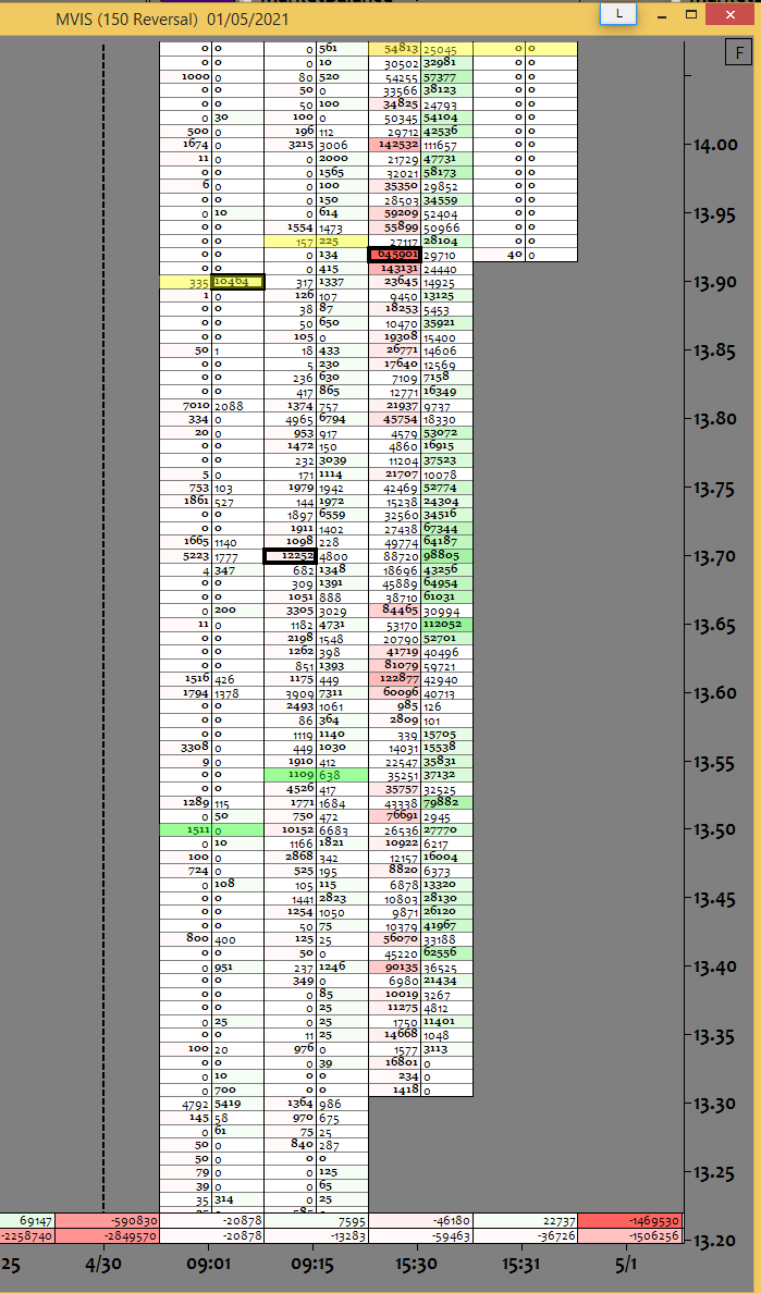

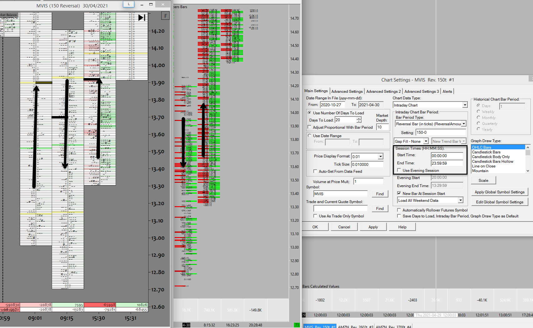

Trying to replicate my Ninjatrader charts.
1- How do I set the charts to a default of 24/7 like my Ninja?
So that the reversal chart is able to plot Exactly like the attached Ninja chart?
2- How do I plot the footprint chart to show the number like 20,000K/0?
3- How do I highlight the dominant side?
4- I don,t know if my data is connected to real-time Stocks and Futures currency data?
5- Is the reversal in sierra plotted correctly?
image2021-05-01_2245.png / V - Attached On 2021-05-01 21:49:54 UTC - Size: 1.15 MB - 470 views
[2021-05-02 20:29:39]
John - SC Support - Posts: 48480
1. In order to ensure you have the 24 hours of data, you need to ensure that your Session Times are set to cover the 24 hour period. Refer to the following:
Chart Session Times
2. In the Numbers Bars study there is an Input for Use Large Volume Number Formatting. Set this to Yes to get the K and M suffix on numbers greater than 10,000. Refer to the following:
Numbers Bars: Use Large Volume Number Formatting
3. There are a lot of ways to do this. It depends on what you are looking for. But, refer to this setting and the option Background on Dominant Side to start with:
Numbers Bars: Numbers Bars Background Types
4. You are not setup to get any data from us. Therefore, you would need to check with your broker to see if you are getting real-time data from them.
5. Yes, we handle the reversals properly.

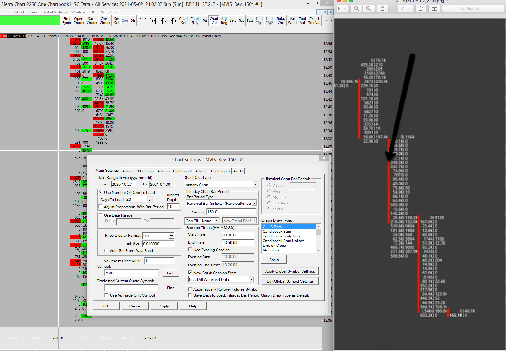

[2021-05-02 21:15:05]

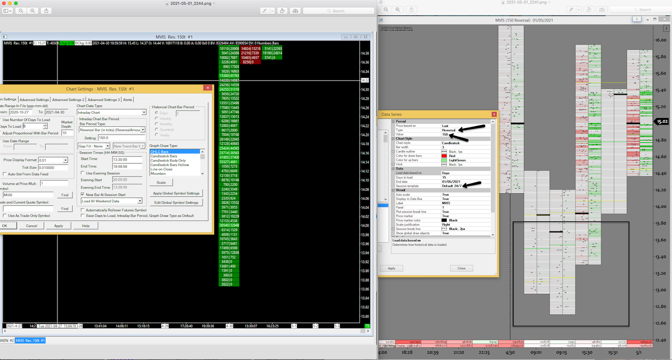

User840004 - Posts: 30
1- I don,t get data from my broker Tradestation. I will need real-time data for Non-Pro? Stock/Futures currency
2- Is my Reversal chart set up properly?
3- How do I plot the candlestick by the footprint?
4- My Ninja and Sierra Reversal 150 are different, did I miss something?
image2021-05-02_2209.png / V - Attached On 2021-05-02 21:12:00 UTC - Size: 540.69 KB - 462 views
image2021-05-02_2202.png / V - Attached On 2021-05-02 21:12:39 UTC - Size: 432.58 KB - 390 views
[2021-05-02 21:50:51]
1. If you want to get data from us, then we need to first know what trading service are you using with Tradestation? Do they have you setup to use CQG?
2. As far as we can tell your Reversal Bars are setup properly. Just keep in mind that you have a 150 reversal with a 0 Minimum Length. That Minimum Length could be the reason for differences you are seeing.
3. Refer to the following:
Numbers Bars: Drawing Open to Close Boxes on Side of Numbers Bar
4. Hard to say. First, refer to what we state in #2 above. Second, the data can be different depending on the vendors, so you may not be able to get them to be 100% the same, nor should you look for that. Just make sure that you have the settings the way you want them to be to create the bars that you want.

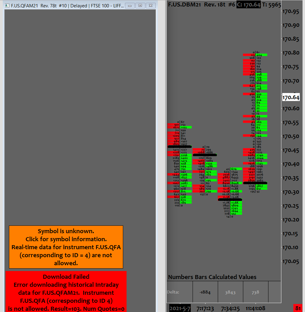

1- I have real-time data for FTSE but I get this message when I try downloading data. Amp side they don't know why that is happening and for One week have not had any data for the FTSE.

1. When you receive that kind of message, it means that CQG is telling you that you are not authorized to get that data. Keep in mind that you are wanting data from the LIFFE (London International Financial Futures and Options Exchange) for the symbol you are showing. Make sure you have that exchange activated and not the actual FTSE itself.

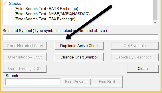

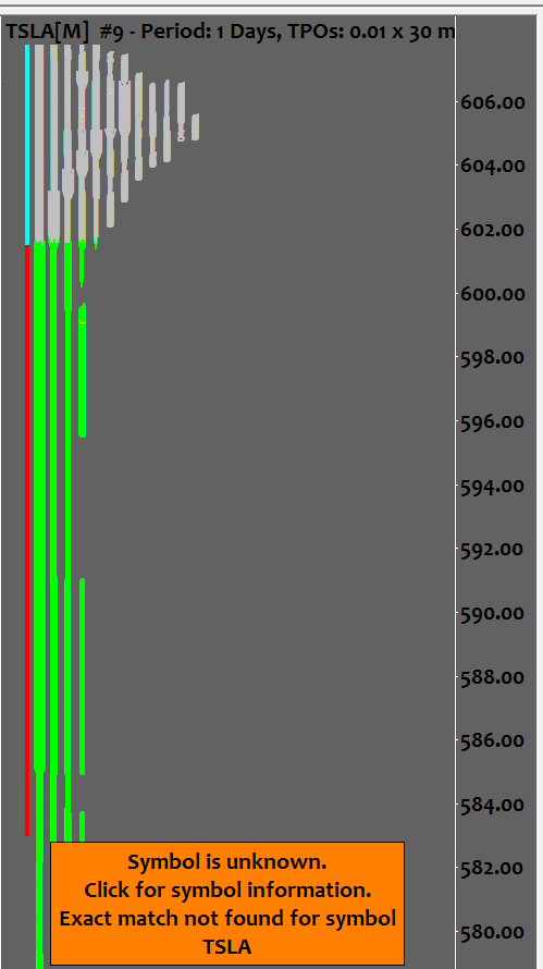

Why does my Tesla data give an error message?
Second, the Amazon chart says it is Delayed, why is that the case?
image2021-05-12_1033.png / V - Attached On 2021-05-12 09:34:33 UTC - Size: 316.23 KB - 359 views
image2021-05-12_0903.png / V - Attached On 2021-05-12 09:34:49 UTC - Size: 49.8 KB - 383 views
[2021-05-12 09:39:36]
This is the section I use for plotting stock charts.
image2021-05-12_1038.png / V - Attached On 2021-05-12 09:39:26 UTC - Size: 28.16 KB - 447 views
[2021-05-12 15:13:27]
With regards to AMZN, it depends on what time of day it was. If that was during a trading halt, then that is why and it would correct when the trading started again. If, that is not the case, then it implies that you are having an issue with the connection to the data feed at that time. If you are continuing to see this, then we would need to see your Message Log:
Open a chart for the symbol you have an issue with. Tell us that symbol of the chart.
With regards to TSLA, we do not know why you are getting that. We need to see the Message Log when that occurs. Follow the same instructions as above, but for the TSLA symbol.

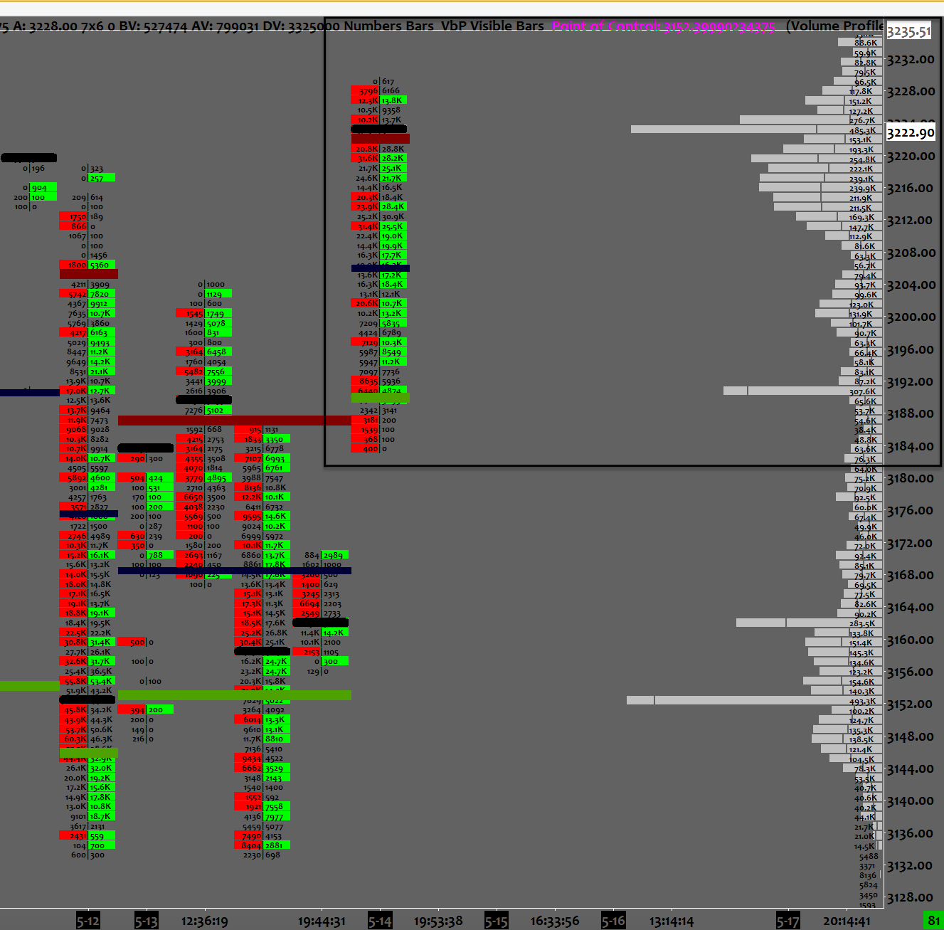

How do i set the volume profile to only show the volume for the currecnt session?
image2021-05-16_1633.png / V - Attached On 2021-05-16 15:35:45 UTC - Size: 242.07 KB - 425 views
[2021-05-17 07:49:29]
You need to set the Volume Graph Period Type Input with the Volume by Price study to what you specifically require and then follow the relevant instructions for that type:

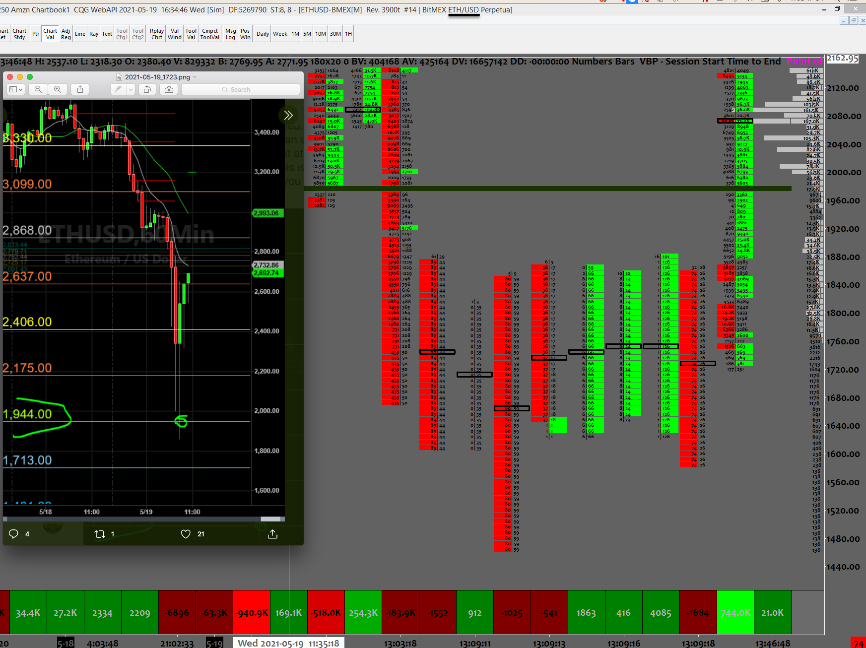

Hello, I am trying to get Eth/Usd data.
The chart on the left is my TradeStation but the sierra chart does not match it?
What exactly have I got wrong?
image2021-05-19_1735.png / V - Attached On 2021-05-19 16:36:49 UTC - Size: 421.49 KB - 412 views
[2021-05-19 17:06:59]
It is very difficult to compare different systems, as there are too many possible settings to check. In general, refer to the following:

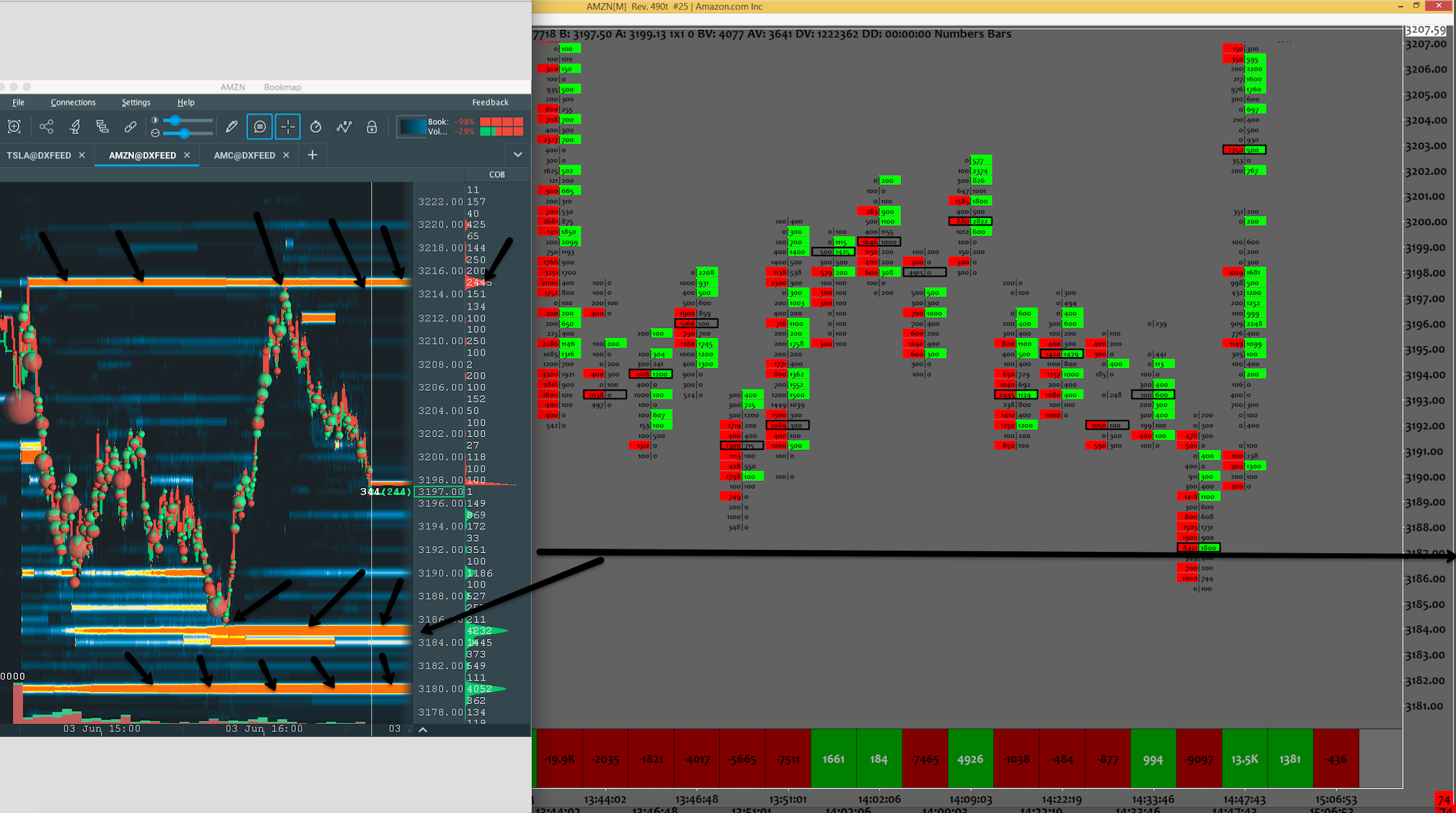

Do you have a feature on your charts of showing resting limit orders on the footprint charts like the bookmap charts?
If not that is an upgrade that will help traders and you will notice how it pinpoints the top and bottom of the range.
image2021-06-03_1640.png / V - Attached On 2021-06-03 15:45:46 UTC - Size: 1.25 MB - 403 views
[2021-06-04 08:34:56]
What you are asking about is market depth data for stocks, and that is coming.
Once that is available you will want to use these features:
https://www.sierrachart.com/index.php?page=doc/StudiesReference.php&ID=375#Market_Depth_Historical_Graph

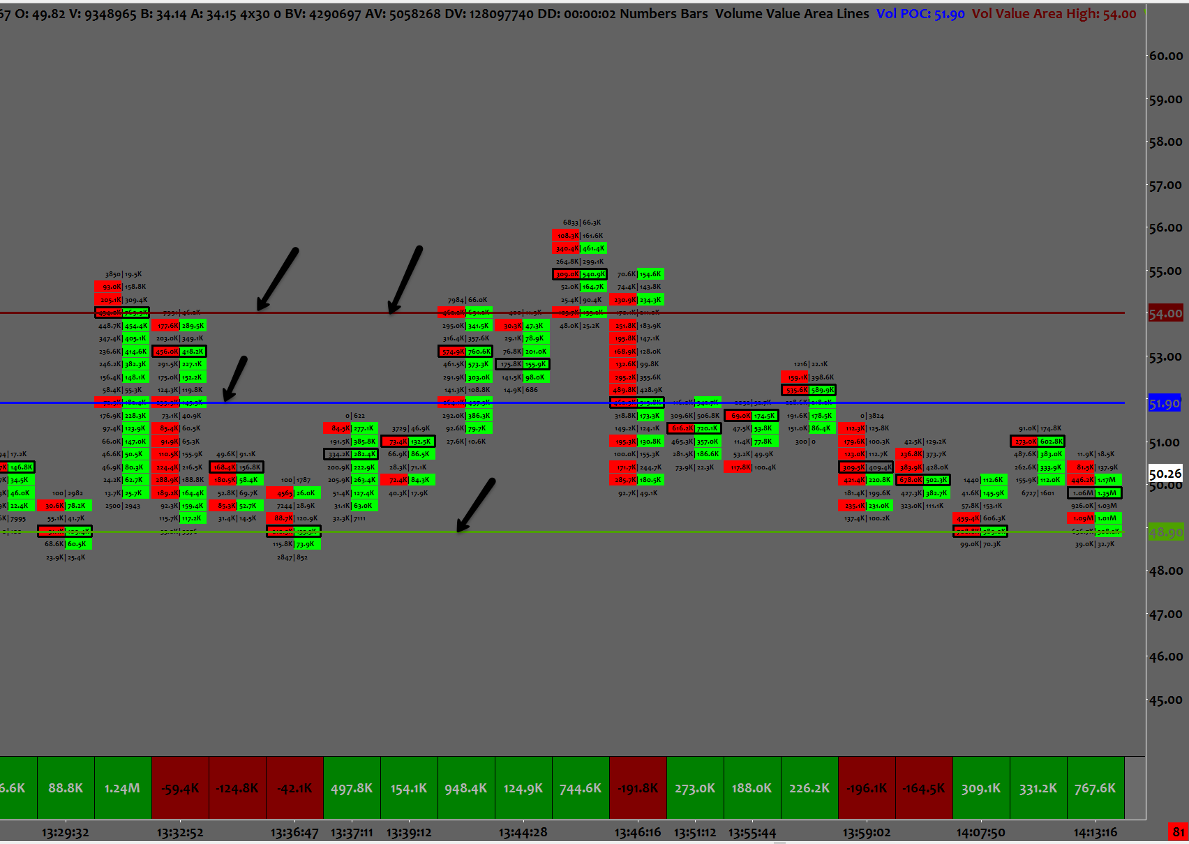

Hello, I want the value area lines under ( Not on top )the footprint charts, how do I do that?
image2021-07-17_0000.png / V - Attached On 2021-07-16 23:03:36 UTC - Size: 160.5 KB - 318 views
[2021-07-26 13:37:39]
Refer to the following information:
Chart Studies: Study Display Order

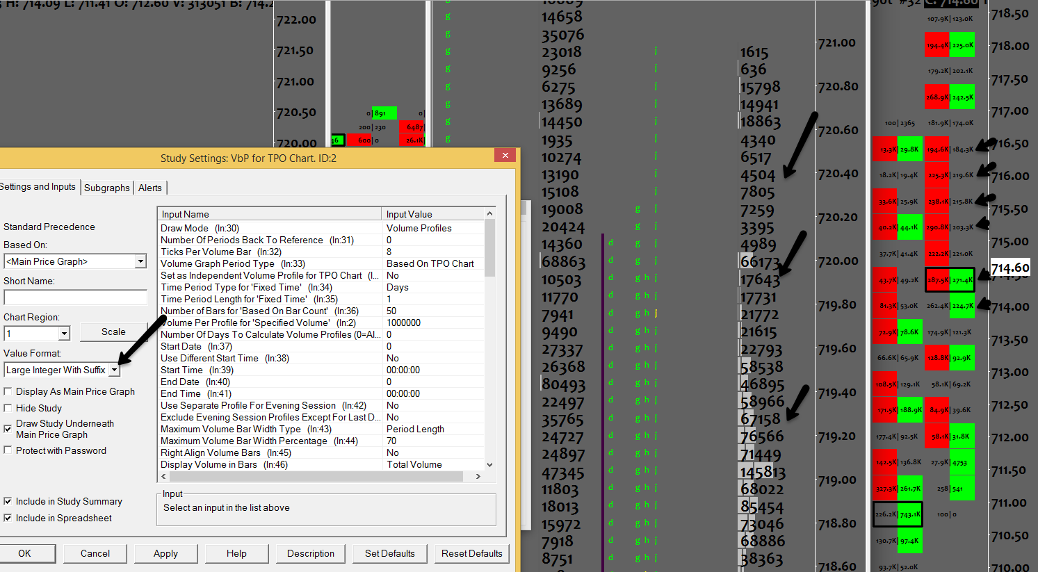

Hello, how do I plot the K on the Volume profile Vol Numbers on the Market profile chart?
Just like the example in the footprint chart.
