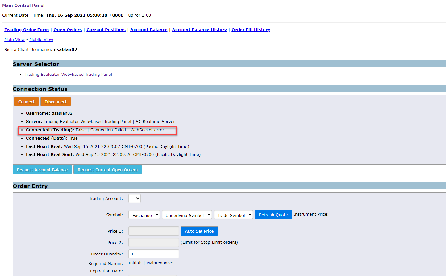

[2021-09-16 05:13:55]
DavidS_1 - Posts: 27
Ok thanks. and yea I have been to that page before but when I click on the 'trading account' drop down, nothing is displayed. Also clicking on 'connect' doesn't change anything. Any ideas?

[2021-09-16 14:20:45]
John - SC Support - Posts: 48044
Have you setup an account for the Trading Evaluator? The instructions to create an account are here:
Simulated Futures Trading Service: Setup Instructions
[2021-09-16 14:58:55]
Regarding post #14, there is a connection error, and that relates to an expired certificate. We will get that updated later today.
[2021-09-17 01:19:13]
Hi there, has the certificate been updated?
[2021-09-17 01:58:37]
Yes it has now been updated
[2021-09-17 03:44:59]
I am still having issues. the same picture I sent in post #14 is what is still currently happening.
Under connected (trading) is still states 'False'. On the drop-down tab for the trading account, it is still blank.
[2021-09-17 20:32:09]
Sierra_Chart Engineering - Posts: 25001
We apologize for the continued issue. This is now resolved. Reload the trading webpage and press the Connect button.
