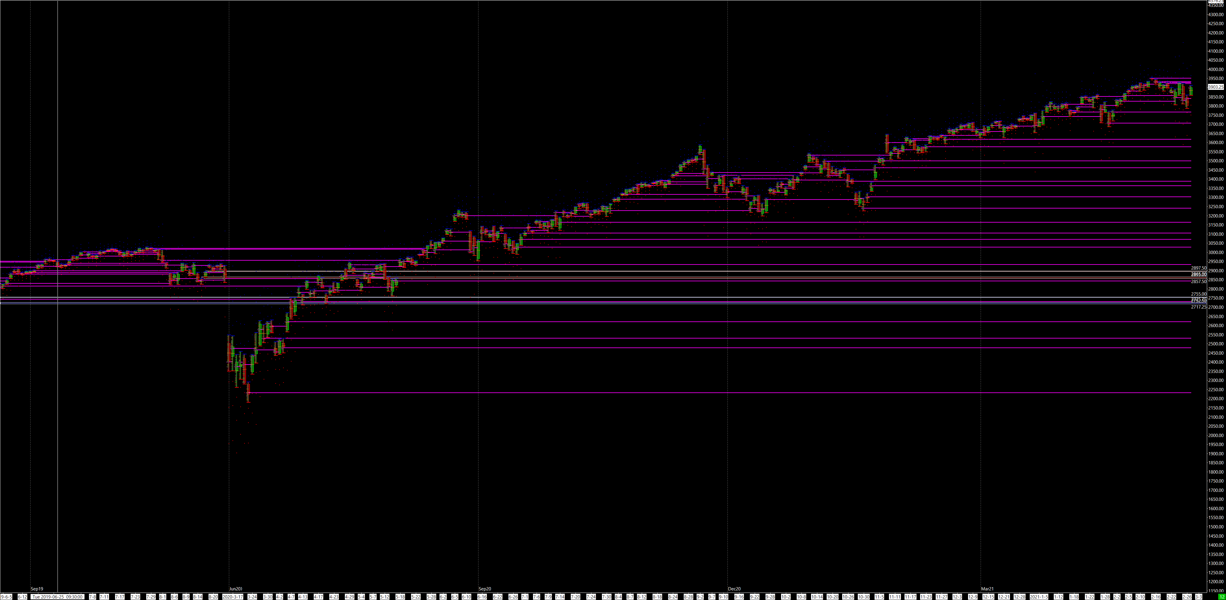

Hi I just switched to subscibing to Sierra Charts directly instead of through Amp. I am trying the Denali feed but I'm trying to pullup an intraday chart on a daily time setting (1-0-0). I'm asking to display 2 year of data for the ES. When I did this is said it was loading the continuous contract, as I thought it would, but it took a very long time and when it was done loading I could not scroll through the chart. I was so slow. I also tried this when I was just using the CQG feed with the same results. I expected the Denali feed to be much quicker.
My Data/Trade Service setting show my service as CQG WebAPI and I have Allow support for Sierra Chart data feeds set to yes. Is this correct, am I using the Denali feed?
If it is correct, why is that chart so slow?
Thank you

Provide an image of the chart or Trade DOM, by following these instructions:
Also follow through the instructions here:
Global Symbol Settings: Update/Apply Symbol Settings to Charts
[2021-03-01 22:11:38]
User715828 - Posts: 61
http://www.sierrachart.com/image.php?Image=1614636612790.png
This is the chart. It is so slow, even when i click the Chart menu it takes a long time to show the sub menus.
[2021-03-12 19:14:37]
Hi, I still have not received an answer after posting the image. I'm testing the Denali feed I don't see any difference between Denali and when I was only using CQG through AMP so I am curious to see if I am actually getting the data from Denali. I do have the Allow support for the Sierra Chart data feeds set to yes.
I would like to figure this out to see if there is an advantage to the Denali feed before my trial ends at the end of the month.
Thank you,
[2021-03-13 08:11:45]
You definitively want to stay with the Denali Exchange Data Feed. We definitely do not recommend using CQG data.
If you are having performance issues with that particular chart it is due to its complexity.
We want you to close the Chartbook and start with a basic chart at first and set up the continuous futures contract settings as you require. Refer to:
Continuous Futures Contract Charts
Follow the instructions below:
Reconnect to the data feed:
Date Time Of Last Edit: 2021-03-13 08:14:00
