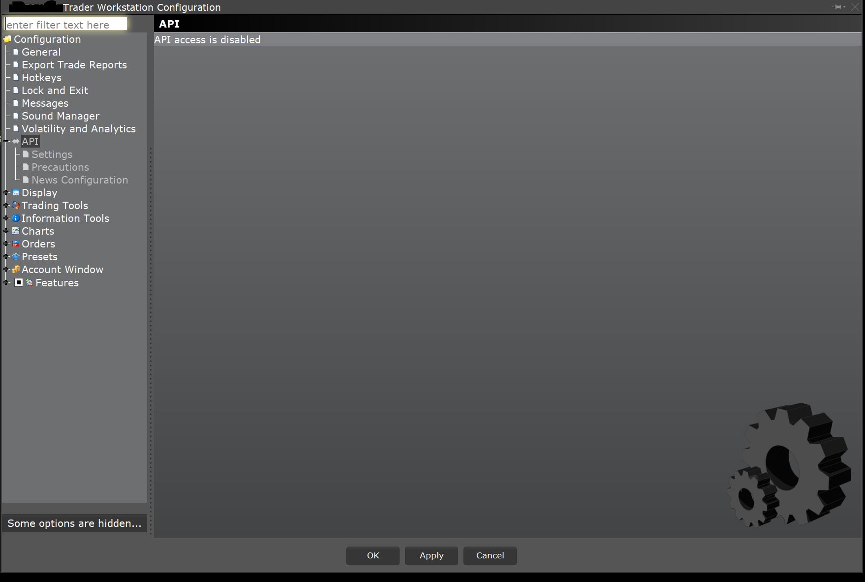

I have installed the latest version of TWS, but I am still unable to access the API settings to allow SC access to the data (please see attached pic). All of your documentation that I can find goes through this settings menu that is blocked. IB Gateway and TWS are closed doors for some reason. Do you have any suggestions? Has something possibly changed from previous versions of the IKBR softwares? Please advise.
@SC Support, I have not received the additional info that you mentioned sending last night. Can you please resend?

We have never seen a case where TWS API access is blocked/disabled. That is very unusual. We wonder why this is the case for you.

Unicorn_Catcher - Posts: 22
3 different support people at IBKR have said that this is exactly what I should expect. I believe you and the others here that say they do it all the time, but that doesn't change my access. Do you have any suggestions?

Chad - Posts: 247
Unicorn_Catcher, is your account configured for their 'IBKR Lite' package i.e. commission-free trading? I recall seeing several limitations of that account type, versus a 'standard' one.
@Chad, They only have "IBKR Lite" and "IKBR Pro" account types. They differentiate between fixed or tiered stock/etf commissions for Pro, but that doesn't matter in my case, I'm not going to trade on their platform. Multiple people at IKBR have told me the only way to access the API is by switching to Pro. Switching to Pro changes my data fees from $53 on the non-pro side to $250 for the same access in Pro, which makes this ridiculous.
Since your IB software works properly, could you possibly check your TWS and or IB Gateway versions for me? I have the latest and they may have turned off this access. If yours works, I can request that version possibly.

Chad - Posts: 247
Right, I'm on the IBKR Pro account (still 'non-pro' w.r.t all exchange subscriptions, however). Both TWS and Gateway are v972.1
Unless you check 'Yes' for one of the boxes on the exchange agreement forms e.g. 'Are you a licensed member of FINRA', 'do you plan to distribute this data', then I struggle to understand why you're being classified as pro.
@Chad, Thank you so much for your input here, it prompted me to call IBKR a 4th time, but armed with better info.
So, I was told in this last conversation that IBKR Lite is a relatively new account delineation for them. This level of account currently denies access to API functionality through the Gateway or TWS, but it has been approved and will have that access in a couple of months. The good news is that Chad is correct. You can change your classification from Lite to Pro and while your trade commission structure will change, your market data rates will stay at the non-pro level (as reflected by your disclosures), which is a huge difference.
This is different from what personnel at their secondary call center have said (and priced) to me more than once, but is good to finally get to the bottom of this. I'm guessing the default account for most non-pros that use IBKR for stock trading will be set to Lite for the free commissions, so anyone with a newer IBKR account should be aware of this limitation (for the time being).
