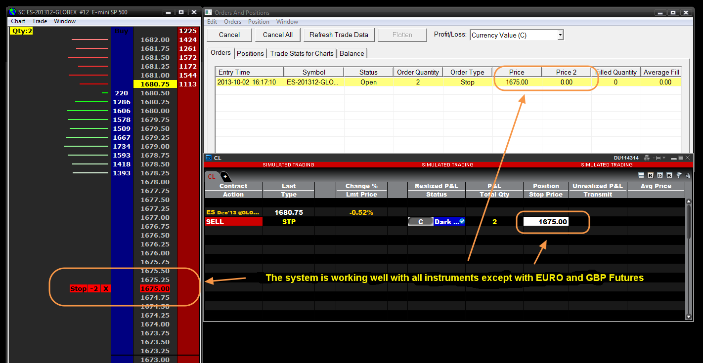

After that I have done some more testing and I found an additional information that I hope will help to fix the problem: the mentioned stop orders just “disappear” when trading Euro Futures and GBP Futures.
When trading any other instruments there is no problem at all (i.e. CL, ES, YM, GC, etc.).
Please see the attached screenshots with some examples of the described problem and examples with another instrument that has no problem.

imageEuro Stop Order.PNG / V - Attached On 2013-10-02 16:18:22 UTC - Size: 82.65 KB - 798 views
imageEuro Stop Limit Order.PNG / V - Attached On 2013-10-02 16:18:33 UTC - Size: 83.67 KB - 898 views
imageES Stop Limit Order.PNG / V - Attached On 2013-10-04 15:25:43 UTC - Size: 82.92 KB - 751 views
imageES Stop Order.PNG / V - Attached On 2013-10-04 15:27:01 UTC - Size: 83.44 KB - 804 views

So it seems that this problem is finally over.
SC Support – Thank you very much for all your support.
