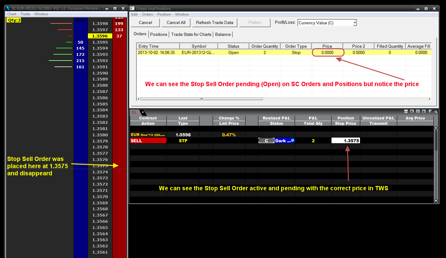

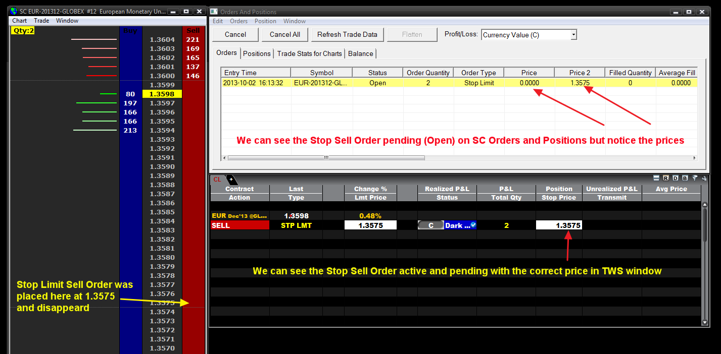

- Nevertheless, the Stop orders are still disappearing from the Trade Dom and from the charts a moment after placed, although they remain visible and active in both SC Orders and Positions window and in TWS window;

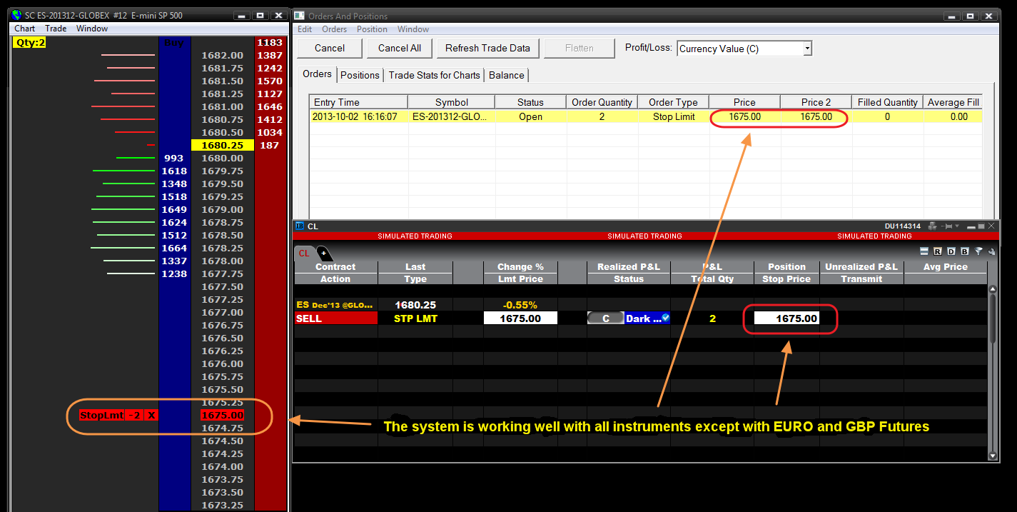

After that I have done some more testing and I found an additional information that I hope will help to fix the problem: the mentioned stop orders just “disappear” when trading Euro Futures and GBP Futures.
When trading any other instruments there is no problem at all (i.e. CL, ES, YM, GC, etc.).
Please see the attached screenshots with some examples of the described problem and examples with another instrument that has no problem.
