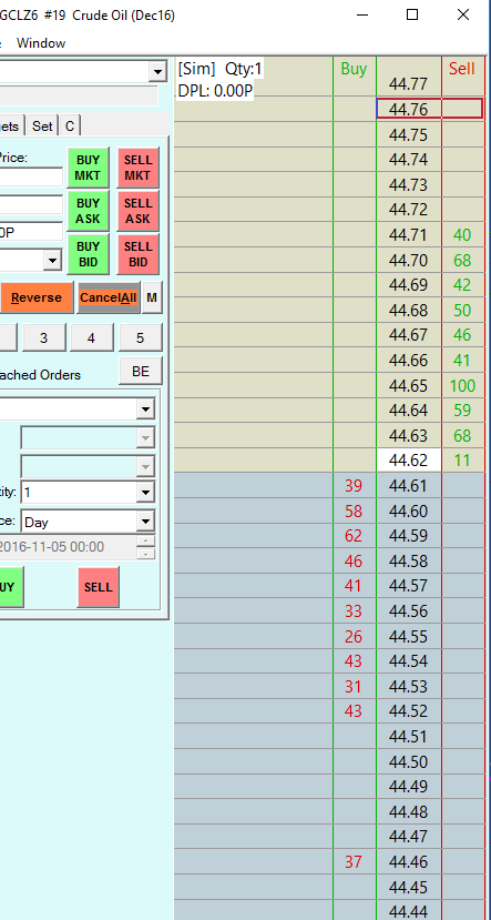

[2016-11-04 08:50:03]
User17477 - Posts: 65
Now I am seeing this on the DOM for GCLZ6. A price below the 10 levels I usually see. My EUREX feed and ES data is always perfect with Sierra but this symbol is seeing these issues.
imagesierra issue gclz6 dom.png / V - Attached On 2016-11-04 08:46:21 UTC - Size: 39.65 KB - 400 views
[2016-11-04 08:50:33]
From our perspective we have no way to verify if the authorization issue is intermittent.
If we see the Message Log we can determine what the problem is at that moment in time. Here are the instructions to provide that:
Date Time Of Last Edit: 2016-11-04 08:51:42

[2016-11-04 10:40:35]
Regarding Post #4, we do not know what can be done about that market depth data issue. We recommend just reconnecting to the data feed when you see it:
It is not something we are willing to spend time on because there is not a practical solution to it and it is data feed specific.
Date Time Of Last Edit: 2016-11-04 10:40:55

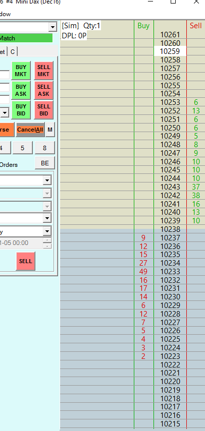

[2016-11-04 16:38:51]
I checked with Gain and they added additional symbols for me. Im still seeing DOM issues though like the attached chart in this post. I hope you don't expect me to keep reconnecting the data feed when I see this kind of thing. I don't see this as a reasonable workaround.
imageoff centre.png / V - Attached On 2016-11-04 16:36:53 UTC - Size: 34.72 KB - 467 views
[2016-11-04 16:39:42]
The image i just attached was for FDAXMZ6.
[2016-11-04 17:08:21]
OK we will have a look. Looks like Gain Capital changed how the data feed works.

[2016-11-04 17:53:30]
Clearly Gain Capital has changed how the market depth data stream is implemented.
We made a small change which now resolves this problem.
