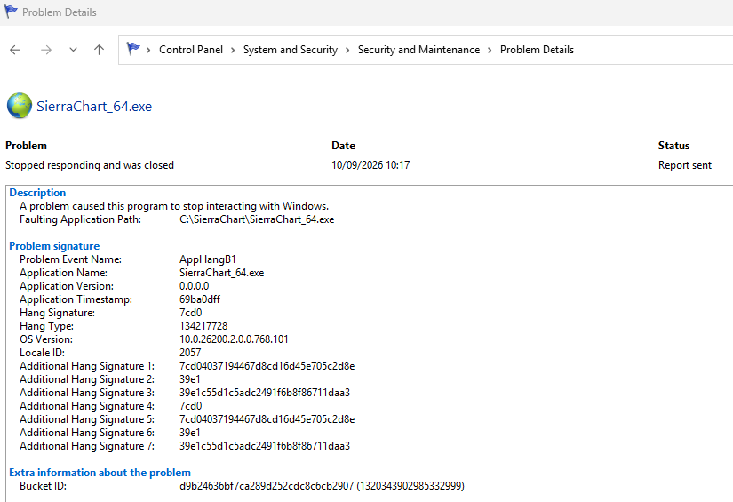

After a windows update last night the app is freezing completely.
I've attached a screenshot of problem details.
Your help would be much appreciated please.
CPU useage was at 0% in task manager when frozen
Thank you
Date Time Of Last Edit: 2026-09-10 16:57:03
imageScreenshot 09-10-2026 17.48.29.png / V - Attached On 2026-09-10 16:48:50 UTC - Size: 40.91 KB - 73 views

Does the screenshot tell you anything?

Does the screenshot tell you anything?? This all happened after a windows update.

Resending the original problem details screenshot
I'm very keen to get this resolved asap please. Can you confirm anything from the screenshot or the windows update having any bearing on this? Then I'll try the overnight RAM test.

I'm confused, is there a reason why your ignoring my question about the report I posted and the update prior to this?
[2026-09-11 13:23:42]
GC72 - Posts: 23
WHAT DOES THE REPORT TELL YOU? (6th ask, no answer yet)
COULD IT BE RELATED TO THE WINDOWS UPDATE?
I need to know the answer to this please before I attempt to take my pc apart!

Sierra_Chart Engineering - Posts: 25293
It tells us, that the operating system is detecting that Sierra Chart is freezing but the reason is unknown. So it is not really helpful to us. It is of little significance.
The first thing we want you to do is to go to the folder Sierra Chart is installed to on your computer:

[2026-09-11 16:01:16]
We see CQG symbols being used. So set the Current Selected Service to CQG:
CQG Trading Platform Service: Setup Instructions
[2026-09-11 17:04:00]
GC72 - Posts: 23
Yes, the same symbols CQG that have been working fine previously seem to have all changed to non-CQG on this reload from the backup file change, and colour setting are slightly different.
Seems to be working again now, thanks.
