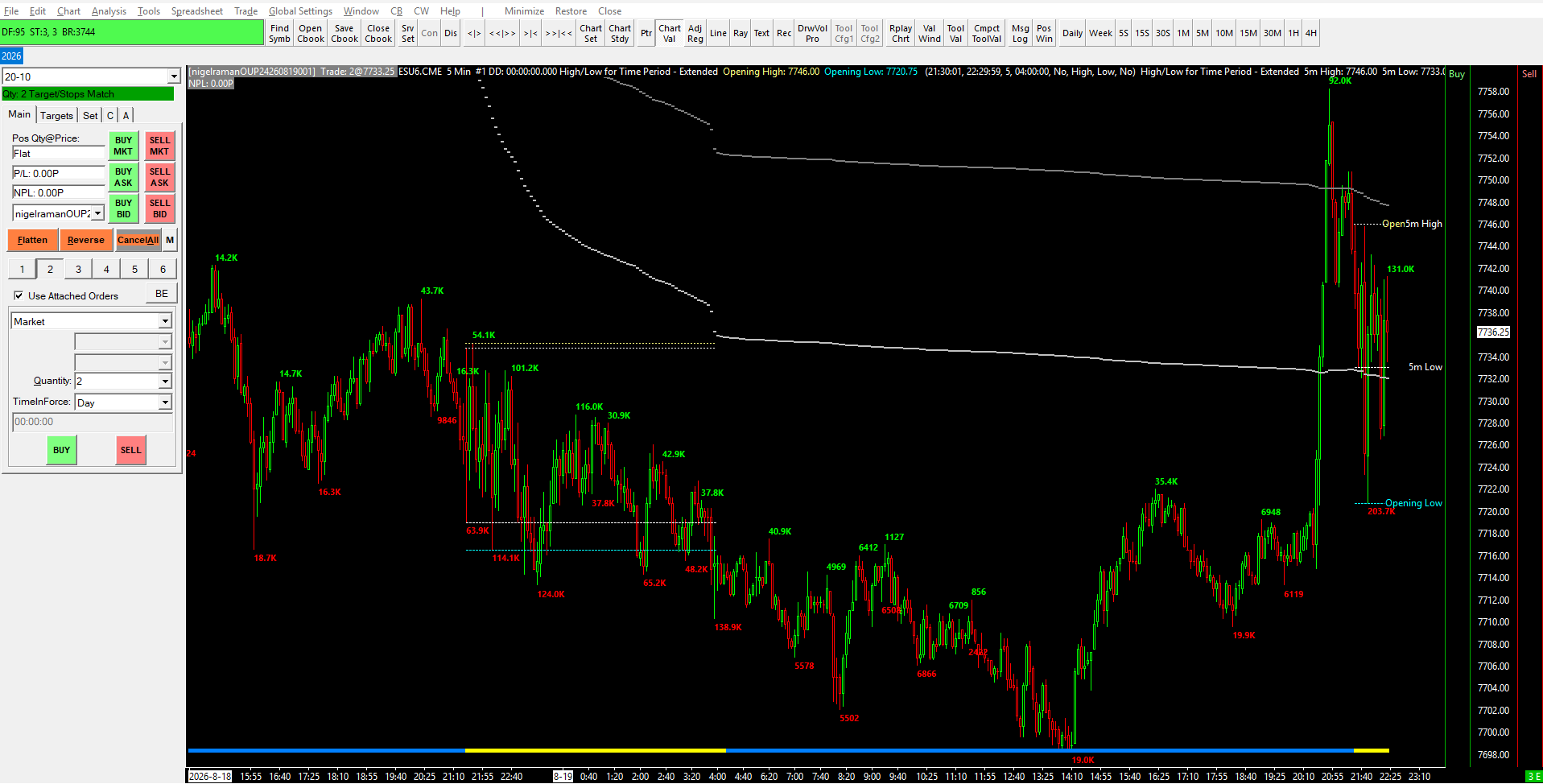

Hi Support,
My Sierra chart 2891 freezes when I load the chartbook. I am connected to the rithmic data feed through a prop firm eval.
When I say freeze, basically the chart would load to the latest, then just stop at the most recent candle. I've tried delete and download data, using the find symbol to ensure I have the right symbol, but still have this problem.
imageScreenshot 2026-08-19 223251.png / V - Attached On 2026-08-19 14:33:24 UTC - Size: 28.38 KB - 80 views
imageScreenshot 2026-08-19 223501.png / V - Attached On 2026-08-19 14:35:09 UTC - Size: 98.95 KB - 89 views

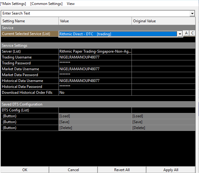

nigel1988 - Posts: 8
Hi John,
Thank you for responding. I have done what you said, but the message log is still empty. Before I cleared it, it was empty as well.
Also, I updated to 2939 while waiting for response, still same problem persists.
imageScreenshot 2026-08-19 225452.png / V - Attached On 2026-08-19 14:55:00 UTC - Size: 8.09 KB - 88 views
[2026-08-19 14:59:05]
John - SC Support - Posts: 48643
Please select "Global Settings >> Message Categories" and set all the items in there to "Yes". After you close that, your Message Log will then display the information and you can get it to us.
[2026-08-19 15:03:31]

[2026-08-19 16:44:26]
Sierra_Chart Engineering - Posts: 25476
The Rithmic server is indicating the symbol is not not known:
2026-08-19 23:03:03.871 | Symbol Error | ESU6.CME is unknown, unavailable, or improperly formatted. unknown request
We do not know the reason why it is doing that. You really should use the Denali Exchange Data Feed for data:
