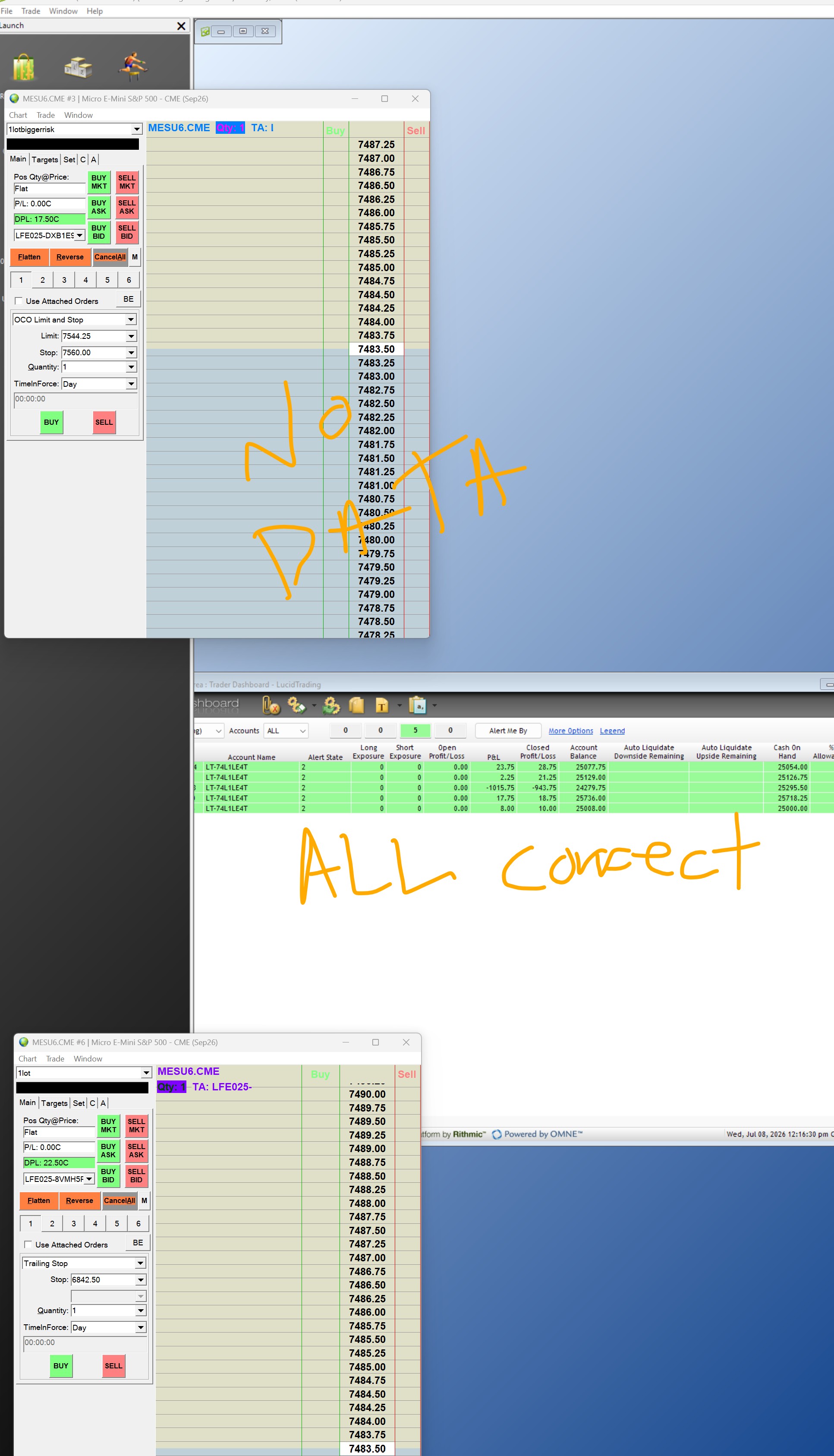

John, something odd has just happened and I have also written to Lucid. I was trading perfectly fine this morning.
1- I blow one of my Lucid accts. I purchased new acct
2- I log off of SC so that new acct can be added to drop down on dom
3- I re log on
4- I select new acct from drop down. I see a small trade. I enter 2 lot buy
5- Suddenly the dom stops, and the data disappears
6- I hit flatten
7- I have Rithmic pro open, and see the acct has been added AND the trade I just did entered.
8- now all the acct doms are dead. No data
9- disconnect and reconnect data service. Still dead. Check log in is correct, it is.
10- check to make sure my acct balance is in credit, it is.
I am clueless as nothing changed except for me to log off to allow new acct to be entered into chartbook. A trade was made, and then it went dead.
See accompany sheet shots. HELP
imagerithmicOK,tradeentered.jpg / V - Attached On 2026-07-08 11:32:25 UTC - Size: 682.04 KB - 101 views
imageloginOKnodata.png / V - Attached On 2026-07-08 11:34:44 UTC - Size: 482.77 KB - 93 views
[2026-07-08 14:04:44]
John - SC Support - Posts: 48169
Most likely, you had an issue connecting to Rithmic for some reason. If you are not able to connect to your connected trading service, you will also not get the data from our Denali Exchange Data Feed.
If you are still having an issue, then please get us your Message Log by following these instructions:

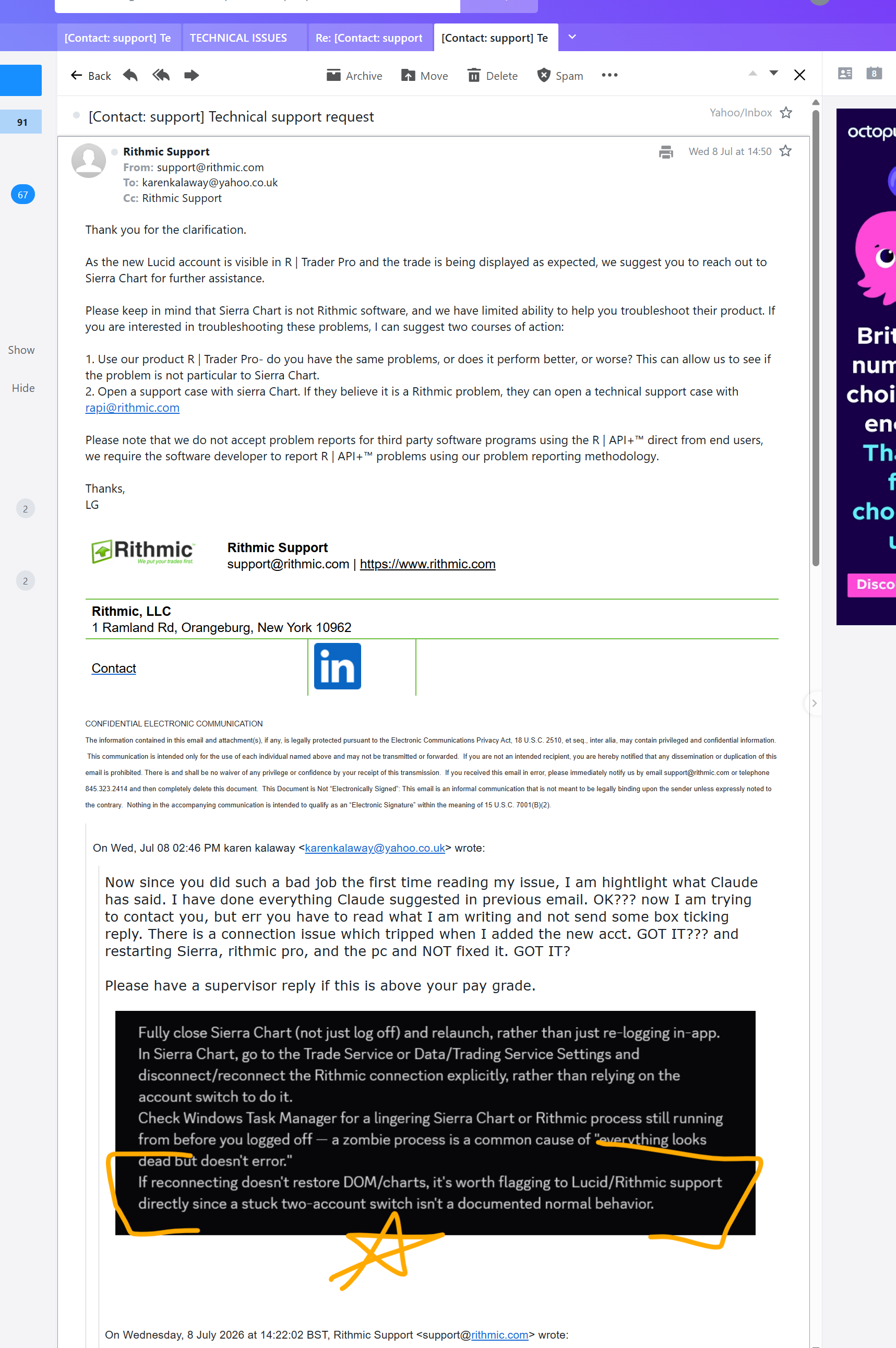

Attached is the reply from rithmic. I googled Claude, and it seems when adding a new acct this can happen. Please read attached, and I will send log in the next post. again, I have restarted everything.
imagerithmicsaySCissue.png / V - Attached On 2026-07-08 14:13:05 UTC - Size: 787.14 KB - 103 views
imageclaude.png / V - Attached On 2026-07-08 14:13:13 UTC - Size: 787.14 KB - 99 views

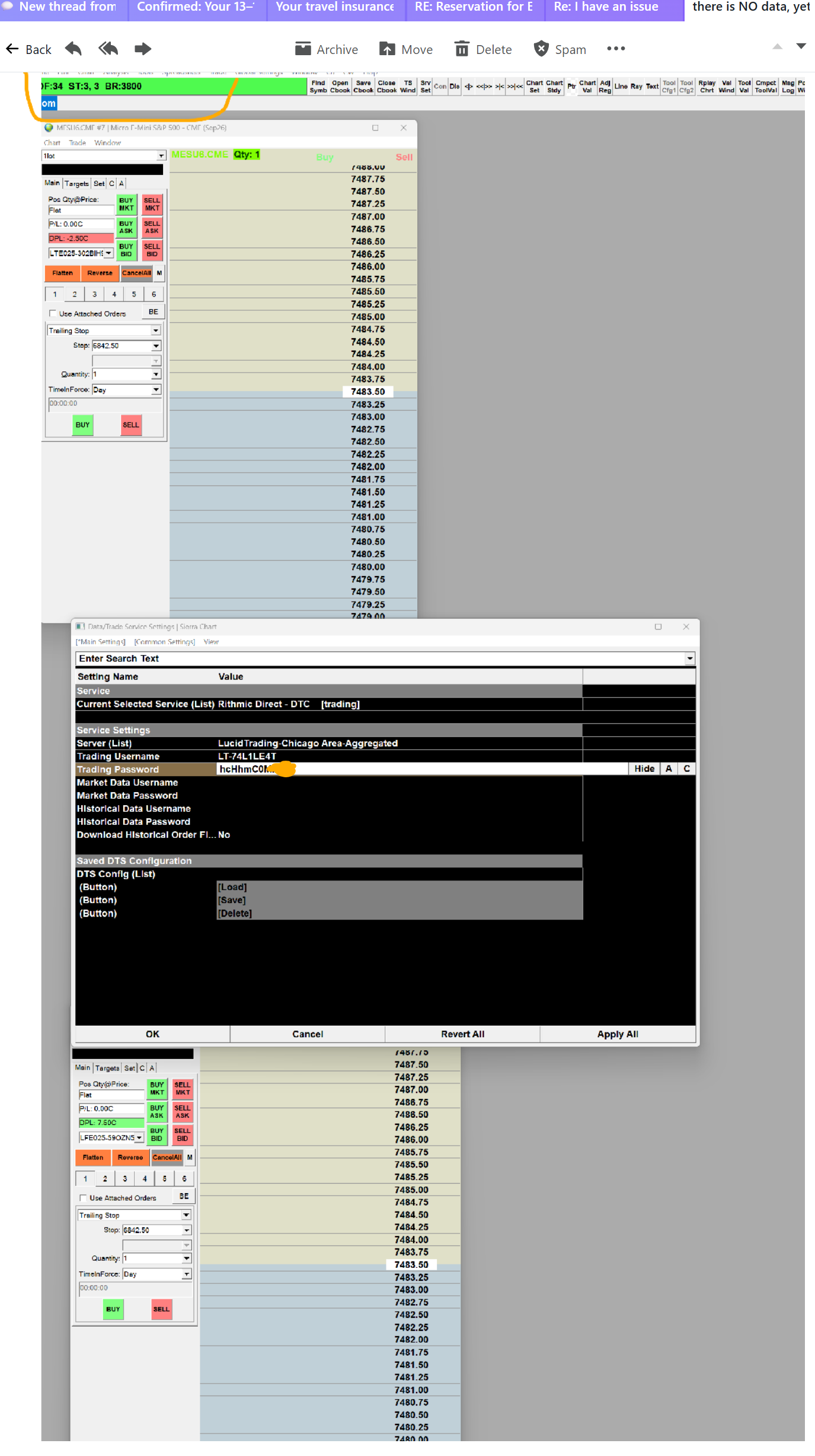

[2026-07-08 14:49:24]
They always say that.
But, the issue in this case is not due to Rithmic. The issue is that you have not connected to your live, funded, futures trading account within the past month. As such, your "Verifed Until" date is set to "July 7, 2026". Which means that you are no longer able to get the real-time data from our Denali Exchange Data Feed for the CME Group.
And since you do not have the fields filled out for the "Market Data" and "Historical Data" on your "Data/Trade Service Settings", you are not going to get the data from Rithmic, therefore, you are not getting any data.
Once you connect to your live trading account, everything will go back to normal.

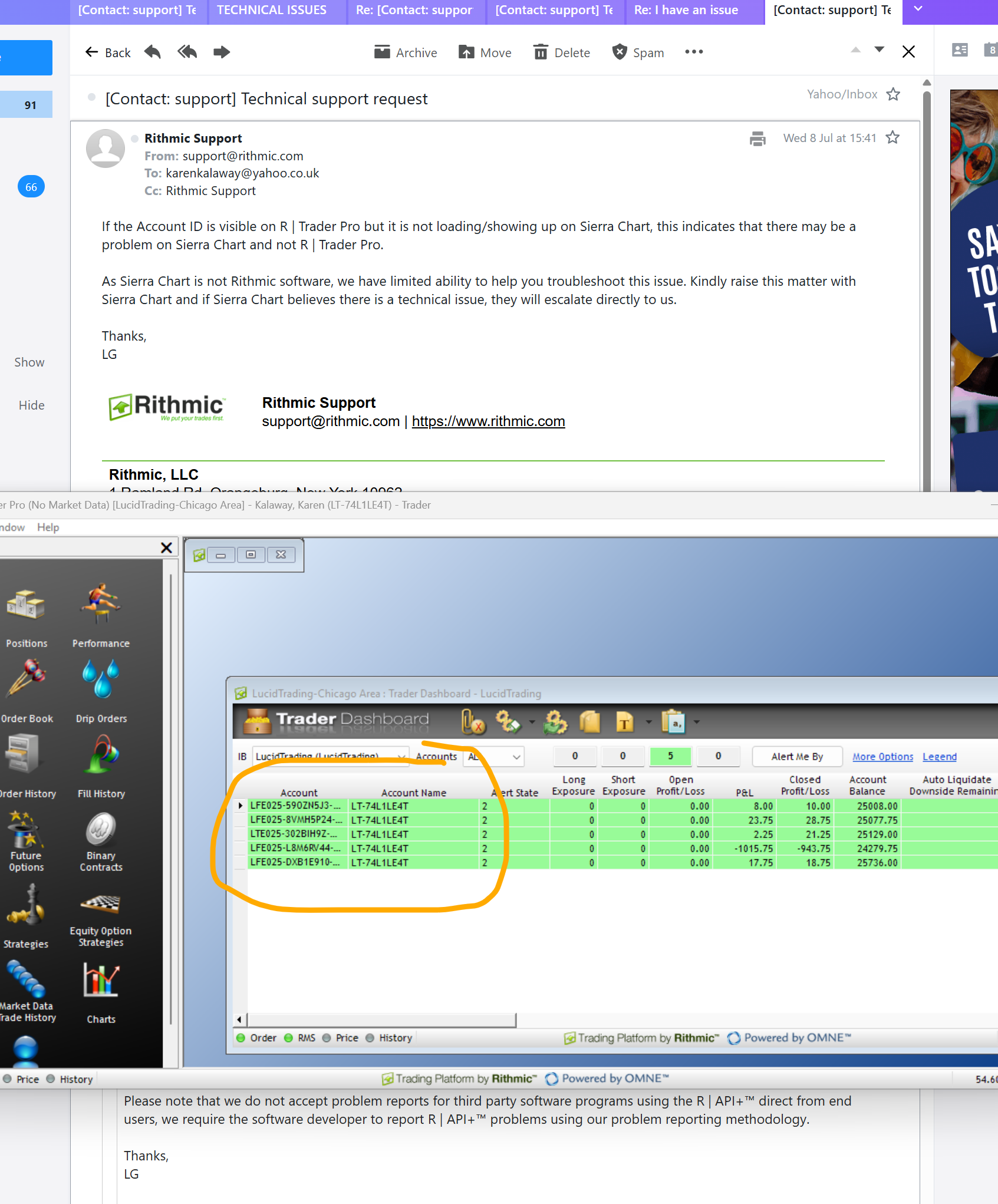

[2026-07-08 14:51:11]
User849502 - Posts: 481
Rithmic is adamant that the issue is with SC as the accounts are all showing live in trader dashboard of R Pro
imageacctshowsinRPro.png / V - Attached On 2026-07-08 14:51:00 UTC - Size: 816.41 KB - 95 views
Wait, but how am I able to get data, live and kicking, on SC data? Why would Rithmic not be able to access it as well? I will google this as I must be missing something. I have put the Edge Philip cap acct on hold that must be why.
[2026-07-08 16:54:46]
If you have an installation connected to "SC Data" then that installation is NOT getting real-time data, but would be getting the delayed streaming data.
In the installation that you have connected to Rithmic, you are not getting any data, as you are not able to get the real-time data from our Denali Exchnage Data Feed, so the system tries to get the data from Rithmic. But since you do not have the fields filled out to get the data from Rithmic, you are getting no data.

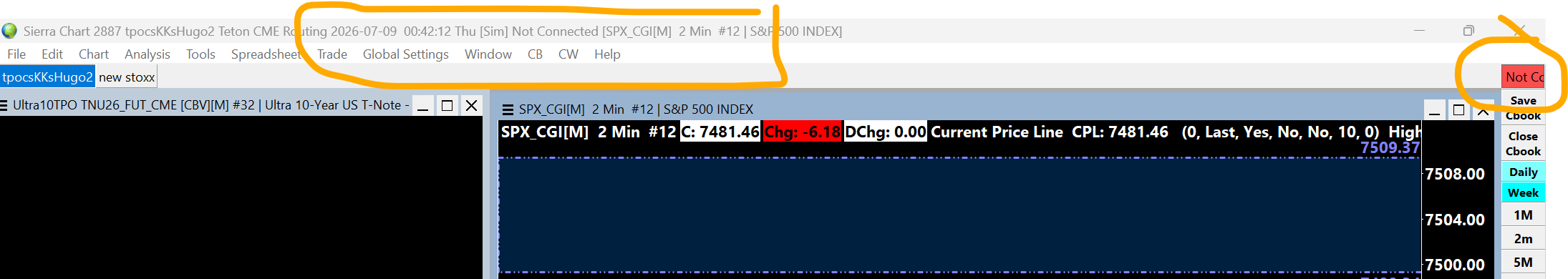

[2026-07-09 05:52:16]
ok Idiot girl has sent funds to Philip, and they were received overnight. I have emailed them to make sure to turn back on Teton CME access. That will solve my issue, right? I tried doing it just now, and it wouldn't connect. So even tho Philip received the funds they must not have switched it back on.
I am so sorry to have bothered you. I know all these issues are self-made, but I completely forgot that I needed a funded acct. I looked at your list, and to confirm, you can't have a funded acct at Schwab/TOS right? I have one there, but not Interactive Brokers.
Karen
imagenoconnection.png / V - Attached On 2026-07-09 05:52:11 UTC - Size: 61.37 KB - 110 views

[2026-07-09 13:01:50]
omg mate, you were so right about Rithmic being total shite haha. I connected whilst waiting for Philip/Edge to reconnect my Teton as funds arrived yesterday. How could someone trade off that? Anyway, I keep bugging the customer service team, so hopefully, with the next hour or two when they arrive at work, it will be turned back on. Then once my doms are active and the Edge accts show in dom the Lucid and Rithmic should work right? thanks mate
[2026-07-09 15:24:23]
Yes, you should be fine now. Your "Verifed Until" date is now showing as "August 8, 2026". So you would be getting the real-time data again.
hey John, on one login of SC data it is, as you said it would be, delayed. But guess what? On the other it is live...yes, really.
At this point, we can not say what may have been occurring, as you have updated your "Verified Until" date. The only thing we can think is that you have to remember that this rule is just for the CME Group data. If you were looking at the CBOE Indices, which is another exchange you have active with us, then that data would still be real-time.
