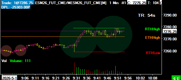

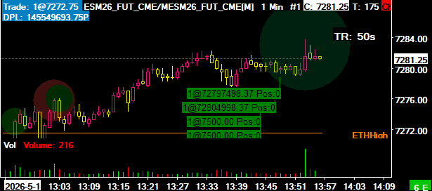

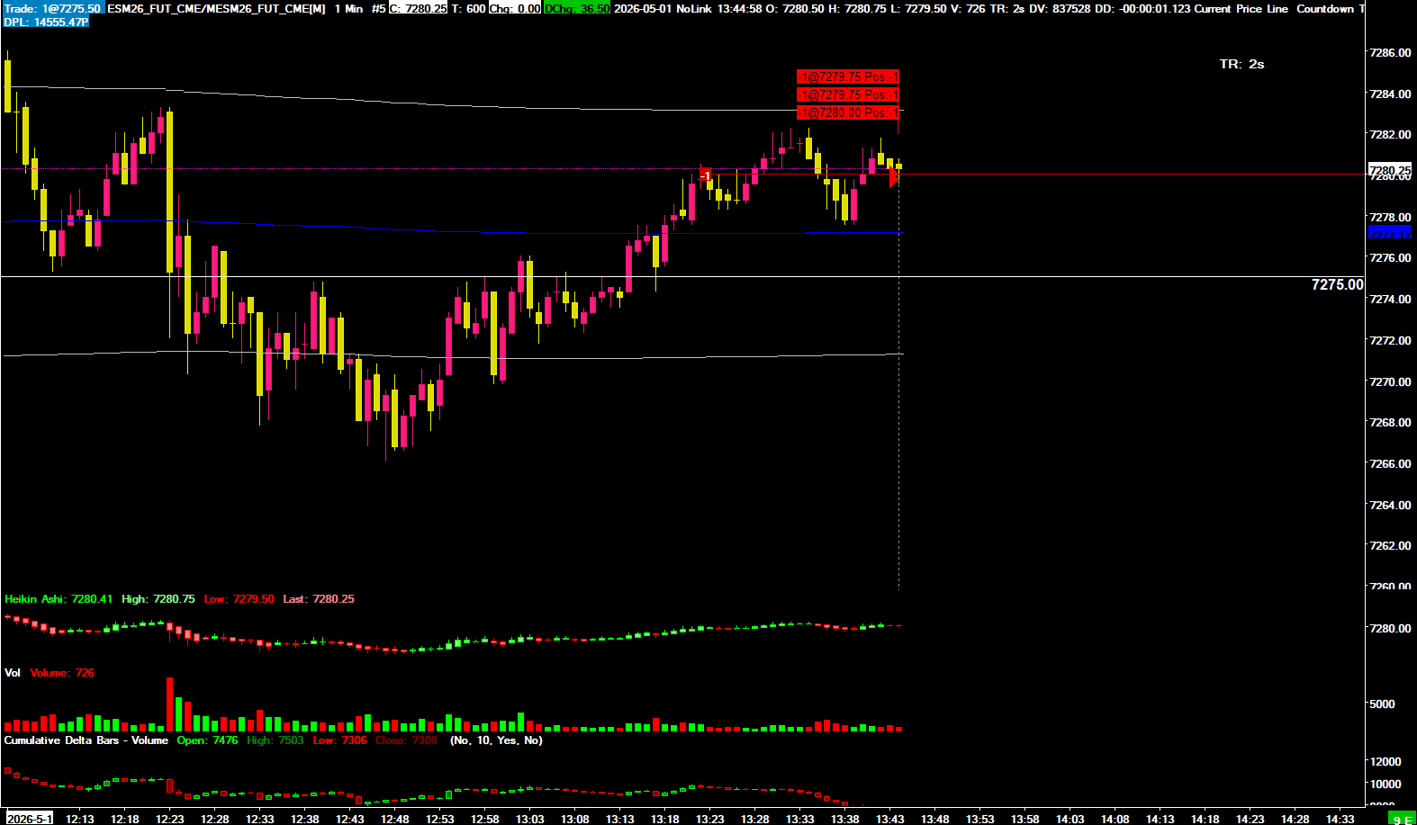

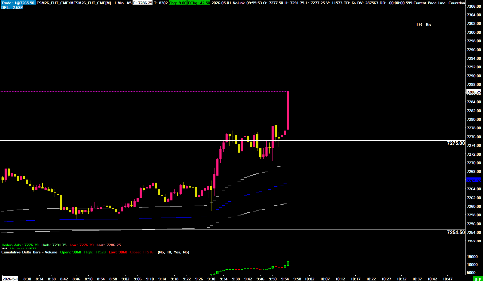

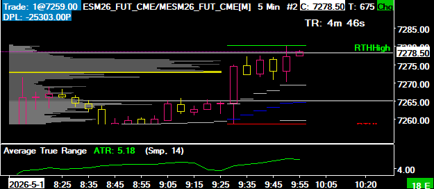

Market Orders, with Attached bracket orders. I don't get anything showing in the chart no lines on the chart including no lines for the attached orders ( which is selected on ) when entering from DOM These two yesterday Did show the entry and attached order lines ( when I responded yesterady ) but now aren't https://www.sierrachart.com/image.php?Image=1777643648275.png https://www.sierrachart.com/image.php?Image=1777643716846.png This chart is where It hasn't been showing at all but it used to https://www.sierrachart.com/image.php?Image=1777643755953.png Thank you |

I can't because it Won't show the lines when I enter. That's what I am trying to say is the problem. You're asking me to send you a picture of the chart with the lines, I would love to send that, But that's what I am saying it is not doing. Even with all of those settings checked. The lines are not showing. How do I send you that then? Alternativly: Do You want me to enter directly on the chart? Right click , buy market, right click , send attached order by postion? https://www.sierrachart.com/image.php?Image=1777657500641.png but when I just hit send attached order by position it cleared all of the lines That would be the only way but thats not the problem we are tyring to fix. Its when I enter from Dom the lines don't show <- ths is the problem |

Those are Order Fills. Note the prices that are showing - 72797498.37. So you are putting orders at some crazy price. First of all, make sure you select the "Flatten" button on the Trade Window, or right click and select "Flatten and Cancel". Then, we need to understand exactly how you are entering the order. The "Simple Bracket" is a configuration, not an order. It just sets up your Trade Window per how you saved that configuration (or how it came with the software). We need to know how you are actually entering the order on the DOM? Are you selecting a button on the Trade Window? Are you right-clicking on the graph and selecting an option there? Are you using a left or right click in the Buy/Sell columns in the DOM? Also, look at your Trade Window (Trade >> Open Trade Window for Chart) and see how you have that setup. What is the "Order Type"? What are the prices that are setup for that order type? For the most reliable, advanced, and zero cost futures order routing, use the Teton service: Sierra Chart Teton Futures Order Routing |

My trade entries are 7292 , 7275 things like that however I do see those wild lines at 72774998.37 or 727472498.37 . I am really not sure how those big numbers are there in the middle of the other numbers as I dont set limits for those big numbers. how I enter - I enter Dom, Market order, BUy Mrk Button or Sell Market button, Buy Market 2, SIM 2 , use attached orders. Lines show. This part is working fine. This is where it doesn't then reflect on the chart. Thank you alot for this . |
