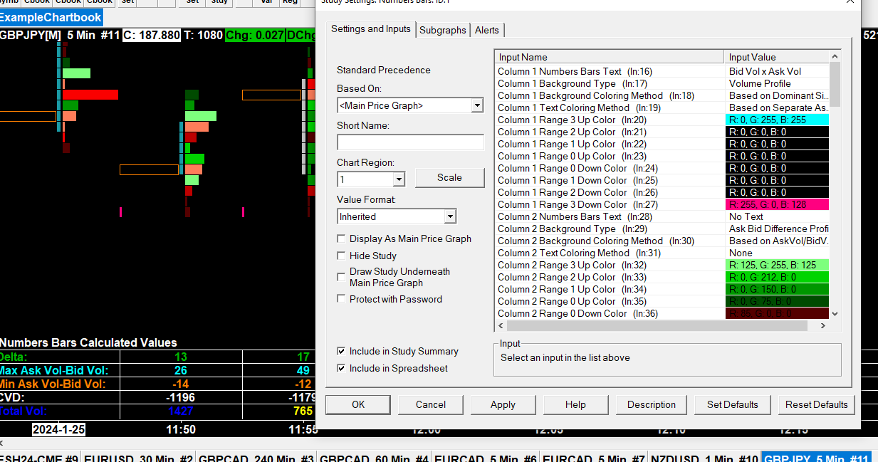

I've been fiddling with number bars and I can't figure how to go around imbalances. I've put Ask/Bid in Column1 , Delta Profile in Column2.
Then, I'm supposed to set most of the ranges to transparent (how?) and set compare thresholds. When I do so, some of the bid/asks go blank, as there's no transparency to leave the lower thresholds intact.
Can you advise ?
(I'm not sure if the screenshot has come through)
imagefp.jpg / V - Attached On 2024-01-23 22:40:18 UTC - Size: 310.74 KB - 307 views

The information for how to do this with the Numbers Bars study for the background higlighting is at the following link:
Numbers Bars: Display Ask/Bid Imbalance
Also look at the "Volume at Price Threshold Alert V2" study and this particular section of the documentation for it:
Volume at Price Threshold Alert V2: Highlight Multiple Adjacent Bid or Ask Dominant Prices (Stacked Imbalance)

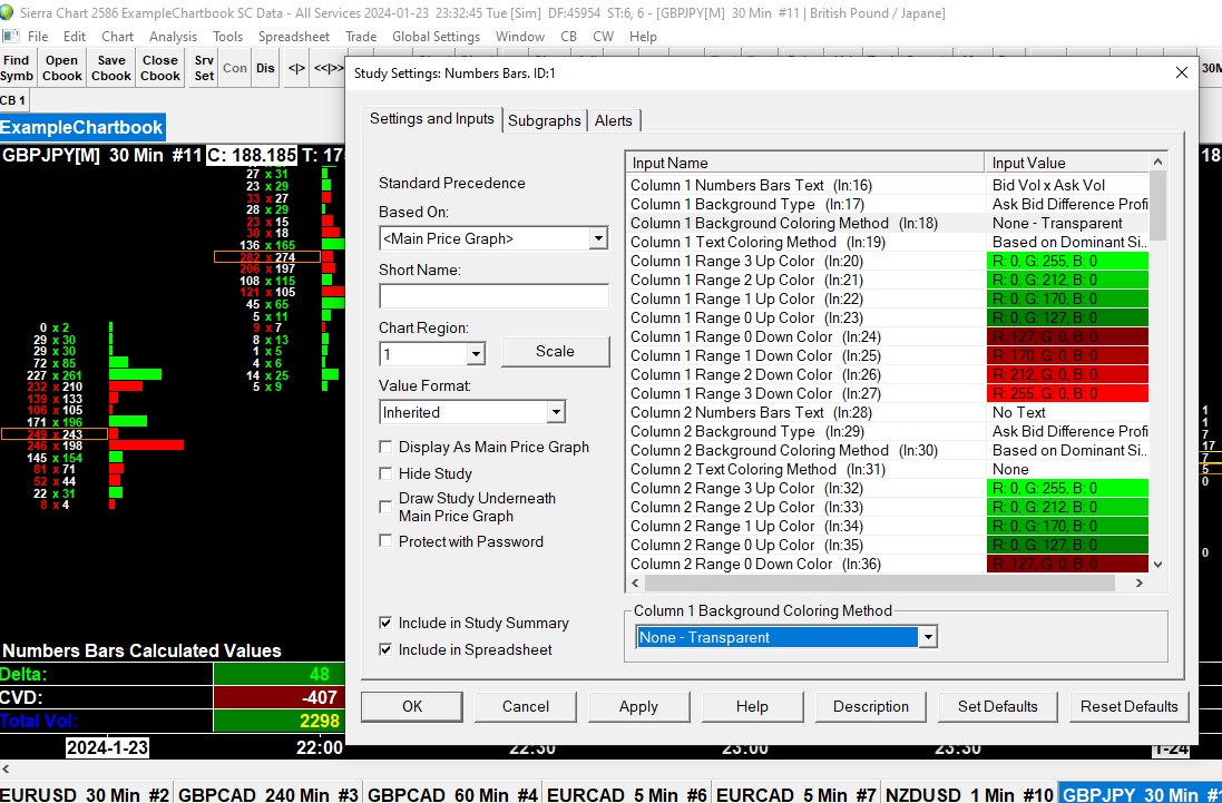

Thanks for your response, John, but here's what happens :
Making the Column1 background as a chart's makes all the numbers disappear.
Besides I wanted to make numerical imbalances, not as a histogram...
imageib.png / V - Attached On 2024-01-25 11:39:55 UTC - Size: 70.67 KB - 275 views

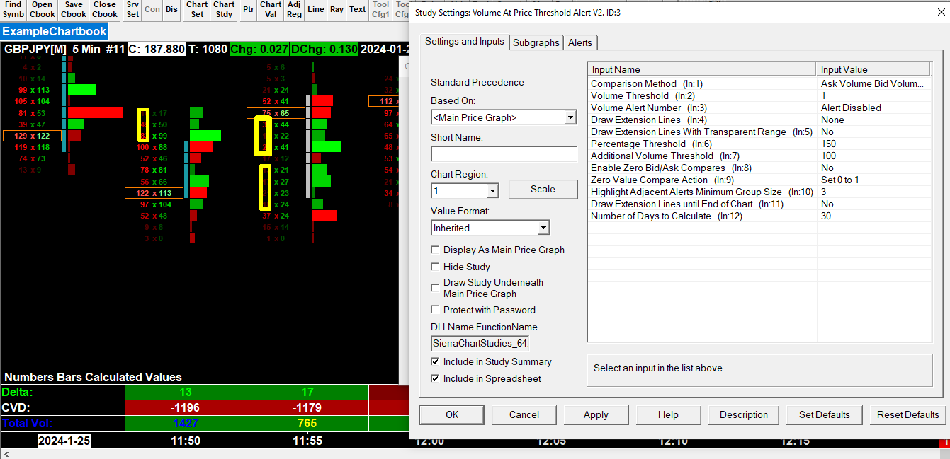

The second method leaves me with that, can't figure out how to configure it to look readable and how to change imbalance trigger to 300% ? Percentage threshold? Doesn't seem to work.
imageib2.png / V - Attached On 2024-01-25 12:00:51 UTC - Size: 67.23 KB - 266 views
[2024-01-25 12:30:00]

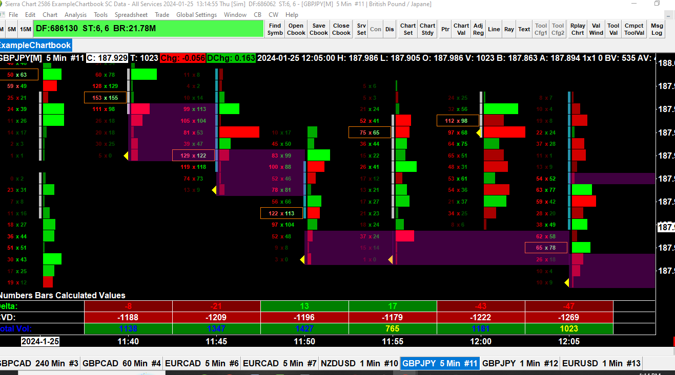

UnleashedPiglet - Posts: 67
I figured out how to make the Vol at Price Threshold show up neatly, more less, but still can't make it show proper imbalance thresholds. The marker shows random imbalances, sometimes 300 %, sometimes 120%...sometimes from a group of stacked imbalances shown by the extension line, at times it doesn't show it at all
imageib3.png / V - Attached On 2024-01-25 12:29:51 UTC - Size: 82.07 KB - 262 views
[2024-01-25 16:12:22]
Ok , I used the Vol at Price Threshold and Vol ratio to establish a desired amount of imbalance. Now, is there an option to get rid of the candlestick's external imbalances highlighted? 3x0, 0x7 etc. ?It makes the chart very noisy.
Many thanks for your patience.

Make sure the Input for "Enable Zero Bid/Ask Compares" is set to "No". Refer to the following:
Volume at Price Threshold Alert V2: Inputs

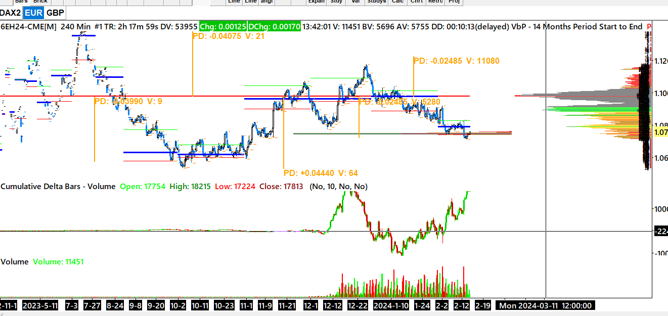

Regarding the last candle spreadsheet formula. I managed to put it all together as you suggested.
The numerical outcome is fine, but how should I make the line run across the chart until the following day (couple of days, until intersection etc.) like the one marked directly on the chart?
What if I'm in another timezone and I would like to copy this settings for MES or 6E ?
Many thanks for your assistance.

imagelastcandle.png / V - Attached On 2024-02-14 13:28:30 UTC - Size: 37.04 KB - 245 views
The information we gave you is to specifically show the line across the chart for the current day. You just need to make sure you have the subgraph for the column that has the last formula displayed.

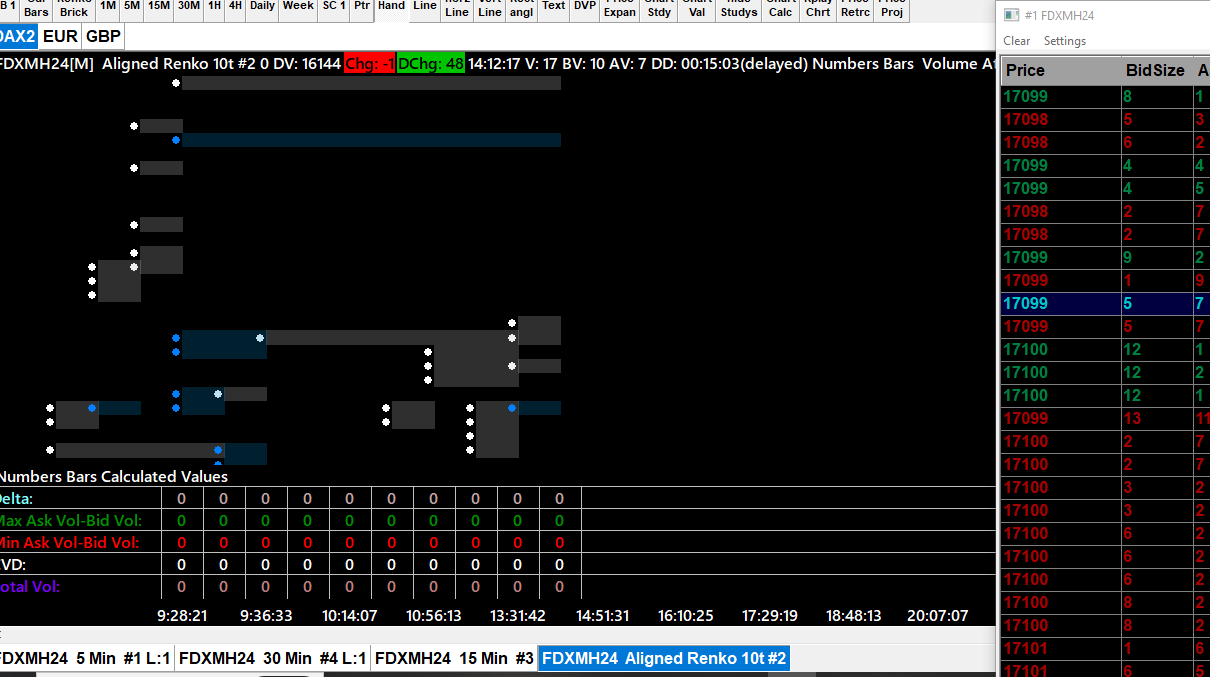

subinstance won't load the data today. Yesterday it more or less worked (I disconnected and reconnected several times). Today it keeps showing yesterday's data. Delete & Download won't help.
Get us the Message Log for the Sub-Instance by following these instructions:
Close all of the Chartbooks with "File >> Close All Chartbooks".
Open a single chart for the symbol you have an issue with through "File >> Find Symbol". Tell us that symbol of the chart. Tell us about *one* symbol only.

1.I just activated the Base package. I'm not sure if it's a relatable issue but my renko charts have dissapeared. I've set them up a month ago and used on daily basis. FDXM and MES just start with the empty chart, no numerical values. Screenshot attached. All graphics settings intact. Since there's no values , that's not the case anyway. The connection is there for other charts.

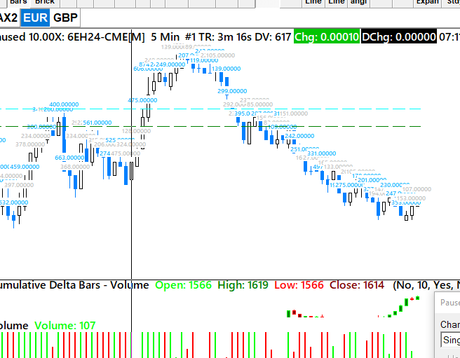

2.Can I make volume use big numbers on the labels over the candles? Screenshot attached
3. Why is the data so scarce for 6E/6B etc. for more than 6 months back ? Is it going to be better with Denali ?
