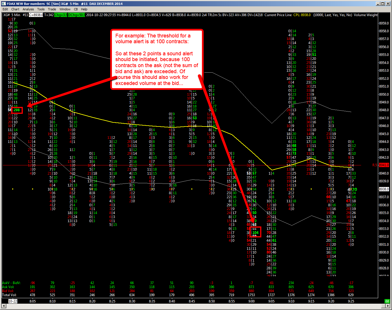

So again my question for a very simple alert within the numbers bars study:
I would like to have a very simple sound alert within the bar numbers study, if the number of traded contracts for one price at the bid OR at the ask is exceeded.
So I would like to have an alert as soon as more than e.g. 100 contracts are traded on the bid OR on the ask (not the sum of bid and ask) within the current developing bar.
I am not interested in the price where it happens, I am only interested in the fact, that it happens in the current bar on the bid or ask.
It would be nice if the sound of the alert could be selected by the user.
Can you establish such an easy alert within the numbers bars study?

Due to the fact, that we also trade via SC and of course for saftey reasons, we would prefer a verified and reliable offical solution by Scierra Chart.
The alert should be initiated as soon as more than e.g. 100 contracts are traded on the bid OR on the ask (not the sum of bid and ask) at ONE price level within the current developing bar. I am not interested in the price where it happens, I am only interested in the fact, that it happens in the current bar at ONE price level on the bid OR the ask. For clarification please have a look at the attached example of a screenshot from this morning.
So my question is: Can this simple "volume-exceeding-alert" within the numbers bars study be programmed by the Sierra Chart Support Team and if yes when will it be available?

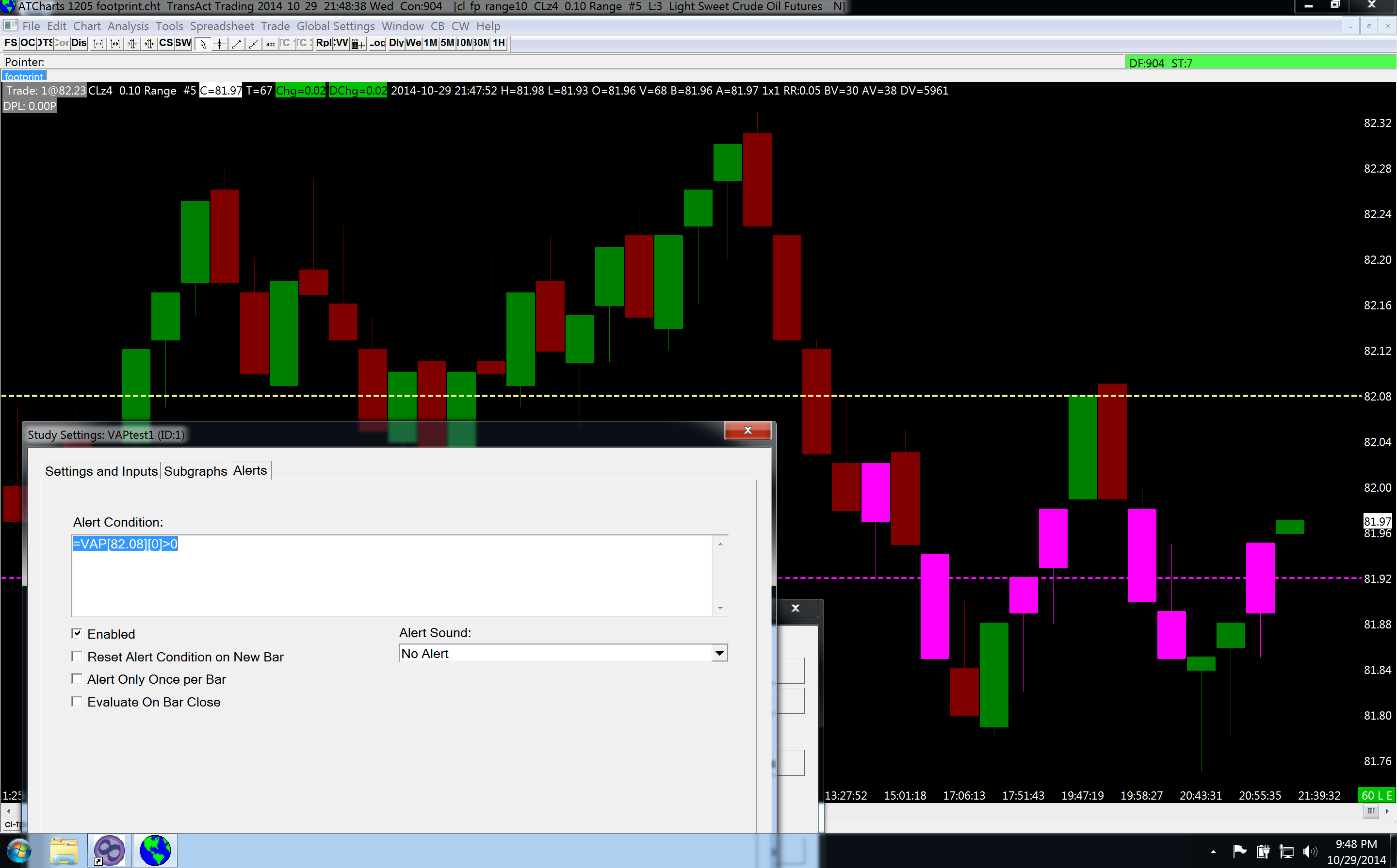

Shane - Posts: 31
Thank you for the prompt response. Please see the attached image and chartbook. VAP[price][0] works correctly for the price 81.92 (coloring the bar magenta), but a separate study hard-coding 82.08 fails to color the bar (should be orange).
Please note that accessing the ask, bid and total volume at a price level within the bar is an incredibly useful feature. However, having to hard-code prices makes it's difficult to use in any kind of real time application. Resolving the other identifies (e.g., H, L, C, O) within the first bracket makes it very useful in lots of interesting ways.
Even better, though more difficult, would be to, within the first bracket, index the price level relative to the high or low of the bar, thus allowing access to every price level within the bar. Admittedly, this may be better used within ACSIL.
Appreciate your time and attention.
