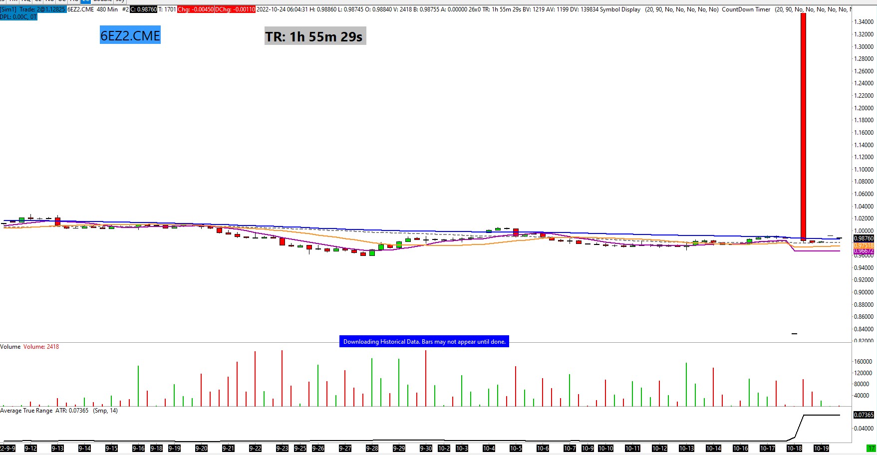

I have Sierra Charts on my laptop and desktop. The charts on my laptop seem to look fine but my desktop is all over the place.. please see the attached file and can you help me resolve the issue?
imageScreenshot 2022-10-24 060449.jpg / V - Attached On 2022-10-24 19:26:55 UTC - Size: 176.76 KB - 668 views

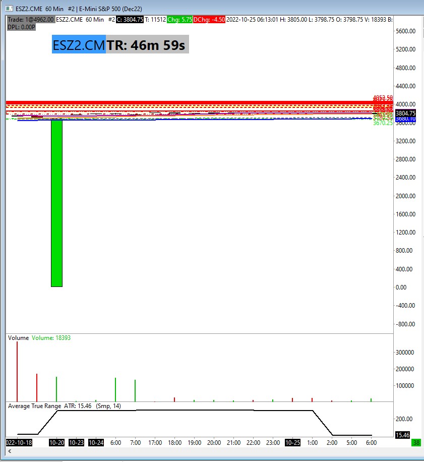

User386175 - Posts: 31
this is how my charts look. i can't trade...... i updated to the new version. why is this like this??? i messaged you yesterday..............
imageScreenshot 2022-10-24 060449.jpg / V - Attached On 2022-10-25 13:13:42 UTC - Size: 176.76 KB - 663 views
[2022-10-25 13:58:04]
We apologize for the long wait.
The only thing we can tell you to try is to redownload the data starting from just before where the problem data is. Refer to the following:
Data Errors or Spikes in Charts, Flat or Flat Line Graph, Compressed Graph, Errors with Date/Time Values: 2.1.2 Deleting and Re-downloading Data. (Easier and Recommended Method)
But, since you are using Rithmic data, we are not sure if you will get back the deleted historical data, as we have been hearing that the historical data is not coming into the system. So you may not get back the deleted data, but the problem bar will be gone.
