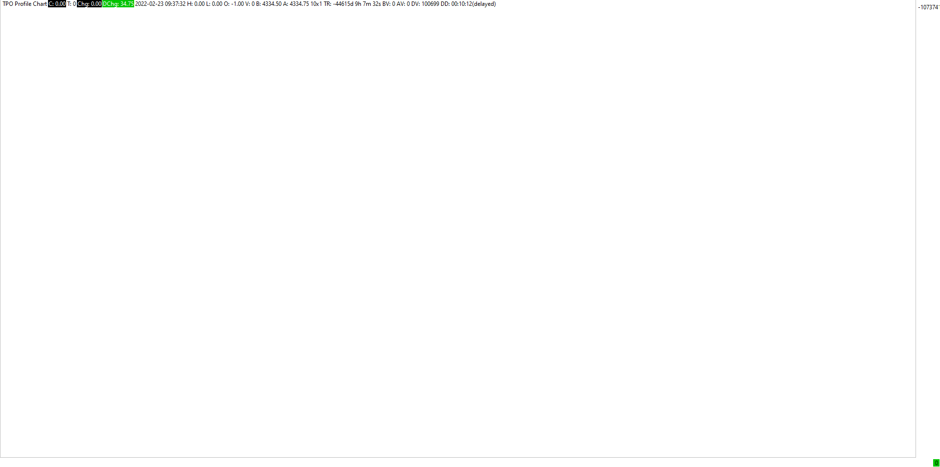

Hi. I have 2 question: 1. I would like to see real data without delay in Sierra Chart. I have bought the standart pack 3 months. How can I see mini sp 500 and crude oil in real time? 2. Profile of market (blocks), I can't see anything. I try with all symbol. I send you 1 screenshot. I hope your help. Thanks. https://www.sierrachart.com/image.php?Image=164560606377.png |
| [2022-02-23 18:22:38] |
| John - SC Support - Posts: 48527 |
1. What futures trading/brokerage service do you use? For the reason why we ask this question, refer to: Real-Time Exchange Data Feeds Available From Sierra Chart: Understanding and Accessing Data From the CME, CBOT, NYMEX, COMEX Exchanges (Understanding and Accessing Data From the CME, CBOT, NYMEX, COMEX Exchanges) 2. This is because you are on Package 3. In order to use the TPO study, you need to be on the Advanced Package. Refer to the differences in the packages here: Description of Service Packages and Pricing: Packages For the most reliable, advanced, and zero cost futures order routing, use the Teton service: Sierra Chart Teton Futures Order Routing |

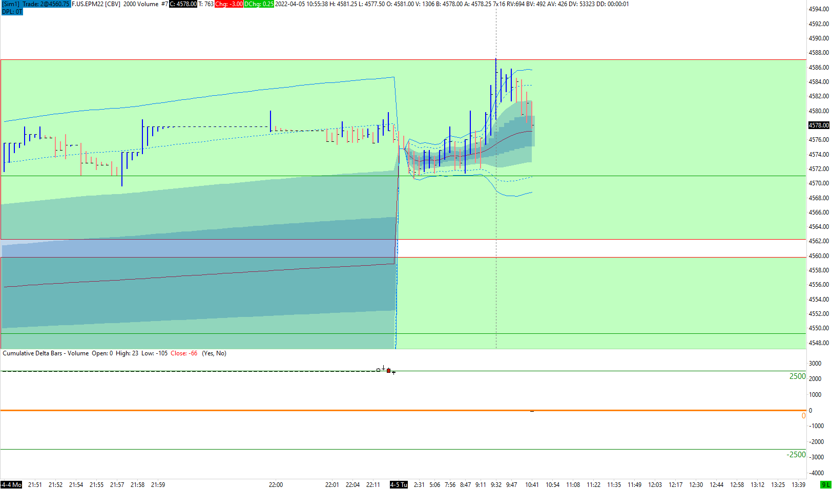

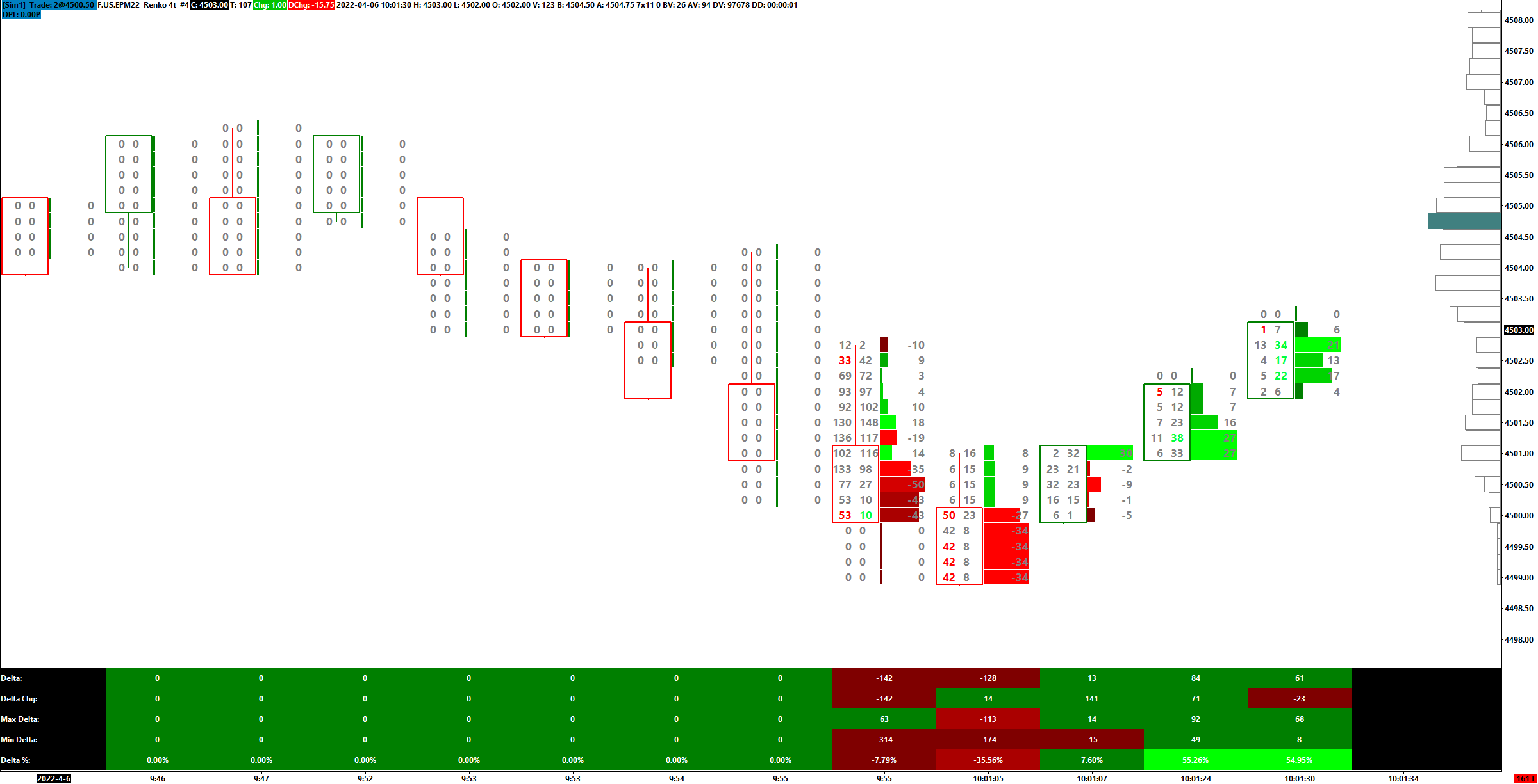

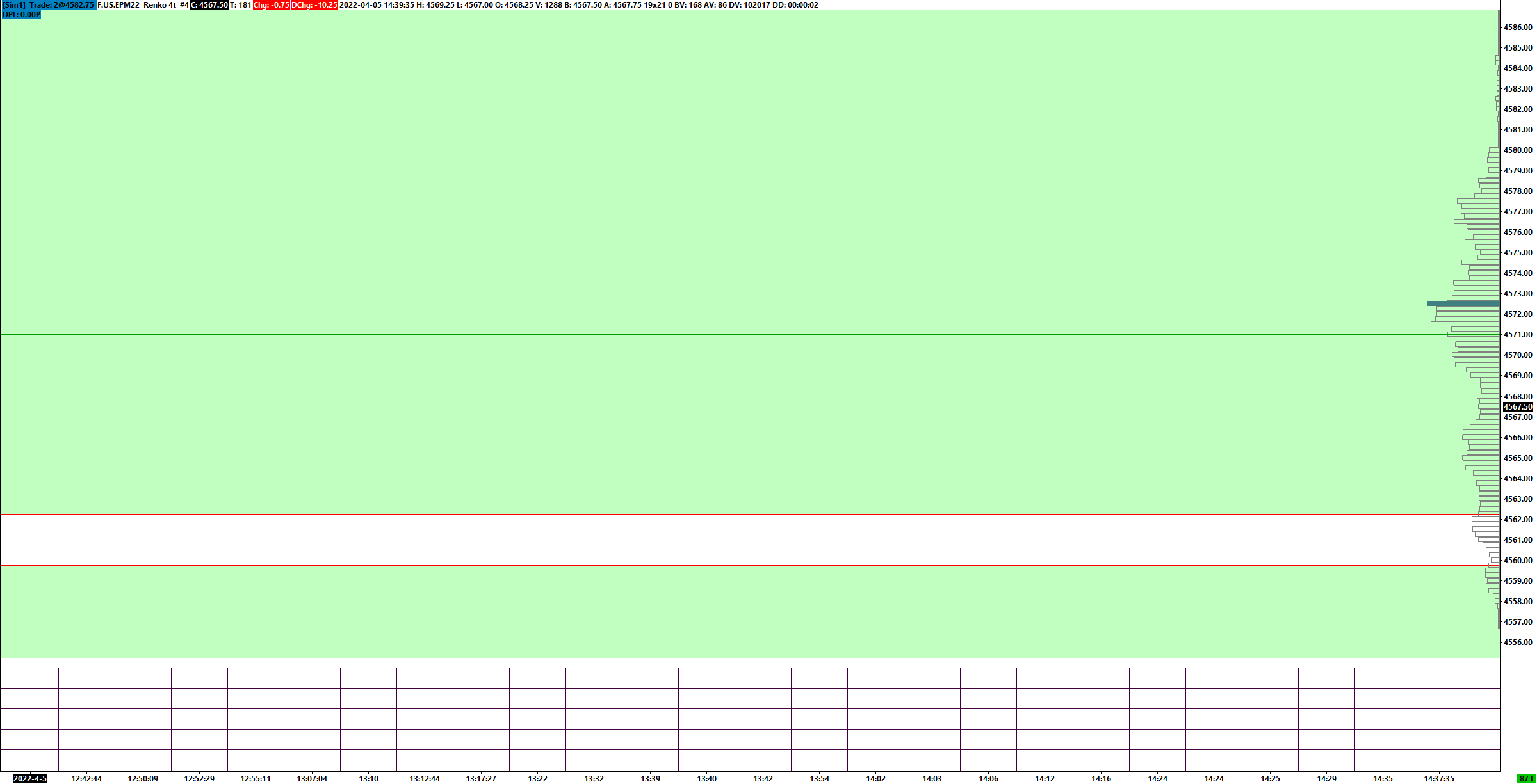

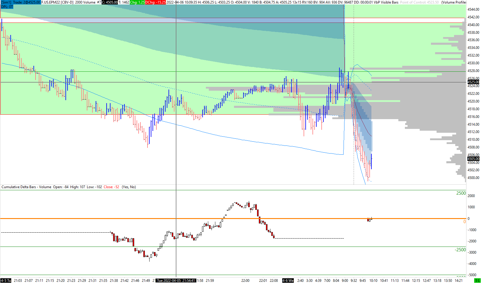

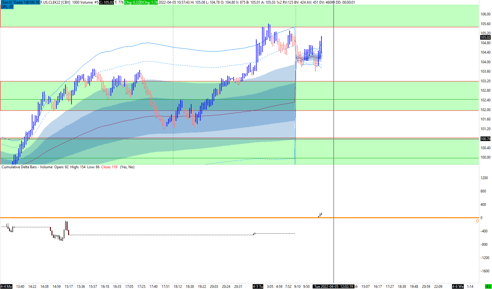

Price is moving, but Cummulative Delta y Footprint doesn´t work. Session Times are ok. I send you screenshot. See the bars in Cummulative Delta, and all the 0 numbers in Footprint. https://www.sierrachart.com/image.php?Image=1649148939220.png https://www.sierrachart.com/image.php?Image=1649149025201.png https://www.sierrachart.com/image.php?Image=1649149065877.png https://www.sierrachart.com/image.php?Image=1649149109817.png |
| [2022-04-05 10:42:55] |
Sierra Chart does not support historical tick by tick data from CQG for CME and EUREX and this is the reason for the problem. Refer to: https://www.sierrachart.com/index.php?page=doc/Whats_New.php#SCVer2351 We will be discontinuing support for CQG market data for CME and EUREX. So you really need to use our Denali Exchange Data Feed for market data: Denali Exchange Data Feed Sierra Chart Support - Engineering Level Your definitive source for support. Other responses are from users. Try to keep your questions brief and to the point. Be aware of support policy: https://www.sierrachart.com/index.php?l=PostingInformation.php#GeneralInformation For the most reliable, advanced, and zero cost futures order routing, *change* to the Teton service: Sierra Chart Teton Futures Order Routing Date Time Of Last Edit: 2022-04-05 10:43:54

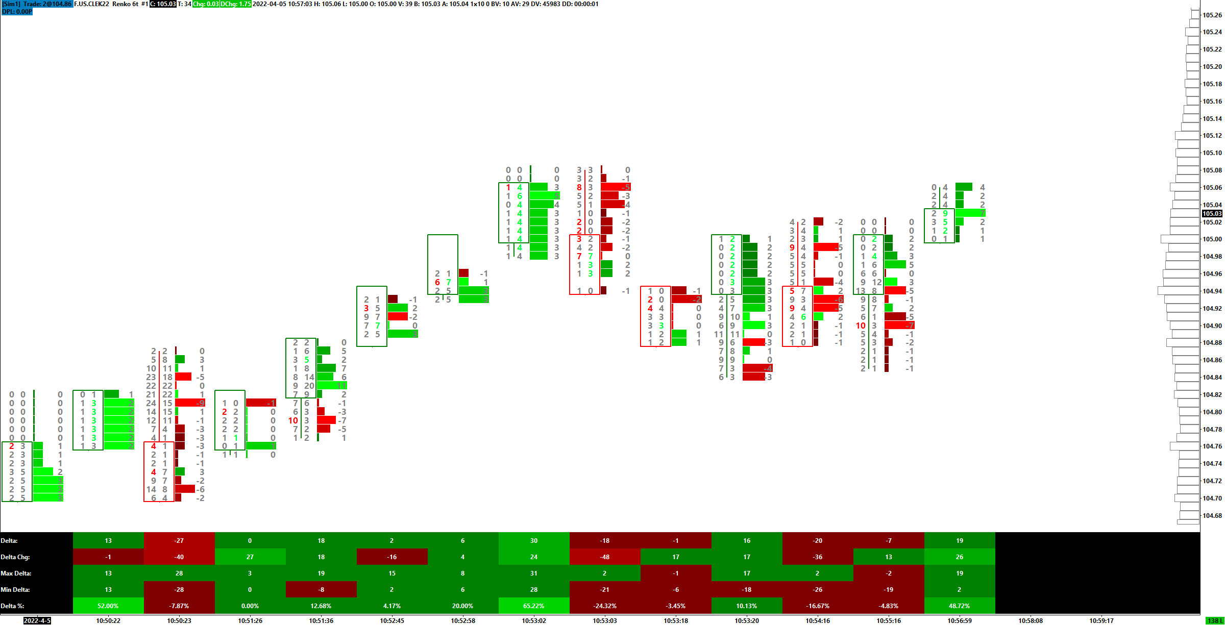

Well, I have DENALI now, and I have the same issue, and a bigger issue. No number bars in Footprint. Can you help me please? what's the problem now? I only pay and pay and no results. Sierra is a professional tool. Please, I need professional help from you. https://www.sierrachart.com/image.php?Image=1649162380361.png Date Time Of Last Edit: 2022-04-05 15:20:51
| [2022-04-05 16:06:37] |
Please go through all the steps in the Setup Instructions for the CME Group data on the Denali Exchange Data Feed here: Denali Exchange Data Feed: *Setup Instructions: CME/CBOT/NYMEX/COMEX Exchanges* Also, you are currently on Package 10, but in order to view Numbers Bars you need to be on Package 11. For the most reliable, advanced, and zero cost futures order routing, use the Teton service: Sierra Chart Teton Futures Order Routing |

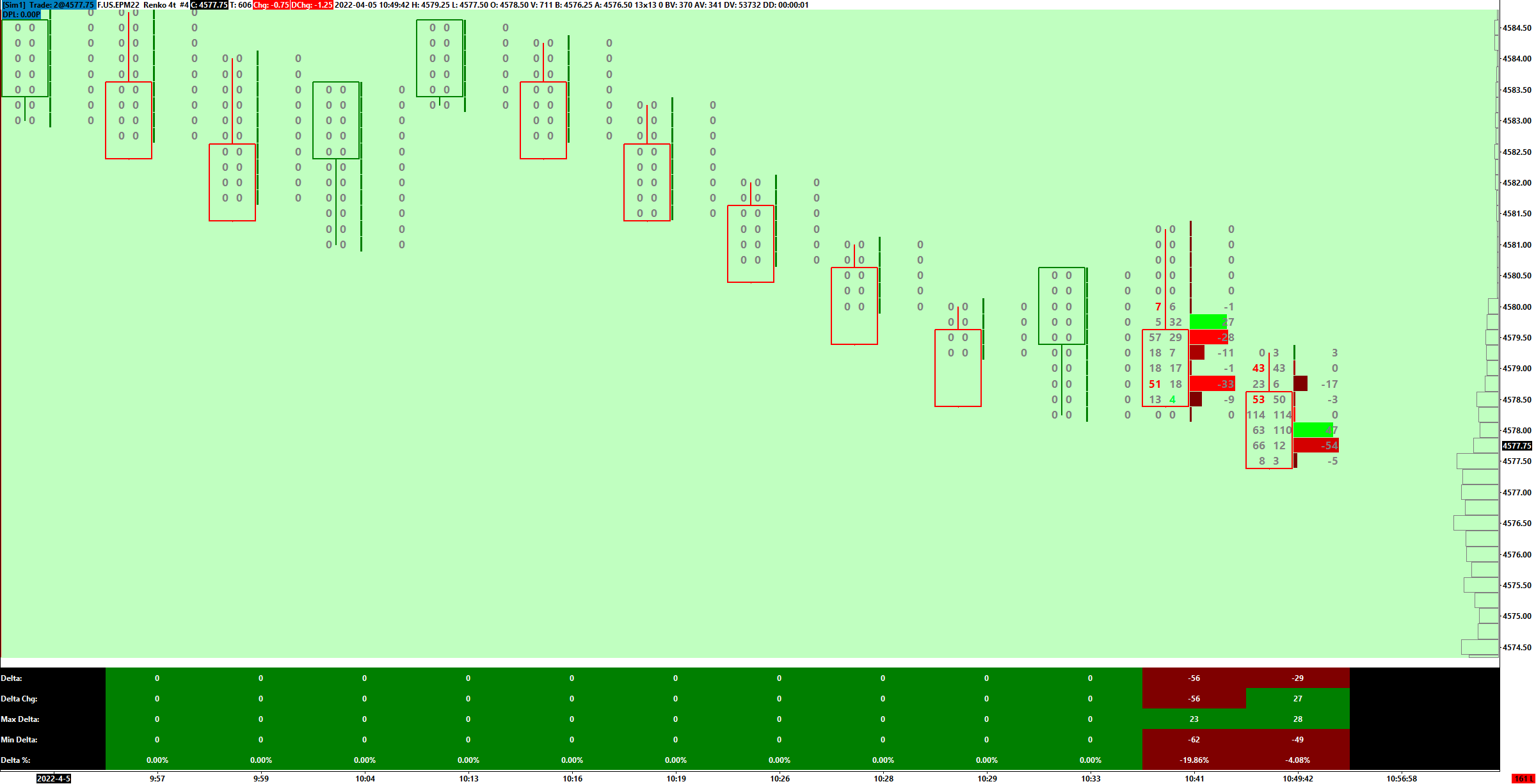

Ok, I show yo some screenshot. Now Number Bars and Cummulative Delta is ok, but why over night, when I have not in front of pc (but Sierra is open), doesn´t work number bars ( always 0) and Cummulative Delta? https://www.sierrachart.com/image.php?Image=1649232577123.png https://www.sierrachart.com/image.php?Image=1649232797167.png |
| [2022-04-06 14:10:23] |
You are still not getting the data from the Denali Exchange Data Feed. We need to see your Message Log by following these instructions: Follow the instructions here to clear the Message Log: Message Log: Clearing the Message Log Open a chart for the symbol you have an issue with. Tell us that symbol of the chart. Disconnect from the data feed with "File >> Disconnect". Connect to the data feed with "File >> Connect to Data Feed". After the connection and after about 10 seconds, provide a copy of the Message Log following these instructions: Support Board Posting Information: How to Post Your Message Log (Required In Some Cases) We will then determine what the problem is. For the most reliable, advanced, and zero cost futures order routing, use the Teton service: Sierra Chart Teton Futures Order Routing |
