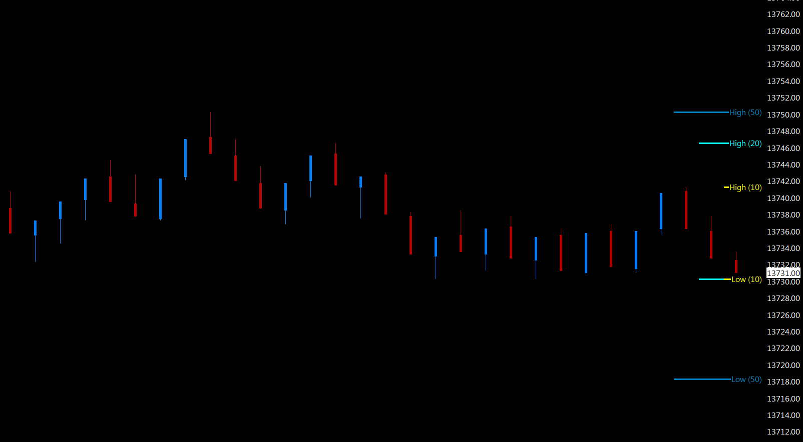

Thanks so much! I managed to plot these lines, wonderful! however is there a way to cut the lines short just to show at around the last few bars. Now they go all the way back to the left of the chart and makes my chart very crowded with too manliness across it. thanks! |
| [2021-04-10 14:50:55] |
| Ackin - Posts: 1866 |
Hi, It's possible download it for free from our CZ/SK forum. Study: High/Low levels Contact: https://www.sierrachart.com/UserControlPanel.php?page=StudyStore&SCDLLName=zyp_download_free https://twitter.com/Zyp_sierra |
Also be aware of the following draw style that is similar to what you ask:Chart Studies: Line Extend To Edge (ACSIL: DRAWSTYLE_LINE_EXTEND_TO_EDGE) I like to set up an Alert (a sound alert)when price moves near the threshold area of that ATR line

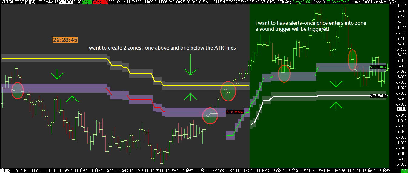

http://www.sierrachart.com/image.php?Image=1618752260748.png see attached screenshot can explain better what I like to do I like to create zones (shaded area in the chart pointed by green arrows) above and below the ATR lines, then set sound alerts, so that once prices reach these zones (eg at the red circles), a sound alert will be triggered, so that I will be alerted to look at price action pls advise how I can achieve this? thanks so much |
| [2021-04-19 03:34:52] |
| Sawtooth - Posts: 4361 |
Use the Bands/Envelope study: - Set the Based On to the study for the ATR lines. - Set the Input Value to its subgraph - Set the Draw Styles to the Transparent Top/Transparent Bottom pair. For alerts, use a formula like this on the Alerts tab of any study: =OR(AND(H[-1]<ID5.SG2[-1],H>ID5.SG2),AND(L[-1]>ID5.SG1[-1],L<ID5.SG2)) where the Bands/Envelope study is ID5. If you want to also color the bars at the alerts, put the formula on the Alerts tab of an instance of the Color Bar Based On Alert Condition study. |

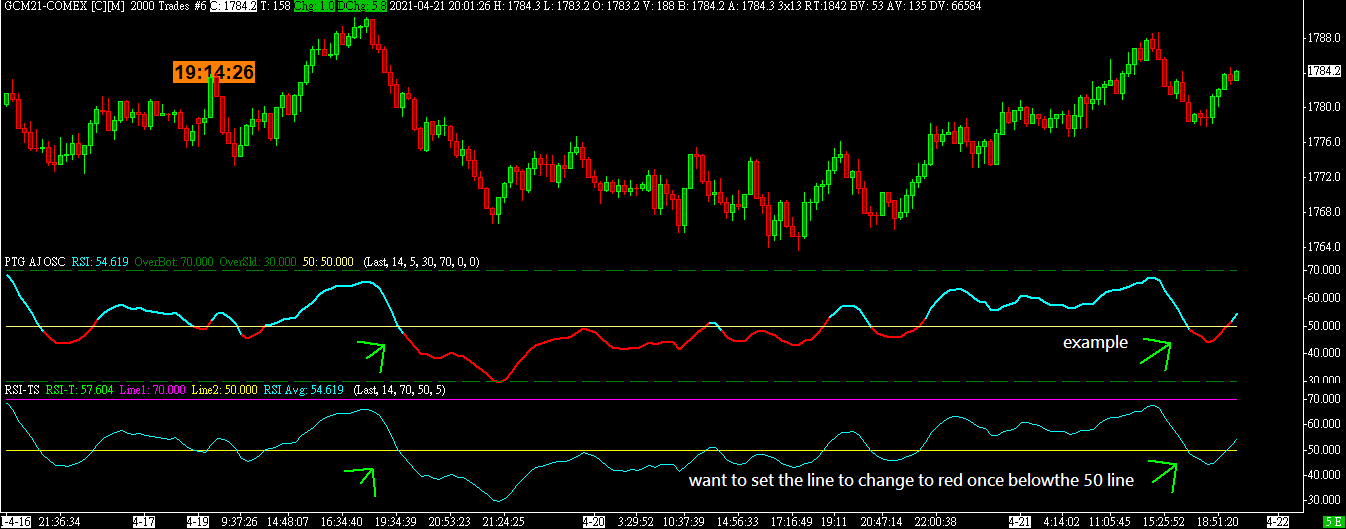

http://www.sierrachart.com/image.php?Image=1619006487995.png I like to set the line of RSI-TS study to be red once below the 50 line. See chart example. I tried the auto colour (subgraphs) however it is based on +/- of a zero line. Whereas I like to set it based on the 50 line. Pls advise me how can set this auto colour based on the 50 line instead? Thanks so much for your help. |
| [2021-04-21 14:21:39] |
| John - SC Support - Posts: 48568 |
You would need to use the Color Bar Based on Alert Condition study. Refer to the following: Color Bar Based on Alert Condition For the most reliable, advanced, and zero cost futures order routing, use the Teton service: Sierra Chart Teton Futures Order Routing |
