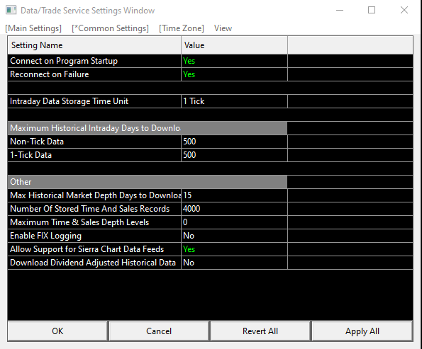

I've enabled the Denali data feed and followed the instructions to set up real time data feed for the EUREX Dax futures market. However I'm not getting any real time data coming through. It appears to only be historic data. There is no [M] next to the symbol as well. I was previously using IQFeed before switching over to SC Data - All Services. The symbol when using IQFeed for the Dax market is XG# whereas when using SC Data - All Services feed the symbol is FDAXH21-EUREX. Unfortunately when selecting translate symbol to current service it doesn't work. I have to manually change the symbol. In any case even once manually changed it still doesn't work.
I've tried following the Sierra Chart Software Instructions section but it still doesn't work - Denali Exchange Data Feed: *Setup Instructions: CME/CBOT/NYMEX/COMEX Exchanges*
Attached is a screenshot.

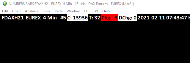

User98716 - Posts: 10
I see the EUREX data feed is released again on the Denali Exchange data feed as indicated on the thread New Upcoming EUREX Full Order Book Data Feed (Now Available!)
I've got the pre-release version 2227, Denali Exchange data feed active and SC Data - All Services selected.
I'm not receiving any real time data, it's stuck on historical data. I don't have the [M] next to the symbol to indicate real time data. Screenshot attached.
imageScreenshot 2021-02-11 075051.png / V - Attached On 2021-02-11 07:54:50 UTC - Size: 12.12 KB - 442 views

[2021-02-11 10:56:57]
User120666 - Posts: 54
Currant time is 10.57am, last 1 minute bar is 10.54am...

Above is my message log for the issues I'm having. I've been subscribed to the Denali Exchange Data Feed since yesterday and signed the correct documents to receive realtime data.
[2021-02-11 23:06:01]
We are still working on this, but you can activate the EUREX exchange here at no cost:
https://www.sierrachart.com/UserControlPanel.php?page=ServicesActivation#DenaliEUREX
That will ensure you get access.
You do need to complete the related documents first though.
[2021-02-12 09:00:42]
Is this something I'll need to do once you have everything fixed properly, or do you just mean in the meantime while you fix it?
[2021-02-12 09:04:03]
By the end of next week you will need to enable the EUREX exchange. So yes you will eventually have to do that anyway.
