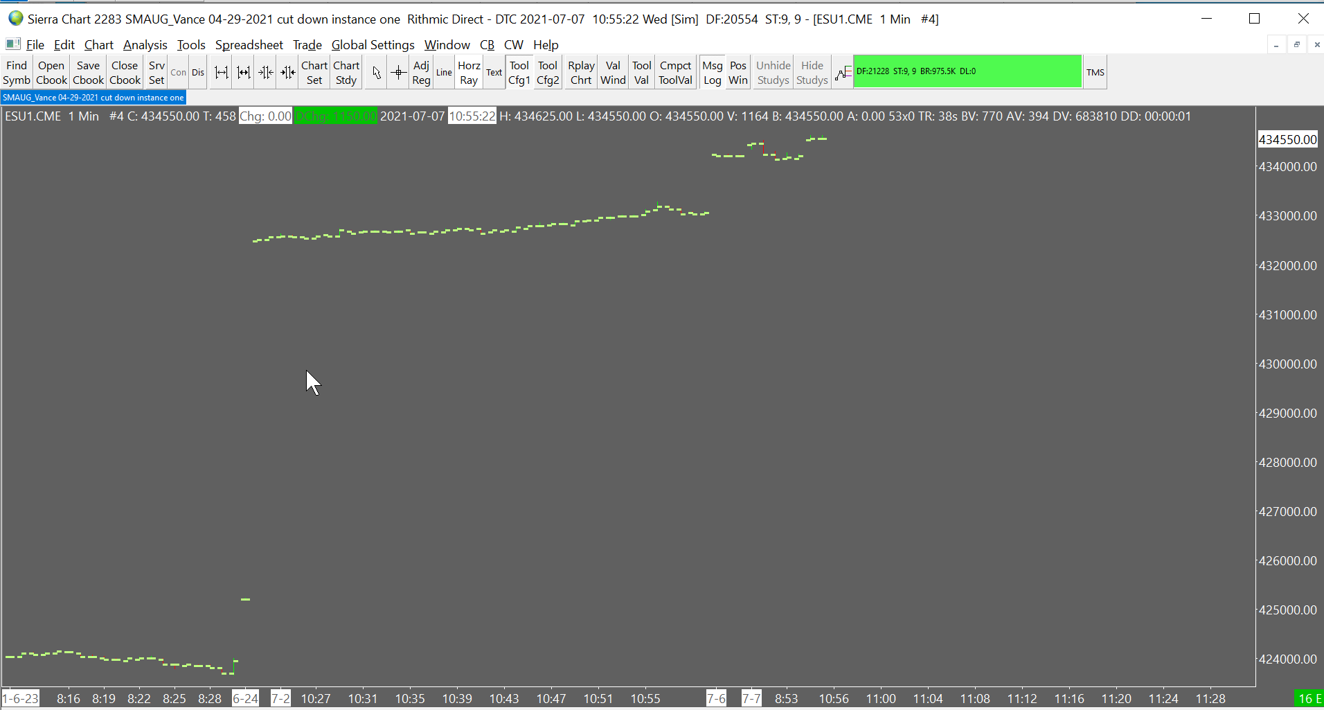

Technical - Posts: 158
I uploaded the log. This is what a default ESU1.CME chart looks like.
imageESU1.CME.png / V - Attached On 2021-07-07 15:58:16 UTC - Size: 55.89 KB - 364 views
[2021-07-07 17:28:53]
John - SC Support - Posts: 48548
Your log has us confused. It is showing that you started using the old Rithmic connection using the Bridge process, and that it had trouble running. But later it is showing that it is using the DTC connection, but we did not see a disconnect and reconnect, so something appears to be missing.

[2021-07-07 18:24:29]
I sent the log for review.
[2021-07-07 18:59:16]
The log looks fine, no errors or specific issues in it.

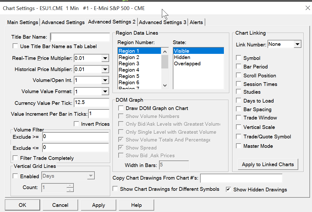

Also, we forgot to mention to check your Chart >> Chart Settings >> Advanced Settings 2 >> Real-Time Price Multiplier and Historical Price Multiplier are set to. They should be 0.01 in order to get the correct price display on your chart. It looks like they are currently set to 1.0 for the chart you showed in the image above.
[2021-07-07 19:54:27]
Please check enclosures.
I have always connected to DTC before testing, the bridge is not running.
I have never changed price multiplier.
imageChart settings 07-07-2021.png / V - Attached On 2021-07-07 19:52:40 UTC - Size: 63.66 KB - 296 views
imageDT Service 07-07-2021.png / V - Attached On 2021-07-07 19:52:45 UTC - Size: 17.84 KB - 318 views

The last log file you sent was definitely set to Rithmic Trading at first, but we do see that it changed to Rithmic Direct - DTC after the initial startup.
Please try connecting to one of the live trading servers and see if that clears things up. We do not see a server listed in the log file, although it is showing that it is connecting.
Also, try deleting and redownloading the data once you have the connection.
