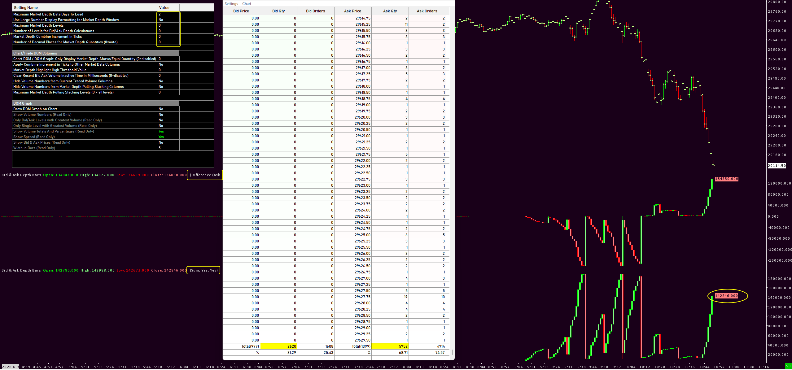

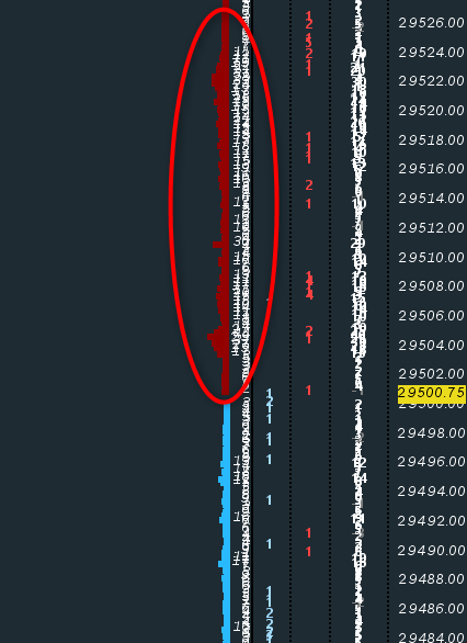

Yesterday and today, I and several people I trade with have been having problems with depth data on NQ with Denali data feed. There are two main problems:
1) There are orders showing up at certain places on the DOM that don't appear to be real (they are not showing up on one of our trader's CQG data feeds
2) The bid & ask depth bars do not add up to the totals shown in the market depth window
I do not have the log from yesterday, but you can see a screenshot of the issue (20260609_1.png).
Today, I was initially connected to these servers, per the message log:
2026-06-10 09:14:21.234 | Denali Data Feed | Connecting to the server ds28.sierracharts.com. Port 10048
2026-06-10 09:15:49.729 | SC Data with Depth | Connecting to the server ds12.sierracharts.com. Port 443
See the attached screenshot with the depth issue (20260610_1.png)

When the number of Market Depth levels is at the Sierra Chart limit of 1400, then the Bid and Ask Depth bars have problems with some of the calculations. If you set the following to be 1399, then this should resolve it:
Chart Settings: Number of Levels for Bid/Ask Depth Calculations (Chart >> Chart Settings >> Market Depth menu)

zippyzip - Posts: 310

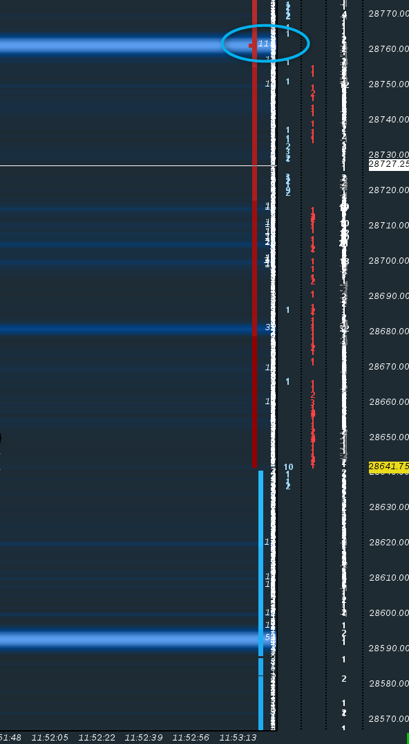

major issue with depth and dom on denali there are multiplies of orders adding up on dom that are not there , example this 110 lot or that group of orders i circled is not there on any other data like cqg or rithmic and this has been happening since yesterday at multiple prices on dom with orders adding to each other , post 436098 was similar issue that was addressed by you guys . please advise as this is unacceptable
image2026-06-10_11h51_52.png / V - Attached On 2026-06-10 15:54:43 UTC - Size: 73.02 KB - 157 views

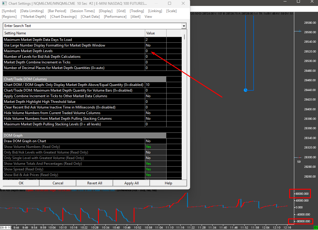

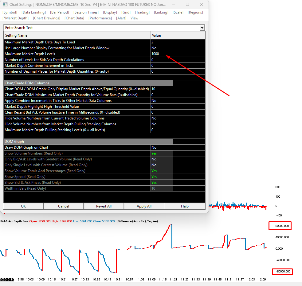

GPM2000 - Posts: 22
Hi John,
I have the number of levels set to 1000 on one chart and 0 on the second chart included. This is still showing incorrectly on the depth. The first chart was previously at 1399 with the same issue (to avoid the 1400 issue).
The total on the depth is swinging between 80,000 and -80,000.
I do not believe this is a calculation issue on the chart. It looks more like a data issue.

GPM2000:
Please try setting the number of levels in "Chart >> Chart Settings >> Market Depth >> Number of Levels for Bid/Ask Depth Calculations" to a value of 1200 or 1300 and let us know if you still have this issue.

Here are a few screenshots of a heatmap of the order book using Denali data. In the first screenshot, there is an offer at 28785 that appears above when price is below this level. Then there is a bid which appears below price at 28761 when price is above this level. As you can see in the middle of the screenshots, as soon as price passes through these levels, the order disappears, then reappears. These snapshots were at 11:45 and 11:56 ET.
The last screenshot is of the same "ghost" order from another chart just for confirmation.

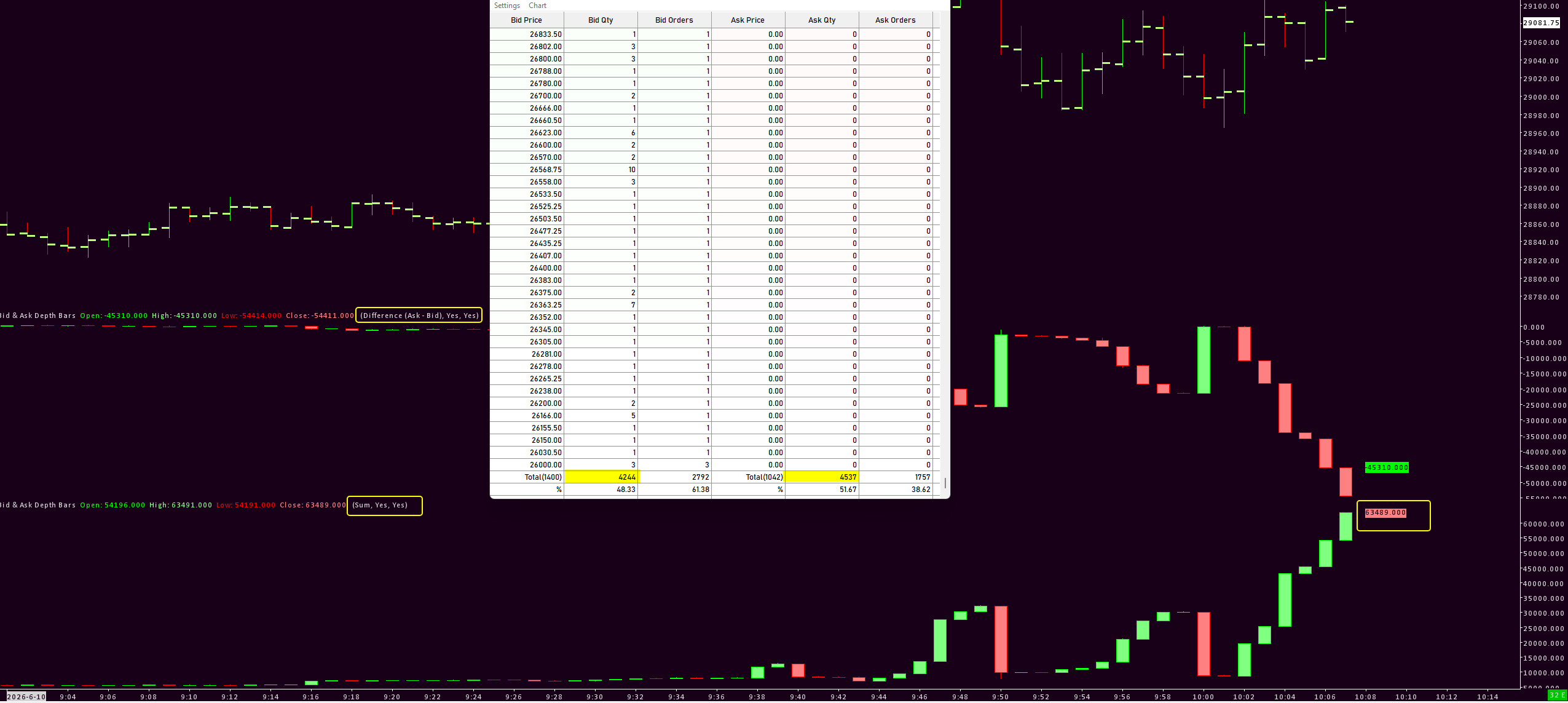

GPM2000 - Posts: 22

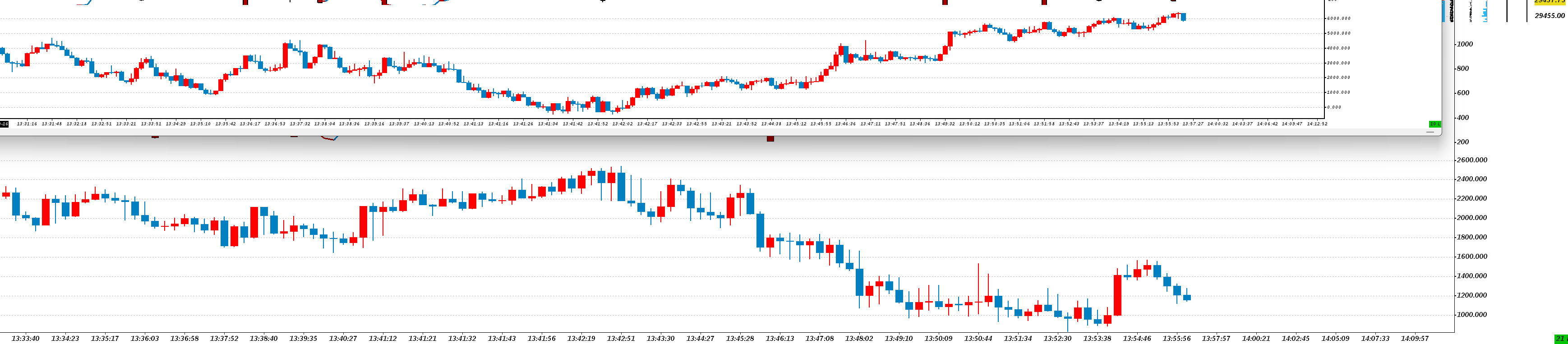

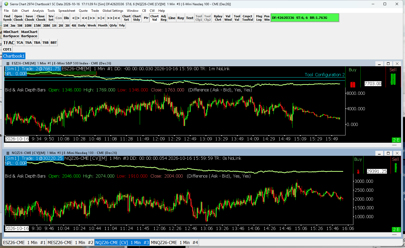

Hi, have you noticed any issues with NQ depth today?
It appears to be the inverse of the ES depth.
Included a screenshot; the top chart is the Bid Ask Depth bars on ES, bottom is the same for NQ. Same settings.
Thanks!
imageTopESBottomNQ.png / V - Attached On 2026-10-16 17:58:29 UTC - Size: 88.03 KB - 30 views

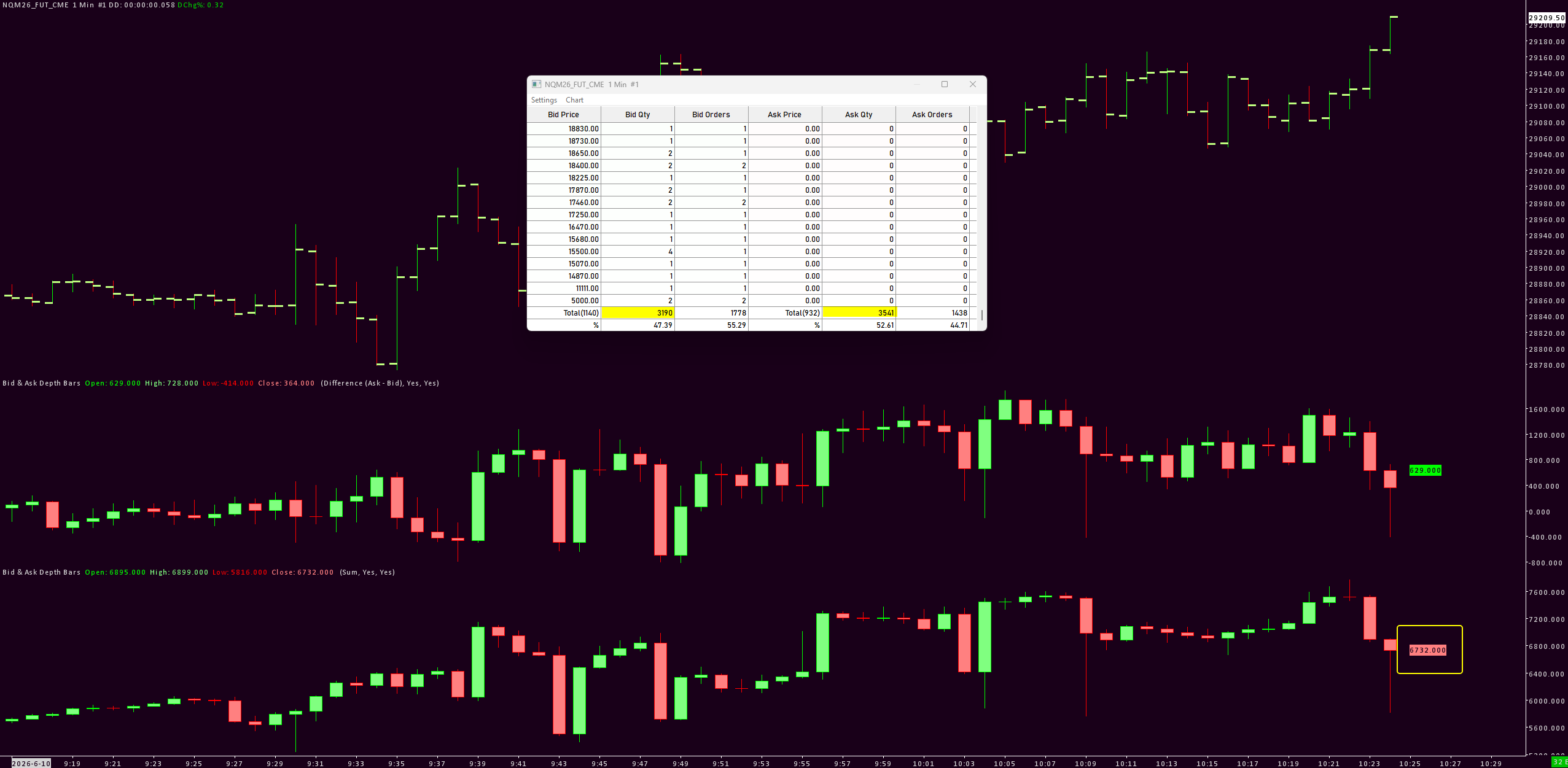

John - SC Support - Posts: 48326

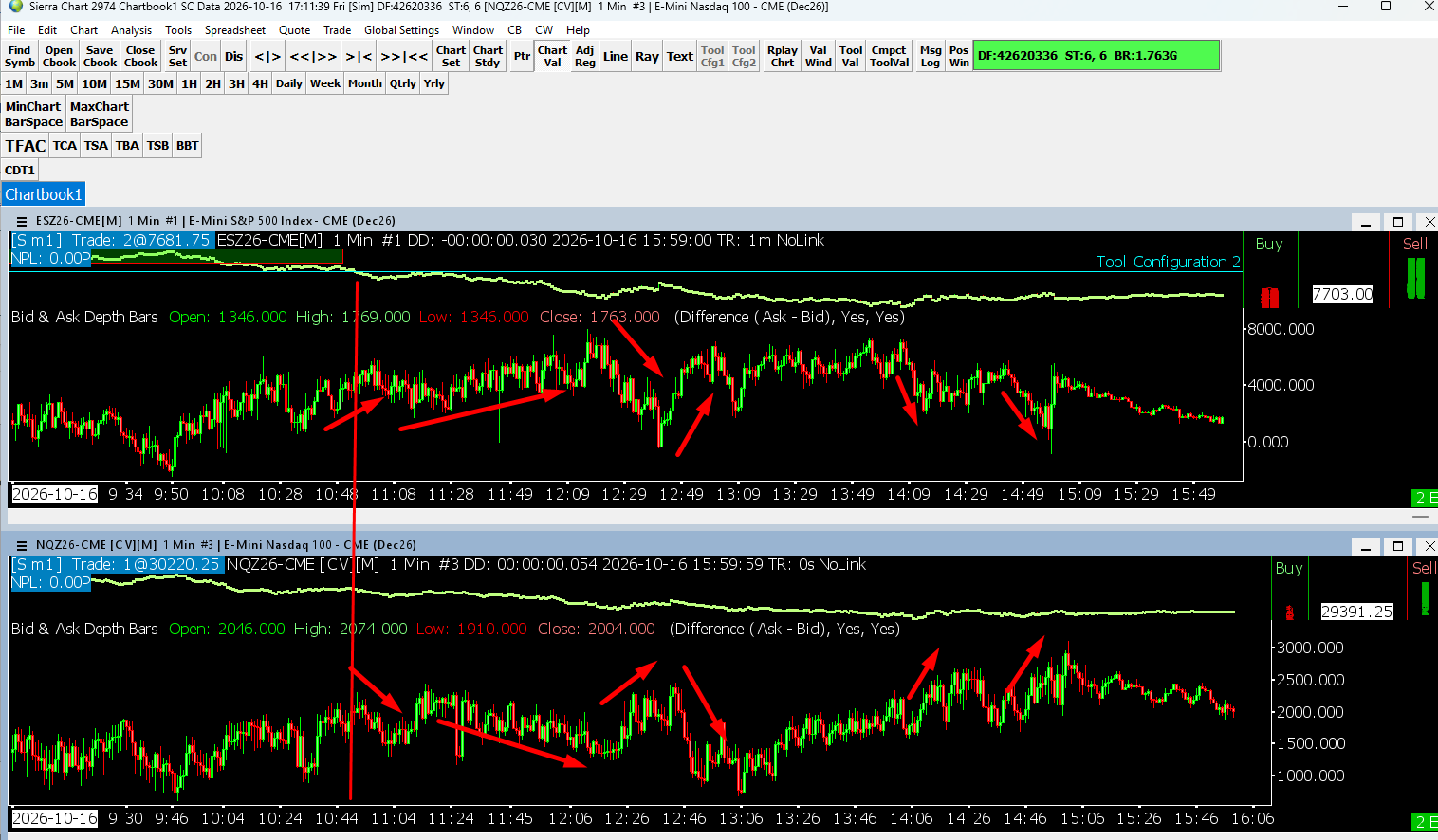

Attached is what we see for 1 minute charts for the Bid/Ask Depth Bars set to "Difference (Ask - Bid)". The top is ES and the bottom is NQ.
Note that we have "Chart >> Chart Settings >> Market Depth >> Number of Levels for Bid/Ask Calculations" set to 1399 to ensure that there is not an issue with going over the 1400 limit as noted previously in this thread.

GPM2000 - Posts: 22
Hi John,

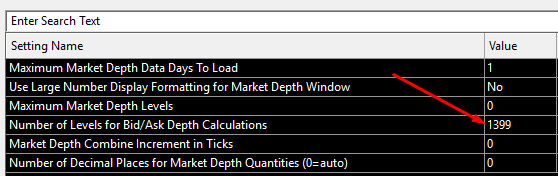

The Number of Levels for Bid/Ask Calculations is set to 1399 for both charts, per the thread. I've attached the Chart Settings to show this.
The NQ chart is 250 tick and the ES chart is 500 tick, but I matched up the time on the x-axis. Your chart illustrates the issue better.
It is extremely uncommon to have the depth move in opposite directions on two very correlated instruments, as marked up in your screenshot.
The day seemed to start normally, then something happened to the NQ depth.
- I've highlighted in your screenshot where things started appearing incorrect and the NQ depth becoming decorrelated.
- In the highlighted periods, both NQ and ES would be moving up; ES depth would be increasingly bid as expected (depth moving down on the Ask - Bid chart), whereas NQ would be increasingly offered (depth moving up on the Ask - Bid). And vice versa.
Thanks for reviewing!
