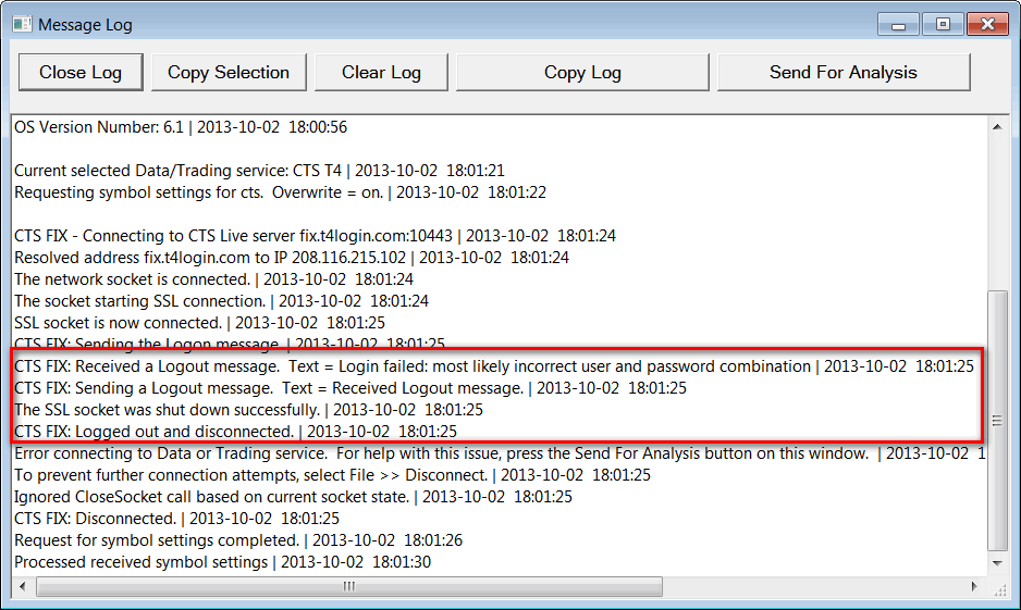

If you are unable to make a connection to the Data/Trade server, the Sierra Chart Message Log will display a message indicating this error and the reason. To open the Message Log if it is not already visible, select Window >> Message Log . Refer to the image below of an example of the type of message you will see relating to an error connecting to the Data/Trade server.
Depending upon the Data or Trading service you are using, the connection error reason may or may not be very descriptive.
If you have the Reconnect on Failure option enabled in the Global Settings >> Data/Trade Service Settings window, Sierra Chart will try to reconnect to the Data/Trade server if it was unable to.
To manually retry connecting to the Data/Trade server at any time, select File >> Connect to Data Feed on the menu. You can also stop connection attempts by selecting File >> Disconnect on the menu.

If you have followed all of the Setup Instructions to connect to the Data or Trading service you are using and Sierra Chart continues to report in the Window >> Message Log it cannot connect, it cannot Logon, there is a connection error, or there is a Timeout connecting to the Data or Trading server, then this can be caused by one of the reasons explained in the list below.
In addition to other error and connection related messages, you will see this common message in the Message Log which indicates a problem connecting: Error connecting to Data or Trading service.
