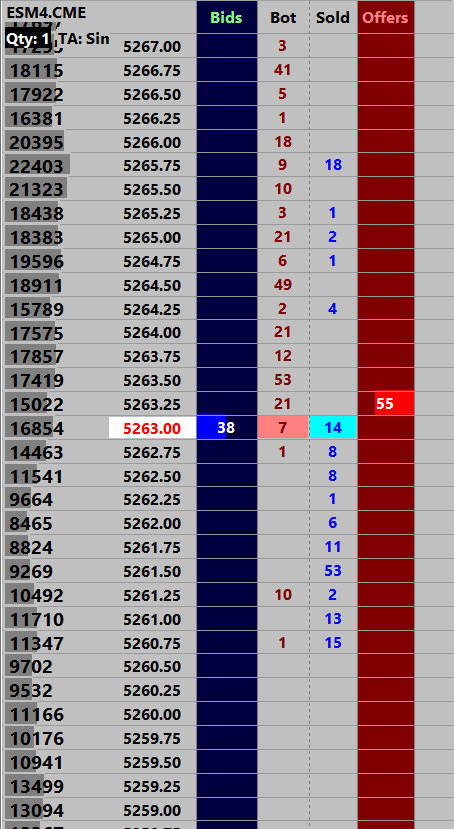

hello, Ive got the service package 12 and im setting up an apex funded acc to trade with sierra
is it possible to see full market depth with the denali as currently when i log into apex via rithmic in sierra the DOM only shows limit orders 1 tick above and below price.
thank you
imageScreenshot 2024-05-30 194902.png / V - Attached On 2024-05-30 18:49:29 UTC - Size: 62.21 KB - 331 views
[2024-05-30 19:33:39]
John - SC Support - Posts: 48659
If you use our Denali Exchange Data Feed for your data, then you can view the Market Depth data with up to 1400 levels. Since you are also on Package 12, you can view the Market by Order data, refer to the following:
Market By Order Data
Right now, you are getting your data from Rithmic.
You just have to make sure that you activate an exchange option that includes the "Market Depth" data.
Also, keep in mind that in order to get the real-time data for the CME Group, you need to have a live, funded, futures trading account. And you need to be able to connect your Sierra Chart software to that account at least once a month for verification. Refer to the following:
Real-Time Exchange Data Feeds Available From Sierra Chart: Understanding and Accessing Data From the CME, CBOT, NYMEX, COMEX Exchanges
If you do not have an account that meets the above requirements, then we recommend the solution outlined at the following link:
Easy Solution to CME Funded Trading Account Requirement
Once you have the above worked out, then you can setup the real-time data for the CME Group by following these instructions:
