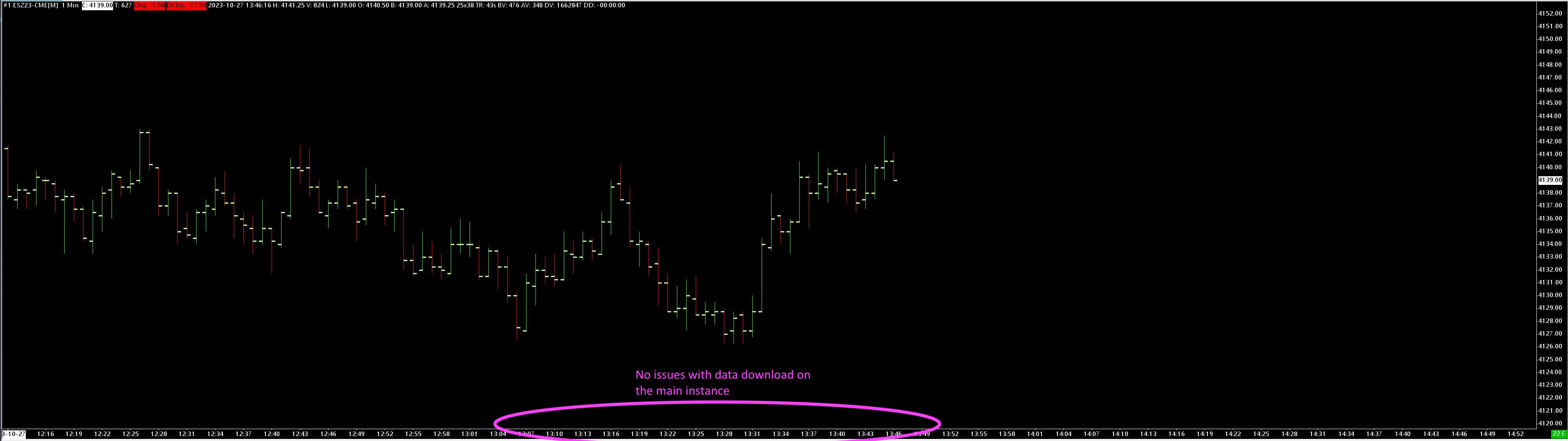

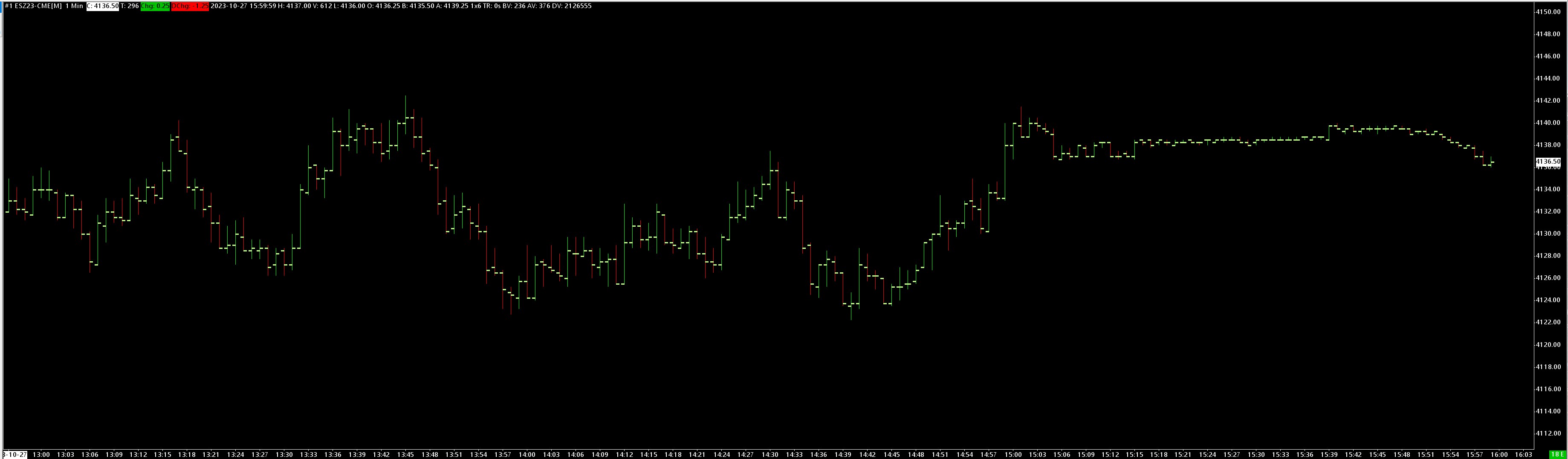

i have created two new chart-books one in main instance and another in sub-instance.
Both of these chart-books have same symbol which is ESZ23-CME.
downloaded the data when i opened these charts in these two chart-books.
Saved and closed both these chart-books (in main instance and sub instance)
Then closed the Sierra chart completely and turned-off the PC.
After 15mins logged back into both Main instance and sub-instance
opened both chart-books in respective instances.
The chart in main-instance downloads the data that was missing for 15mins.
but the chart in sub-instance DOES NOT download the data that was missing for 15mins.
Please see the screenshots attached.
This issue is making sub-instances un-usable at all.

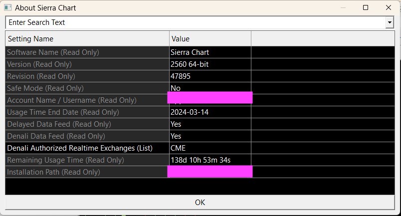

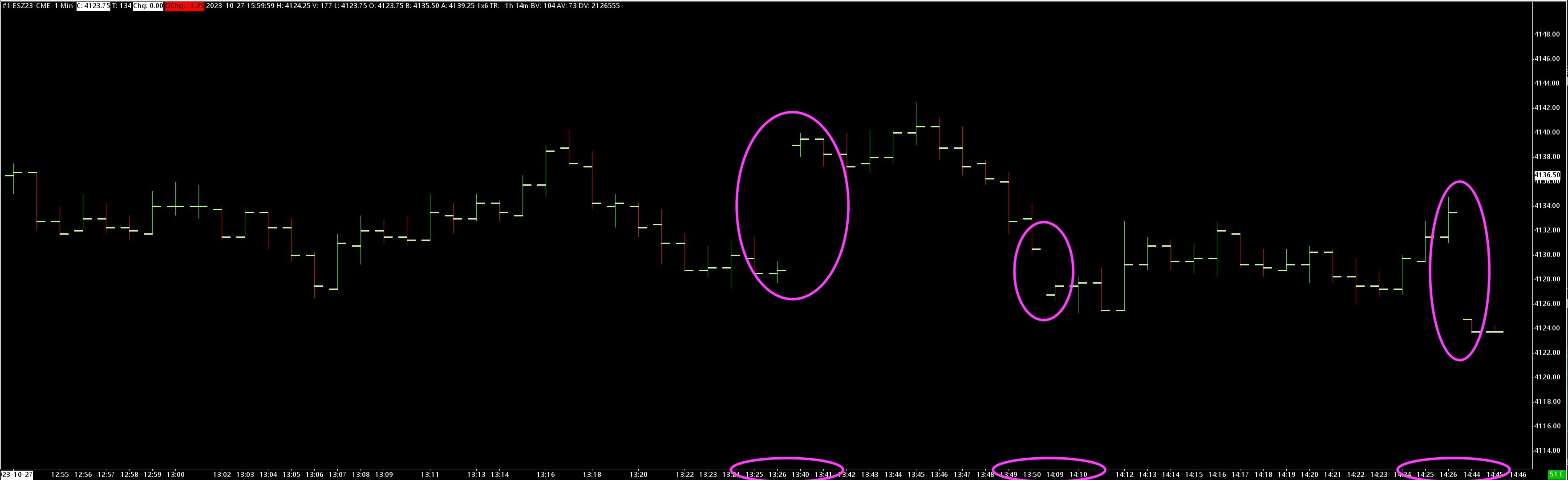

[2023-10-28 13:13:47]
User121314 - Posts: 18
Looks like the upgrade did not fix the issue
please see the screenshots attached to this message.
Thank you
imageSC Version window.jpg / V - Attached On 2023-10-28 13:11:56 UTC - Size: 77.86 KB - 245 views
imagemain-instance- After upgrade to 2560.jpg / V - Attached On 2023-10-28 13:12:01 UTC - Size: 228.48 KB - 204 views
imagesub-instance-3- After upgrade to 2560.jpg / V - Attached On 2023-10-28 13:12:06 UTC - Size: 224.63 KB - 305 views

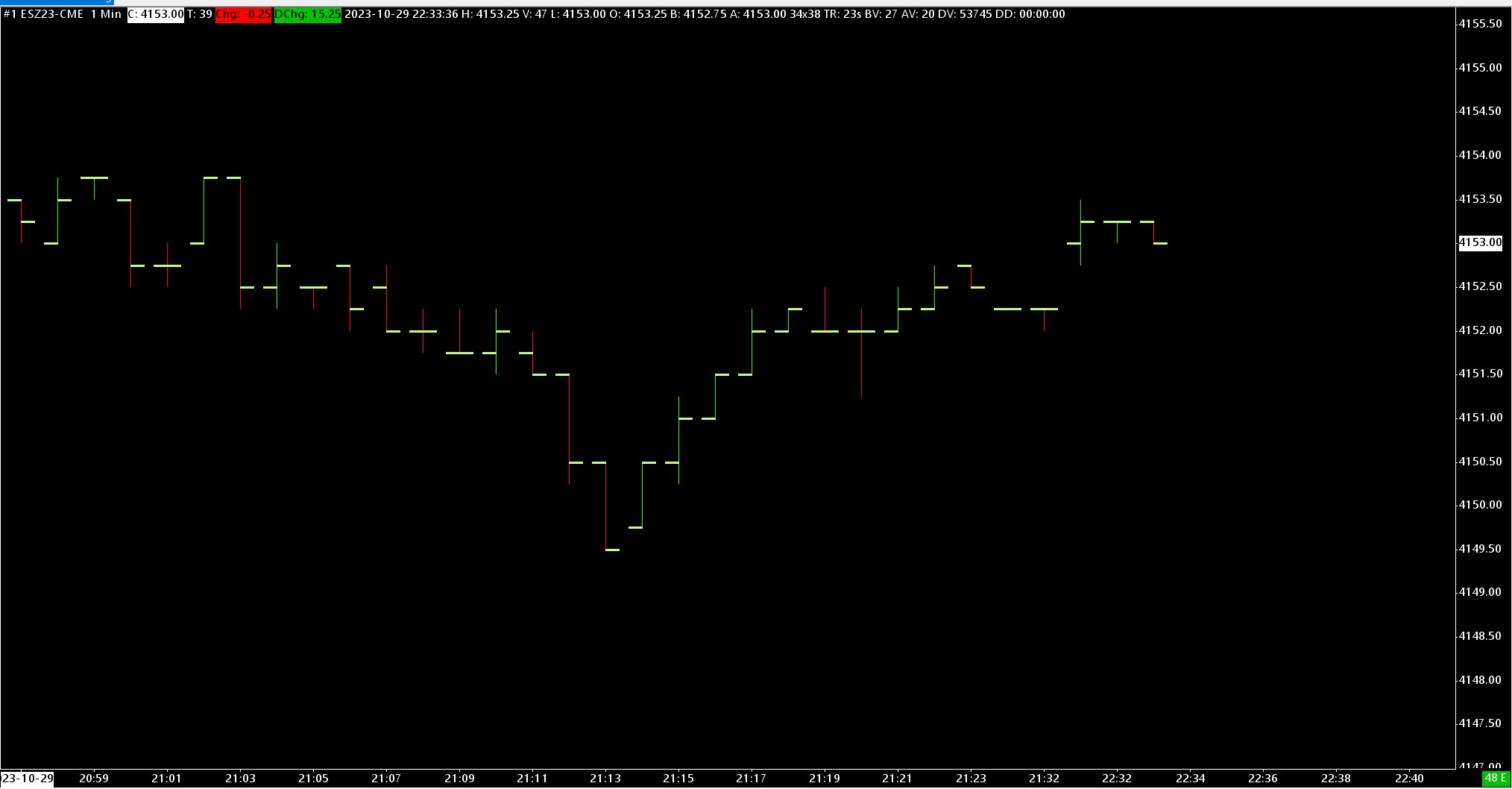

I have moved the SC to C:\ directory still see the same issue, even after following the instructions you mentioned above.
Attached the screenshot as well for your reference.

imagesub-instance-3- After symbol settings changes.jpg / V - Attached On 2023-10-30 02:12:22 UTC - Size: 152.17 KB - 274 views

i still see same issue with sub-instances. when i do a "Edit>> Delete all data and download", i see no response with a blue ribbon saying "downloading historical data. bars may not appear until done"
The one with the blue ribbon is from main-instance and the one without is from sub-instance.
for sub-instance you will see a data gap 21.32 to 22.32 as well.
