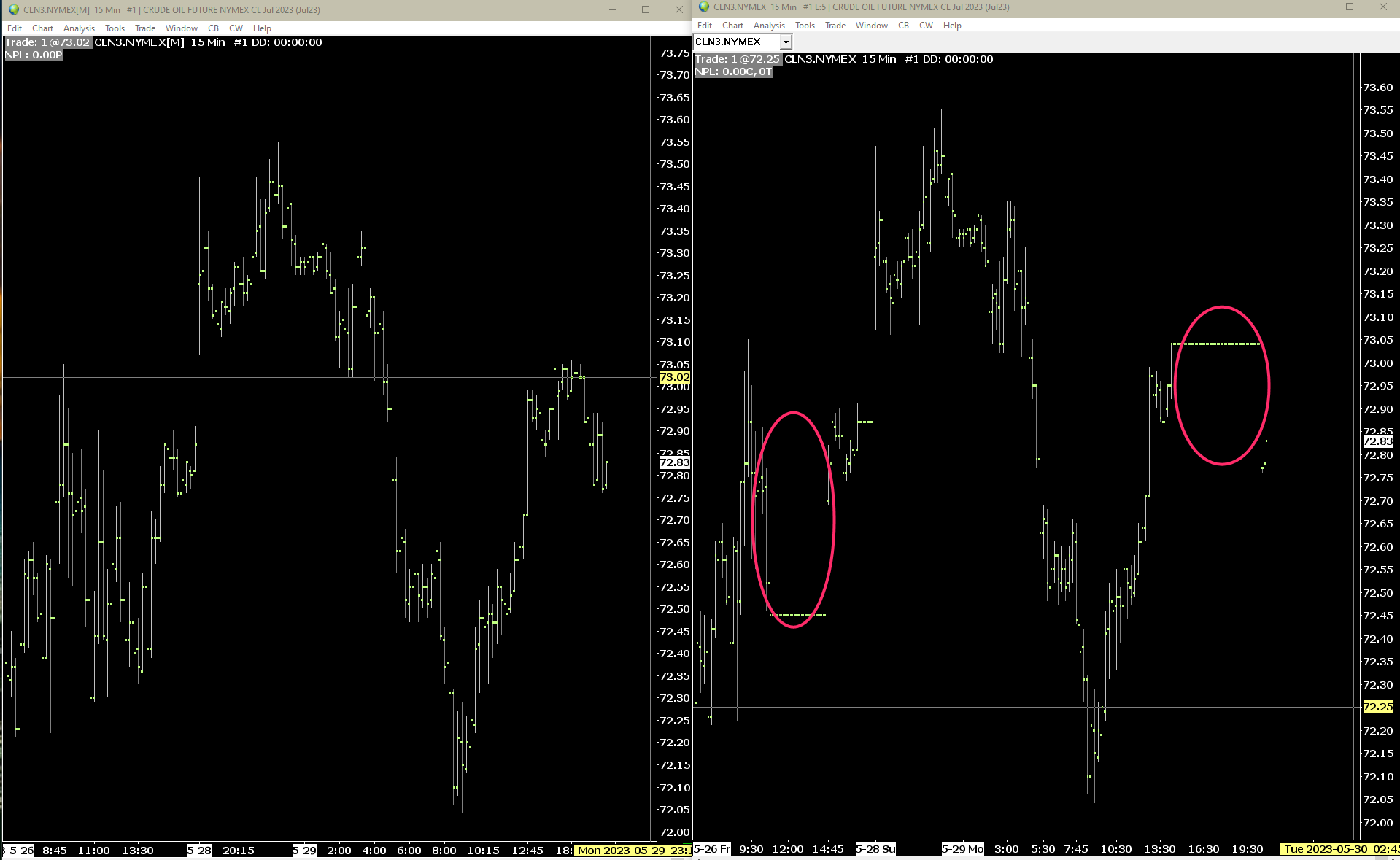

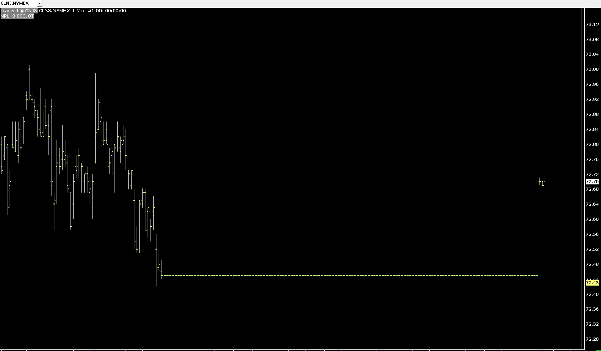

User624595 - Posts: 267
Issue occurs on all charts, on all symbols, in all sub instances. Only opened one chart/symbol to keep it simple.
Attached image of chart to illustrate missing data gap on initial reconnection, and image again after leaving open and connected.
Backfill data never filled in. Let log run for over 2 hours.
Private File
image2023-05-26_14h52_39_CL_Startup.png / V - Attached On 2023-05-26 21:29:34 UTC - Size: 44.62 KB - 306 views
image2023-05-26_17h27_01_CL_Running.png / V - Attached On 2023-05-26 21:29:40 UTC - Size: 64.41 KB - 243 views

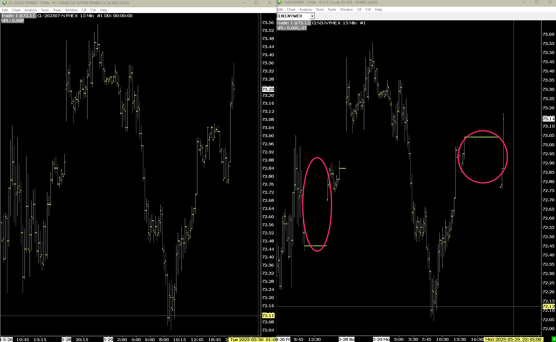

[2023-05-30 01:47:52]
This issue is not occurring on the IB/Denali install, which was copied over to create this Rithmic/Denali install recently, both SC v2504. IB/Denali subinstance on left, Rithmic/Denali subinstance on right.
Date Time Of Last Edit: 2023-05-30 06:20:39
image2023-05-29_21h44_37_IB LEFT_RITHMIC_RIGHT.png / V - Attached On 2023-05-30 01:47:14 UTC - Size: 146.73 KB - 221 views
