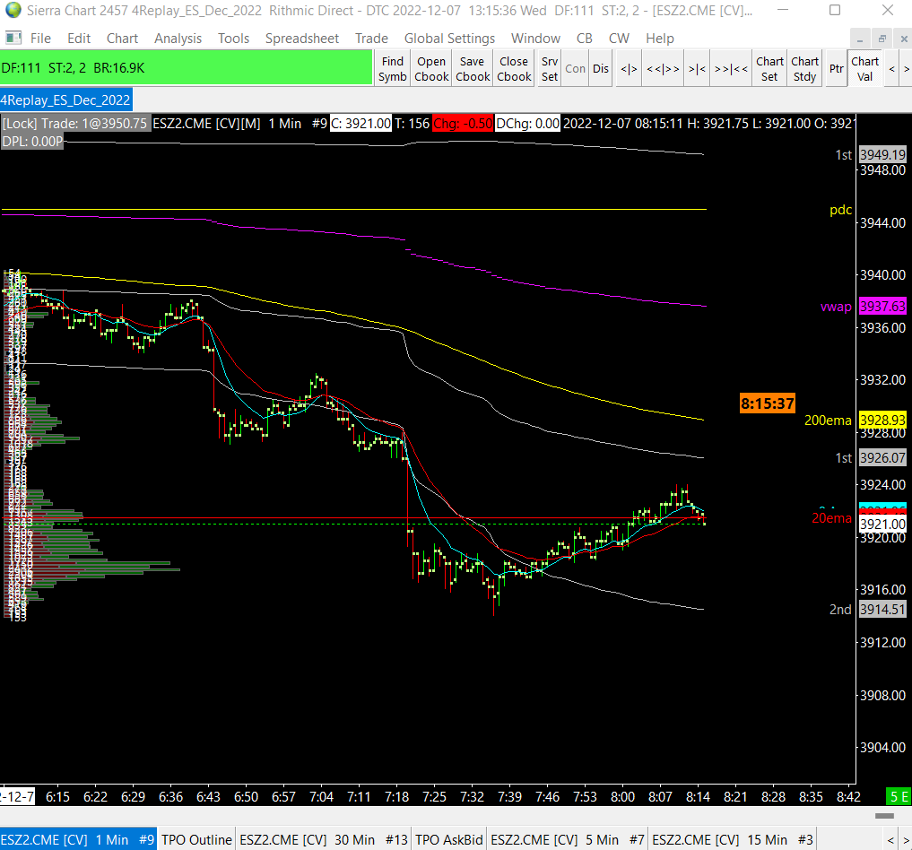

The platform will show connected but the price won't move or change. Every time I close it and open again, the price will show a change.
[2022-12-06 19:28:19]
Is this for all symbols or just for some? What is one symbol for which you are having this issue?
Keep in mind, you are only setup to get real-time data from the CME exchange (not the full CME Group, just the CME Exchange).
[2022-12-07 13:19:01]
L2Ltrades - Posts: 65
This is for ES, MES symbols. Please see the attached image. The platform shows that it is connected, but the price will not update. You can see the price vs the time on the real time clock. The price will update if I close the charts and reopen it. It will show the most recent price and just stay there. Same on the DPM as well. I uninstalled and reinstalled the software as well. It worked for about 10 mins and same thing occurred again.
imageScreenshot 2022-12-07 081546.png / V - Attached On 2022-12-07 13:17:45 UTC - Size: 86.64 KB - 271 views

Open a chart for the symbol you have an issue with.
Date Time Of Last Edit: 2022-12-07 14:24:59
[2022-12-07 14:40:54]
Here you go. It keeps saying feed has been disconnected and will attempt to reconnect in 30 seconds. I have not changed anything. This started yesterday.
Software version: 2457 64-bit | 2022-12-07 14:36:52.656

[2022-12-07 15:03:20]
Also just a follow up information. I rebooted the system, the issue persists at my home, work or any other place. The firewall does not seem like an issue since it has been almost a year and nothing has changed for it to suddenly stop the connection. Hopefully this helps. I have uninstalled and installed the software couple of time since last night.
