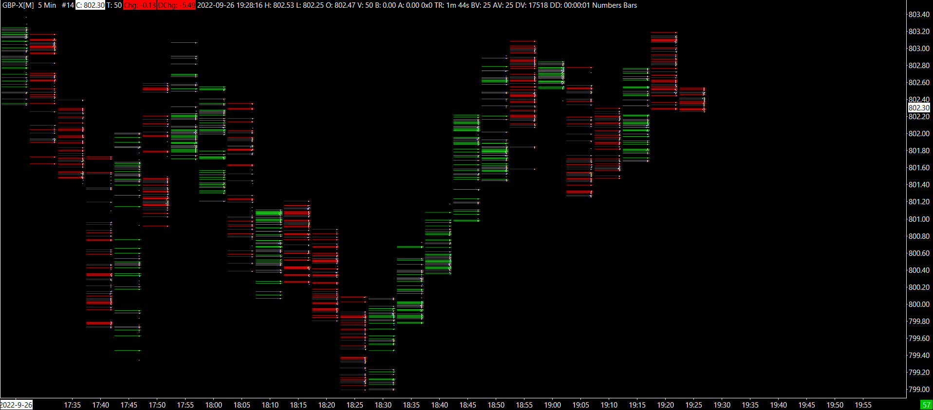

Hello i have a display error when i click study numbers bar i just get a weird image. I just want a normal Footprint Chart with cumulative Delta and imbalances. when i click study numbers bar i get this view https://www.sierrachart.com/image.php?Image=1664220496238.png
Im on Demo , can someone help?
[2022-09-26 21:30:04]
It is not an error, it is just the nature of the data for the index. It is not the best instrument to start working with Numbers Bars (the CME Group ES instrument is a widely traded instrument that will show the Numbers Bars well).
But, in general it's a matter of scaling to fix what you are looking at. Refer to the information here:
Numbers Bars: Scaling a Numbers Bars Chart

it still looks like a complete mess. How can i make it better? Also how can i drag with my mouse ? i can only zoom when i drag on the scale right or down .And i have to completly zoom into 1 candle to read anything
https://www.sierrachart.com/image.php?Image=1664302001528.png
[2022-09-27 21:16:08]
You can use the Hand tool to move the chart up/down/left/right. You just need to enable the following option to get the up/down functioning with it:
Chart Drawing Tools: Support Vertical Scaling/Movement With Hand Tool (Global Settings >> Tool Settings >> General >> Tool Options)
Also refer to the following for how to adjust the scales to either move up/down or increase/decrease spacing:
Chart Scale and Scale Adjusting: Interactive Scaling
And then refer to how to increase/decrease bar spacing (changing the horizontal scale) at the following:
Working With Charts: Changing Bar Spacing
And finally refer to the following for options for the Scroll Wheel on a mouse:
General Settings Window: Scroll Wheel (Global Settings >> General Settings >> GUI >> Scroll)
[2022-09-28 10:35:08]
